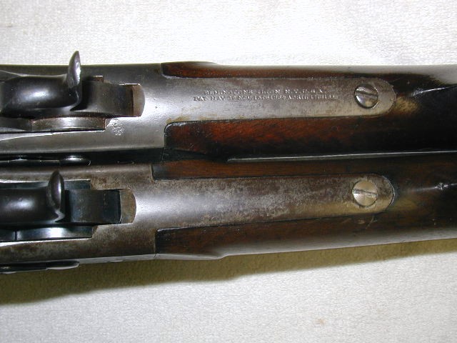

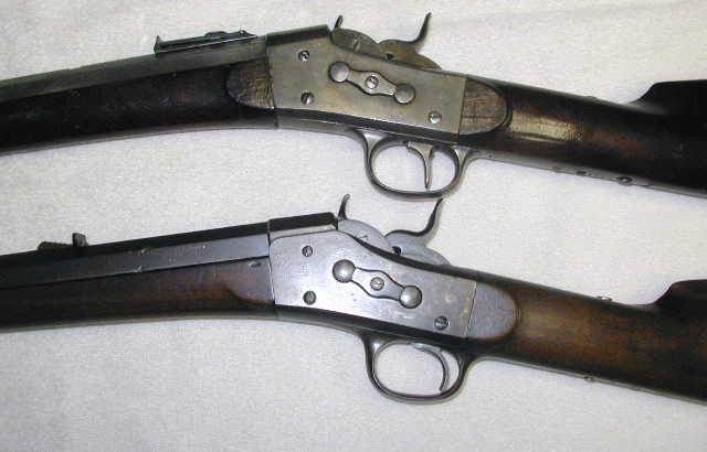

I believe that your gun may be a Remington No.1 Sporting Model rolling block rifle.
The top rifle is a No.1 Sporting Rifle, serial# 1299 in 44 rimfire
The bottom rifle serial# is in the 12000 range and is 32 rimfire
Are the patent dates on your rifle in the same location as the top rifle.
Let me know if your rifle looks like one of the above rifles.

Yes Sir looks like the top rifle.
PAT# is on the top of the plate like your first view and has the same trigger.
Bottom plate has the SN stamped in it and appears that the boy doin the stampn was a little off his mark that day. But you that when you do it by hand. The other SN is under the fore stock on the barrel.

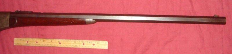

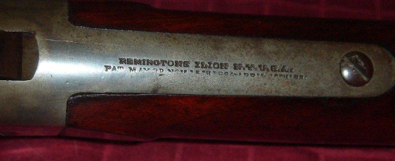

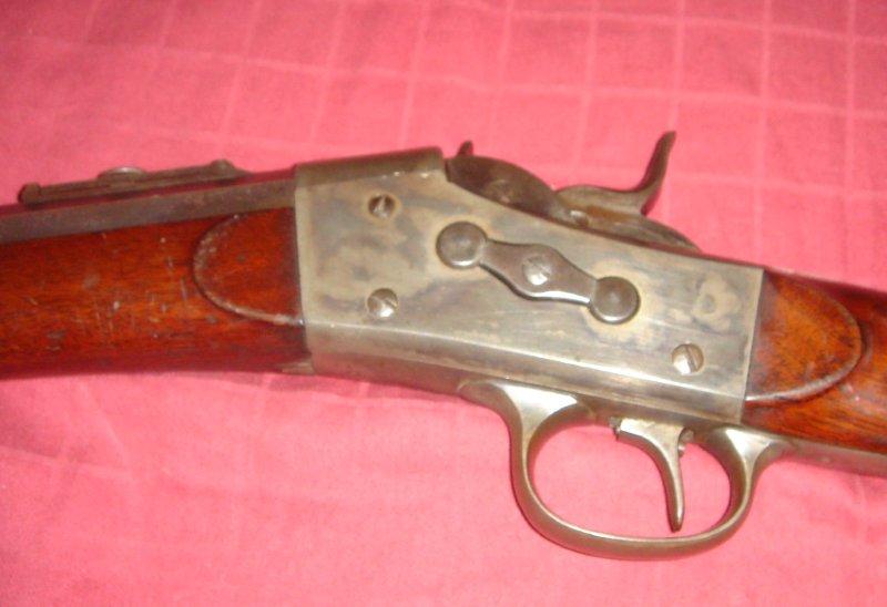

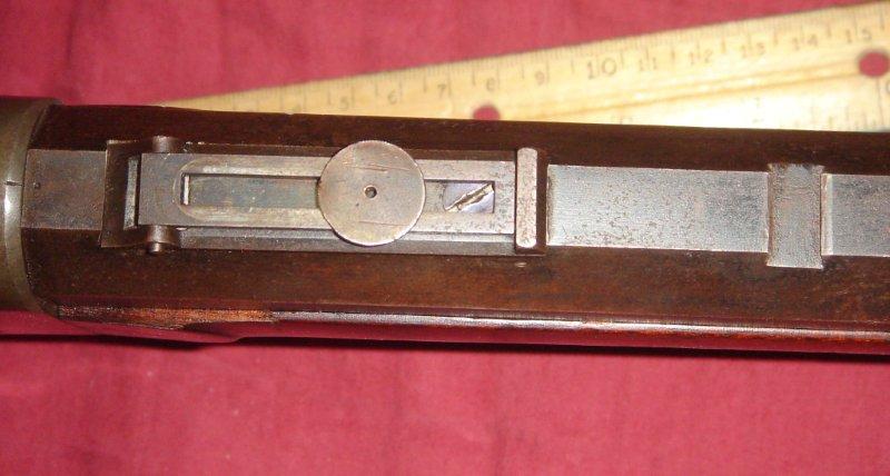

exfirefighter1
Re: Rem RB Question
Round Top;
Here are the photos.
- DSC00043-Copy.JPG (35.77 KiB) Viewed 5047 times
- DSC00031-Copy.JPG (18.91 KiB) Viewed 5047 times
- DSC00051-Copy.JPG (49.77 KiB) Viewed 5047 times
exfirefighter1
roundtop
Re: Rem RB Question
Thanks for showing us the pictures. Your rifle is in great condition. Congratulations. Ed
