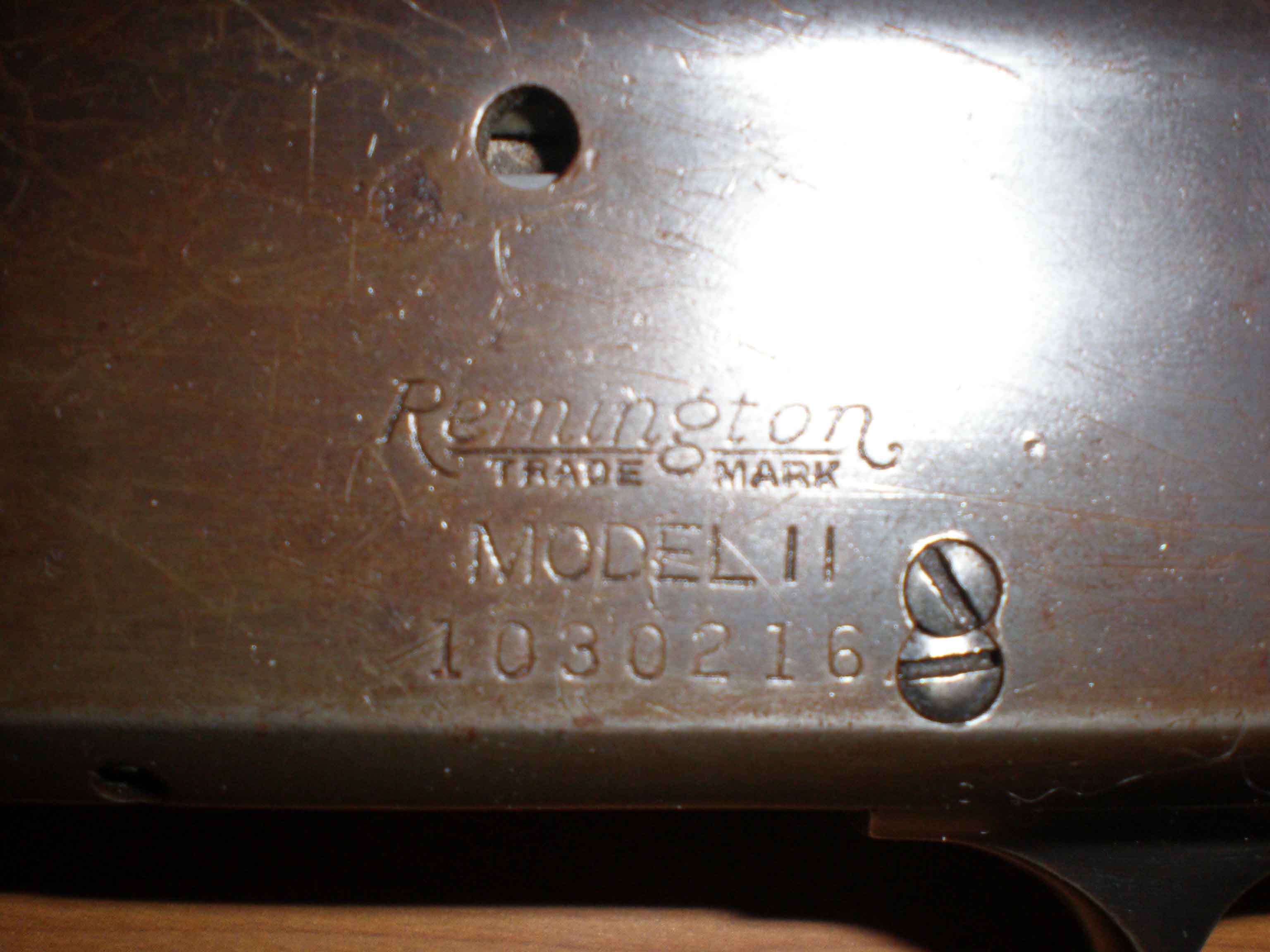

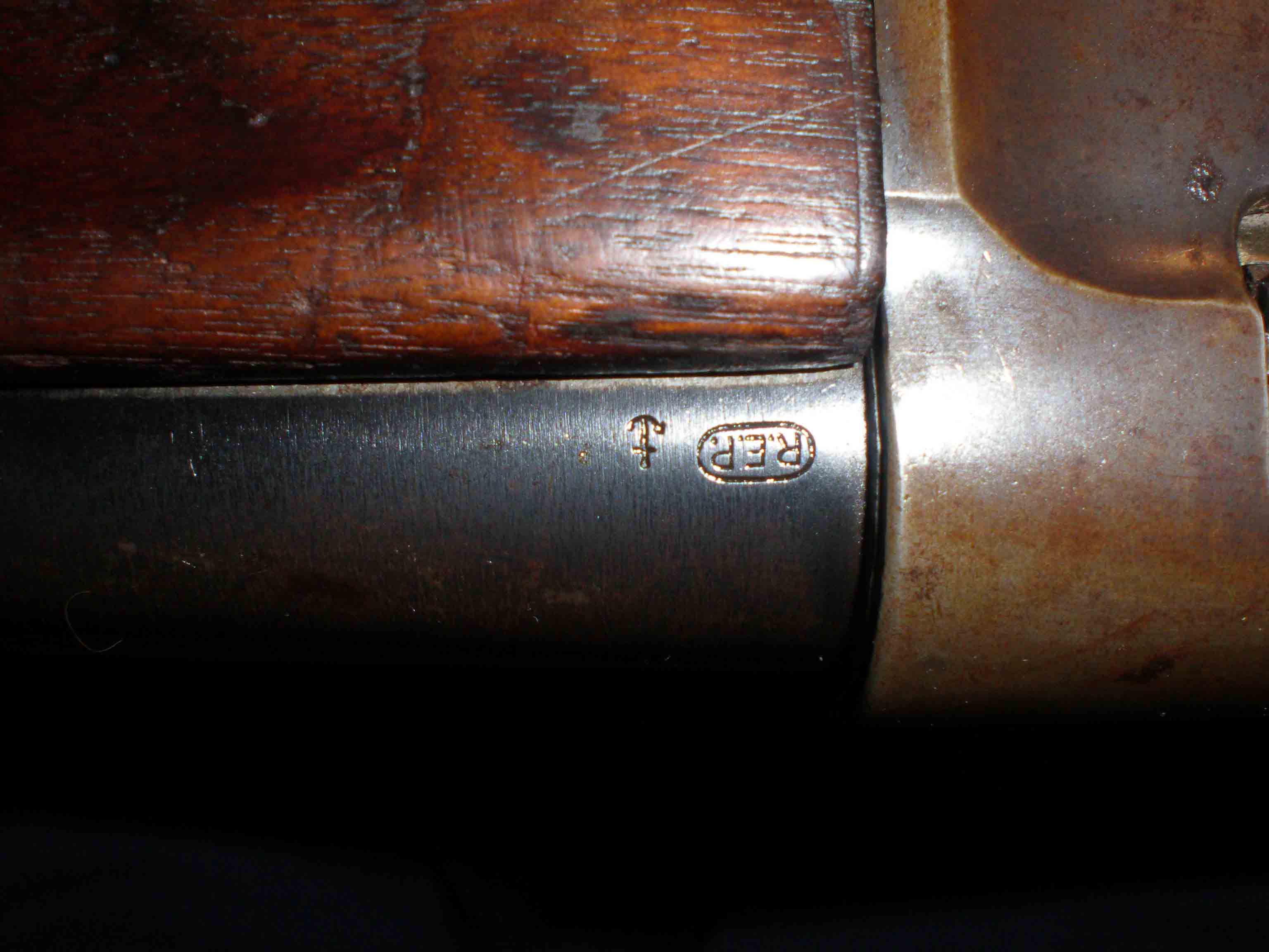

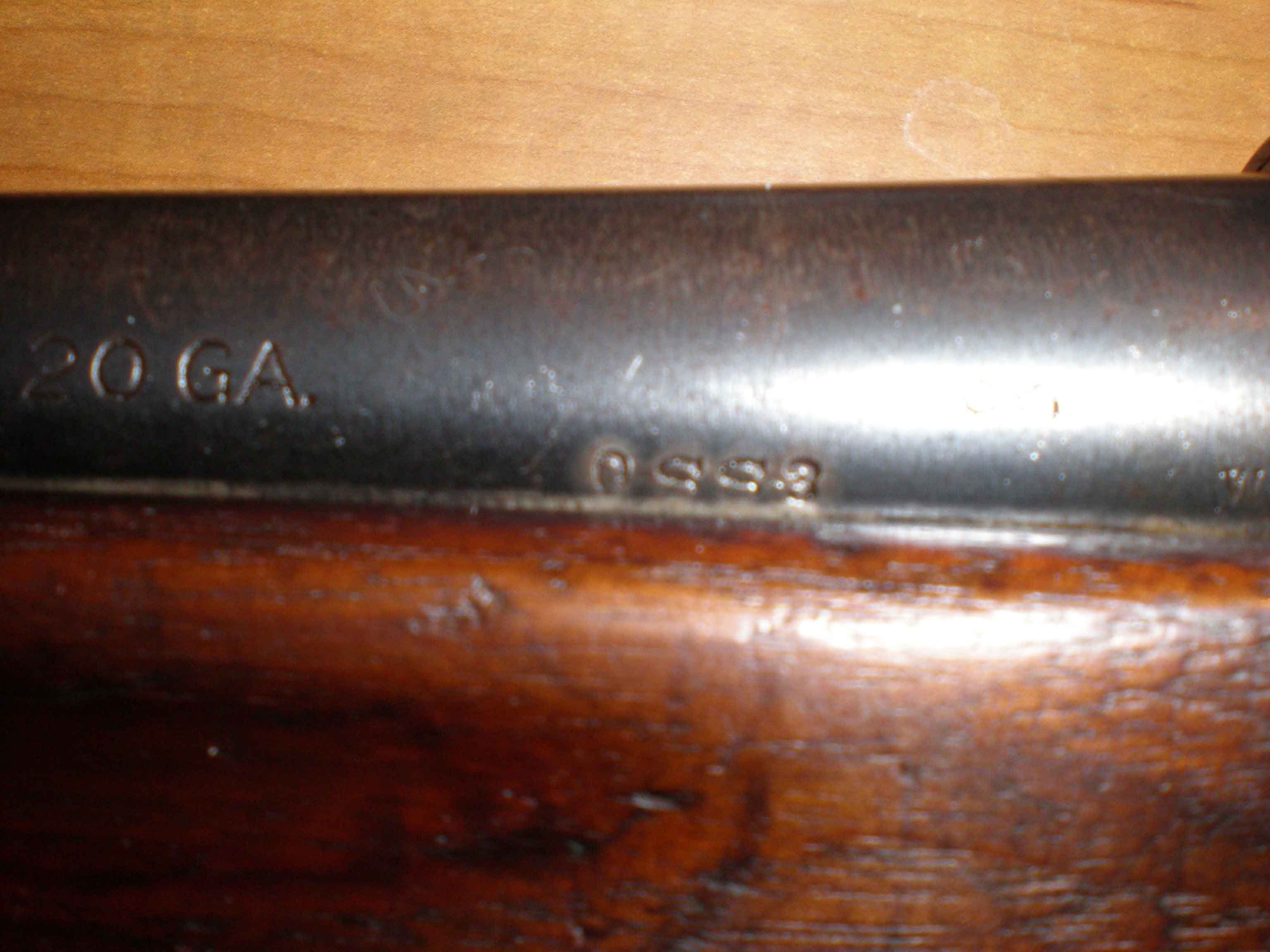

My grandfather recently gave me a Remington Model 11, 20 ga. Shotgun. It is marked 1030216 on the left side of the receiver underneath the Remington name. On the barrel it is marked with either a zero or a letter "o" followed by "SS3" and above that it reads "CYL"(I assume that means it's a Cylinder Choke Barrel" there is also a "W" followed by a "V" or "Y". I was hoping someone could help me out by telling me the date of this gun and how much it could be worth(not going to sell it, just curious). I will try to attach pictures of what is marked on it.
Also, on the right side of the receiver is very lightly engraved a signature that reads "J M Brown" with the "n" extending to underline the rest of the name. My grandfather's name is not J M Brown, nor is anyone I know of in our family and this gun was based off a J M Browning design, but still that's not the same name, I couldn't get a good picture of it as it is hard to see...any help would be greatly appreciated.

The Remington Model 11 was built on J.M. Browning patents. Serial numbers for 20-gauge Model 11s began at 1000000 in 1930. Your gun would have been made the week ending September 20, 1930 --
http://www.remingtonsociety.com/rsa/questions/FR13
The OSS3 stamping is a Remington repair code, indicating the gun was back to Remington at Ilion for repairs in July (0) 1947 (SS).
