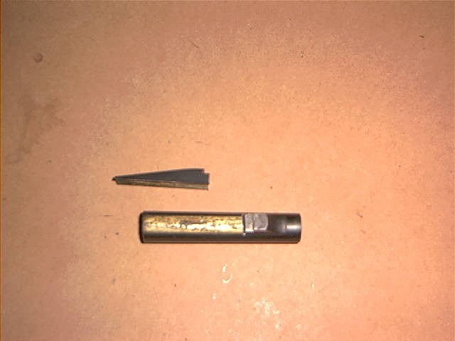

While the matter of the ramp front is of "minor" concern, it is not part of the barrel. It is
rather a separate piece of lesser steel almost identical in composition and structure to those
used on other model Remington front ramps that have the screw under the dovetail. As I indicated, it would take a substantial blow to dislodge it, but in theory it is possible. If anyone is actually interested I have a picture of a front ramp on a barrel stub that I cut into, the back end of the ramp came off showing clearly that it had been sweated on. For info!

I ground one off a 141. There was no seam. I would like to see that picture.

No war, it is just that I work on these guns every day correcting others mistakes!
My understanding is that Tom has sent you some screws
The front ramp thing is actually interesting, if "Rickster" will give me his email address I will send him the picture and if he wishes the pieces of the ramp as well.

You can attach your pictures to this thread by using the browse button near the bottom of the scroll page. Maybe others would also like to see your front sight.
Re: Help on Rem. 141 rear peep sight
For Info.

Nambu Jim is absolutely correct. I have taken off two front ramps on 141s and it is exactly like he said. His picture shows it all.
Thank you for the picture.
So, are you saying that all 141 ramps were soldered on? Or could there have been a period when they were machined?
And what do you say about 14 ramps? And the under lugs? I have not messed with those.
For future reference, how hot did you have to get it? That is, was it soft solder or silver solder?
FWIW. My recollection is that I attempted to unsolder the one I transplanted. And when it wouldn't unsolder, I chose to grind it off. Or more accurately, I chose to grind the barrel stub off the ramp such that the ramp could be reused. I was in the process of shortening an abused 141. I ground far enough that a solder seam should have shown, but I don't recall seeing one. But that has been more than a few projects ago.

Enough? As in shush?
Look, I am here to exchange information, and I would like it to be as accurate as possible. If someone validates what I post, great. And if they can show that I am in error, I am happy to suffer a little embarrassment if that is what it takes to get the facts straight.
Regarding my questions above... Unless someone corrects me, here is what I understand to be factual.
The underlug bosses are machined on 14s and 141s. The 14 sight ramps are machined. The preponderance of evidence indicates the 141 ramps are soldered. This change was presumably made to save money. The type of solder is unknown. The tang sight screws are .140x44.
