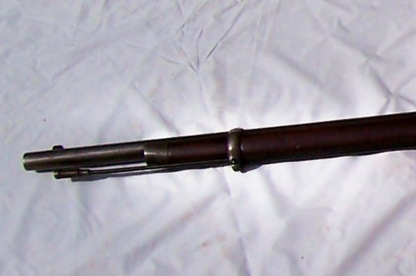

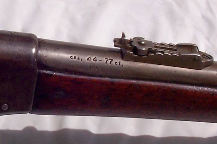

Any help identfying this beauty will be appreciated
Picked it up at the York, Pa Gun show - RB with caliber markings Cal. 44-77 cf - military stock (three band), no bayonet stud, military style sight (graded to 1000 yds). Upper tang (which doesn't show well in the pictures) has Remington Arms Company, Illon, NY with two rows of patent dates ending with 1874. The letter "G" is stamped on the receiver. Directly under the caliber markings is "1869" - this also appears on the stock. There is a small letter "p" on the left side of the barrel right next to the receiver. No serial numbers, I haven't pulled the stock to look under the barrel, yet) Barrel length is 35". Hopefully the pictures come through.
My first try at slugging the barrel had mixed results - using a .451 ball barely shaped it. It looked like the measurement was .440 or close to that. Will try again. I have not chamber cast her yet (Yes, Yellowhouse, I heard you loud and clear!).
Was wondering if this could be a special of some kind - the only sporting RB sold with a military stock option, as per konrad schreier's little book, was a Creedmore...I doubt very much that this is the case here! There are no drill holes for any other sights.
A mystery, perhaps? Any help would be appreciated.

- front cap.jpg (100.32 KiB) Viewed 7821 times

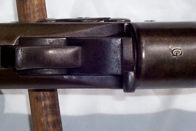

- G.jpg (105.96 KiB) Viewed 7821 times
- caliber.jpg (112.35 KiB) Viewed 7820 times

As Yellowhouse said, the .44-77 is a very attractive marking, especially on a military Rolling Block, and if it were a .44-77 it would be more desireable. I wouldn't say positively that it isn't, but two things jump out at me to make me doubt.
1-The .452"+ bore diameter. Just way too big for a .44-77 that should be .446"
2-The way the caliber is marked, doesn't look like anything I've ever seen on a Rolling Block of any make.

The saga continues - finally got a good slugging of the barrel - best read I can get is .432-.435 - will be doing the chamber cast in the next week of two - would .435 work for a 44-77? Also, the "G" on the receiver and the small letter "p" on the barrel by the receiver, does that help to id the gun?
