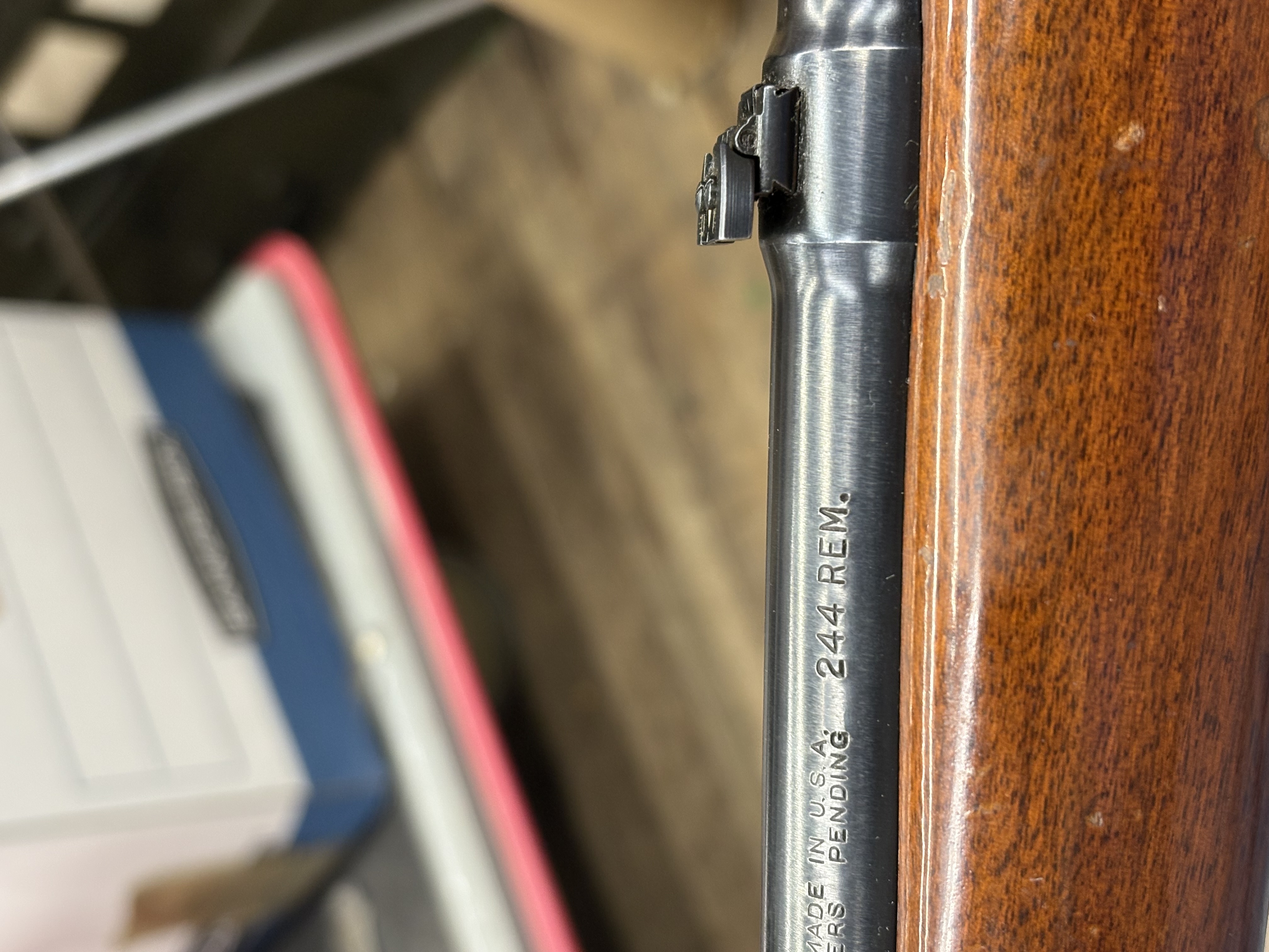

I have come across a Model 722 in .244 Remington that has me scratching my head. The date code on the barrel is "CA" this would be April 1954. My question is would Remington have made a rifle chambered in .244 that early? We have all been told that the .244 was introduced in 1955. It has a 26 inch barrel of heavier contour than my 722 in .222. Thoughts?

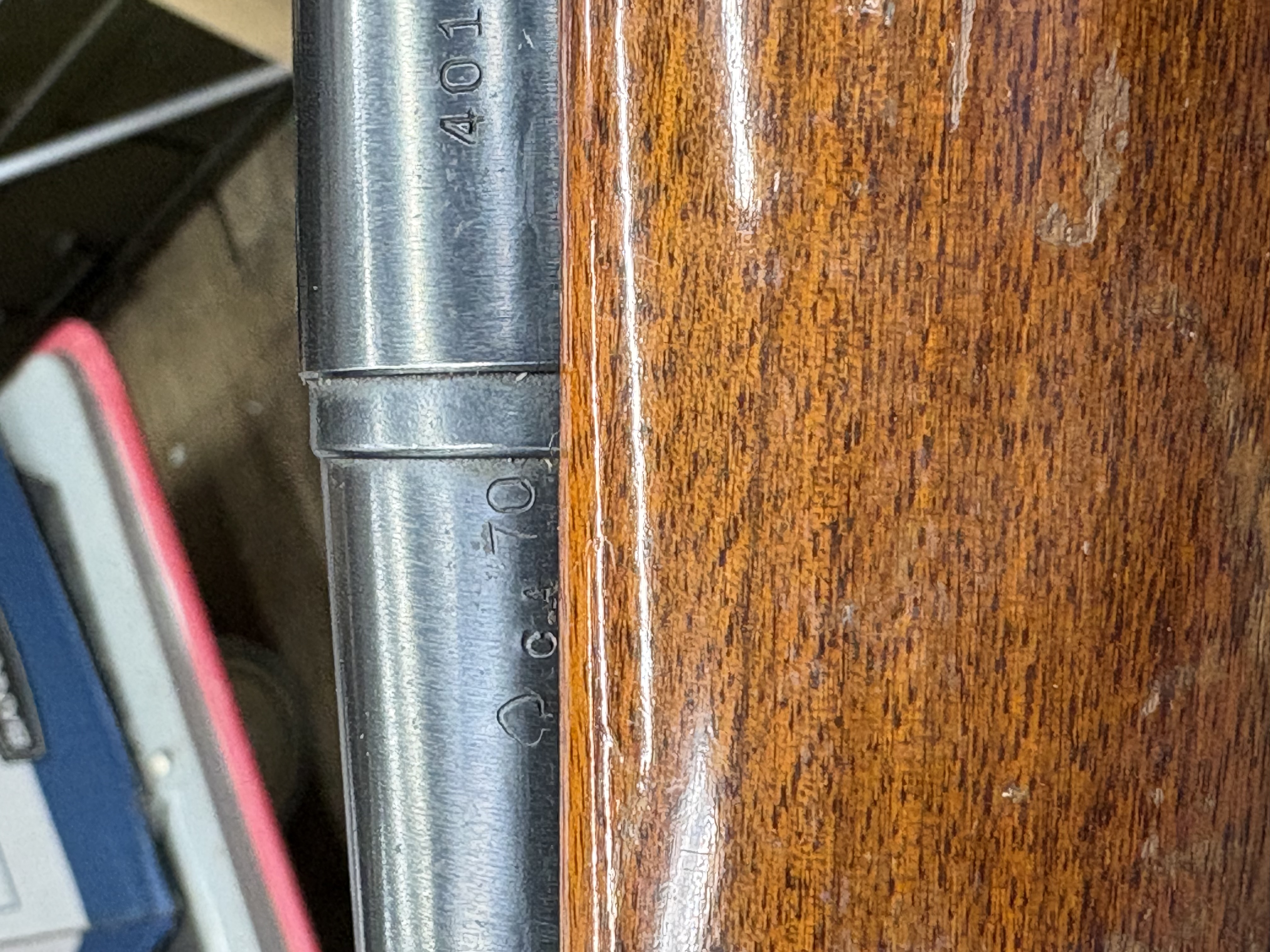

May we see a picture of the barrel date code and the first 3 digits of the serial number?

Here is a picture of the date code on the barrel and the first three of the serial number.

401XXX would be likely late 1956 or into early 57. Quite possibly a re-barrel. Are the sights nice and level?
