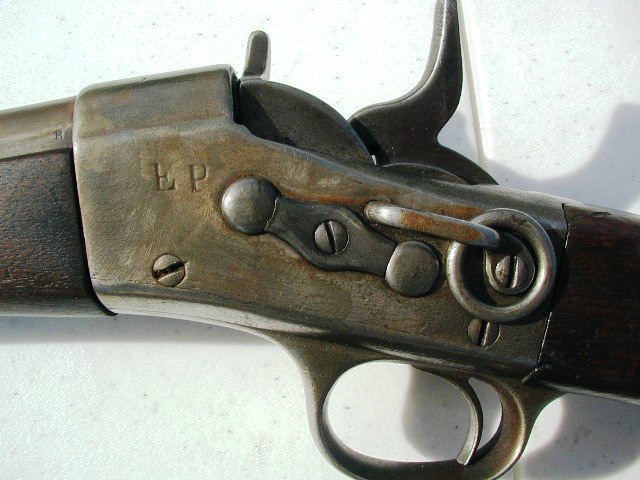

Hello Evert,
Here are some photos of my Egyptian Carbine. It doesn't have the Egyptian Markings on the barrel, but it does have the EP stamped on the left side of the receiver.
P1010227 - Copy.JPG (65.71 KiB) Viewed 8689 times

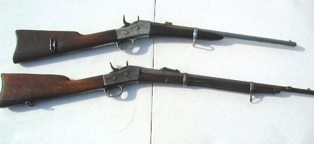

Below is a photo of the Egyptian Carbine along with a Egyptian Musketoon. The Musketoon has a barrel length of 23-1/2 inches and has a bayonet lug for the sword bayonet.

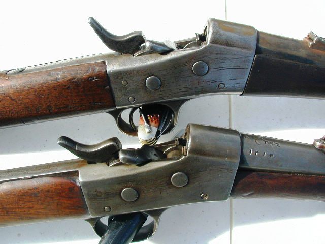

My carbine has the sling ring on the left side of the receiver and sling swivels on the butt stock and the forearm. The swivel on the butt stock was moved from the bottom of the stock to the right side sometime during its lifetime. Both the carbine and the musketoon have the rotary extractors, see photo below.
P1010226 - Copy.JPG (57.03 KiB) Viewed 8689 times
