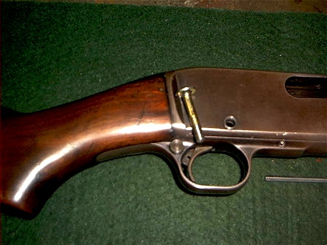

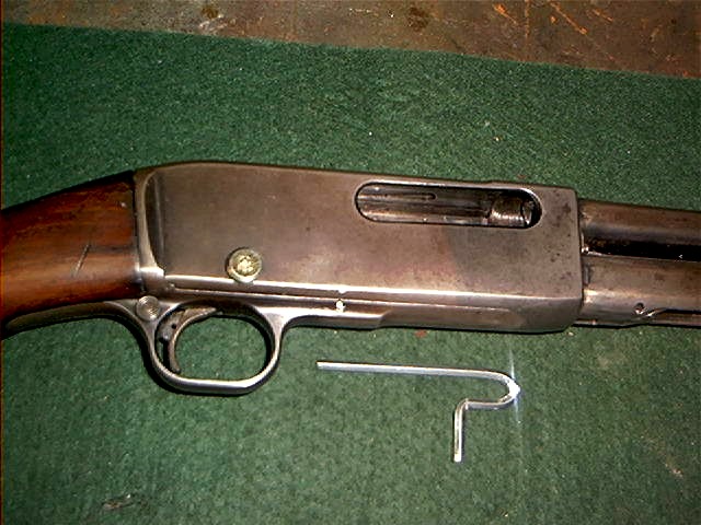

This is a first, a right side mounted "left handed" take down screw.
Thought I would pass on the pics for entertainment purposes, hope the show up since I have little experience in adding them to forum postings.

Jim Peterson
Re: LOADING & FEEDING OF THE MODEL 14/141
Trust me, it looks a lot better now!
Hope you didn't mind my putting that up there, it continues to amaze me as to the modifications folks made to keep these old guns working. This one has a lot of character and should be good for years to come.
Regards!
Regards!
Jim Peterson
