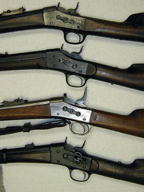

I assume the top rifle (1st pic) is a 1 1/2 which is pictured as the third rifle in the bottom pic. Is the last one is a # 4 or 6?

Yes, and no. The top rifle is the #1 1/2, bottom is the #1. In the second picture they are left to right: #1, #1 1/2, #2, #3, and #4.

The top rifle is a Sporting Model Creedmoor Musket chambered in 44-90???? The thickness at the front of
the receiver is 1.22", the thickness at the back of the receiver is 1.24". This rifle has a longer bottom tang.
The 2nd rifle from the top is a No.1 Sporting rifle chambered in 32 Long rimfire. The thickness at
the front of the receiver is 1.23" and at the back of the receiver is 1.24". This rifle has the longer bottom tang.
The 3rd rifle from the top is a NYS Model rifle chambered in 50-70. The thickness at the front of
the receiver is 1.32" and at the back of the receiver is 1.36". This rifle does not have the longer bottom tang.
But some of the early made rolling block rifles that were chambered in .58 rimfire or centerfire using Model 1861
and 1863 Springfield musket parts (wood, barrel, barrel bands, buttplate and rear sight) do have a longer bottom tang,
as found on the sporting models.
The 4th from the top is a baby carbine, built on a No. 1-1/2 frame in 44-40 caliber. The thickness at the front of
the receiver is 1.14" and at the back of the receiver is 1.13". This carbine does not have a longer bottom tang.
The Model No.1-1/2 sporting rifles were first found in the 1885 Remington catalog and were
produced until about 1897.
Have a good day,
Matt
