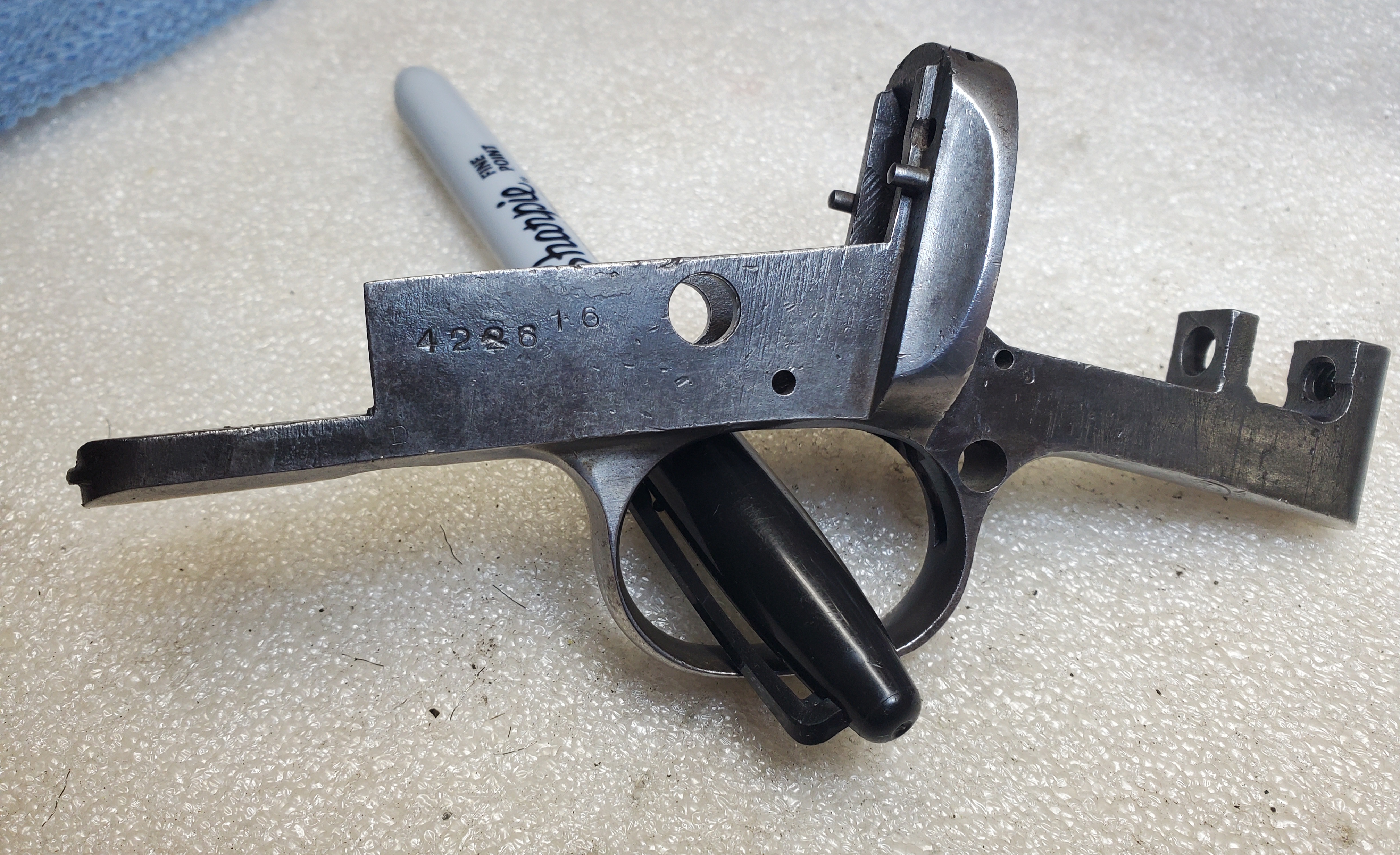

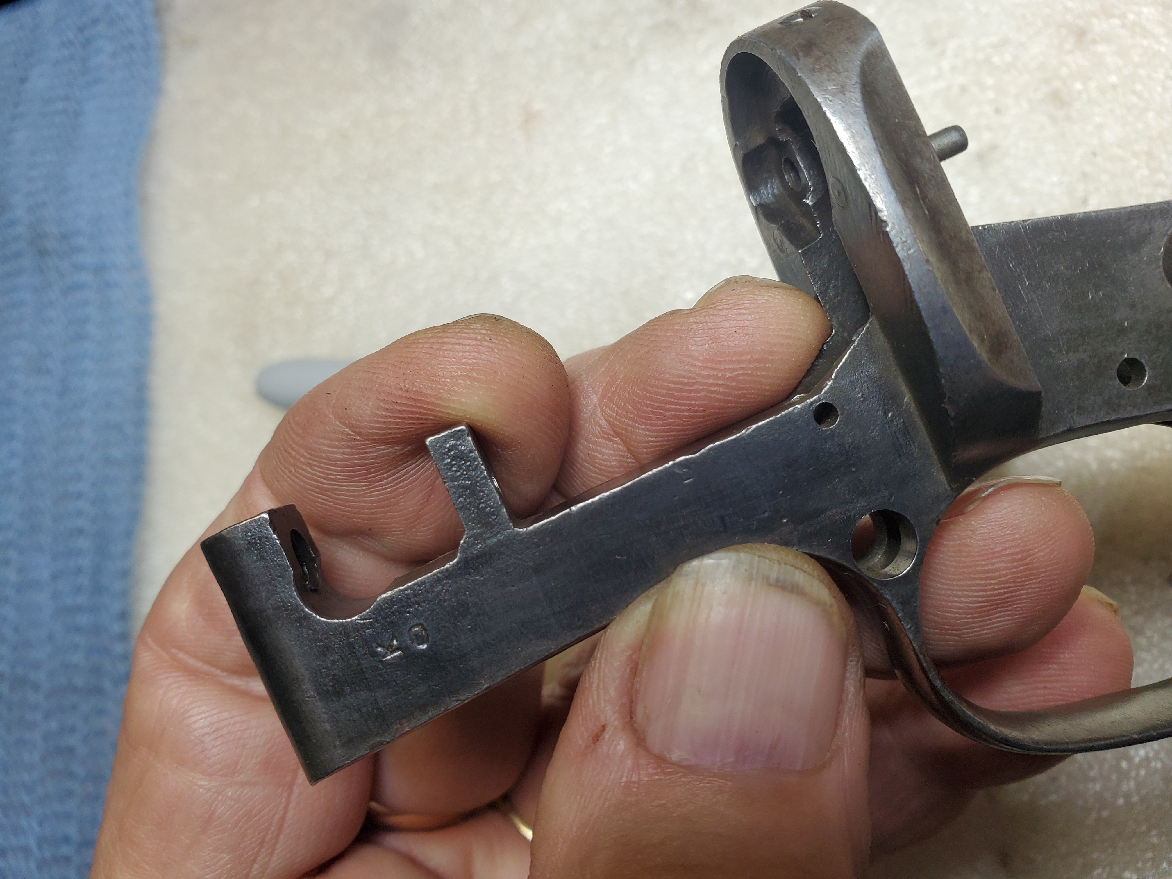

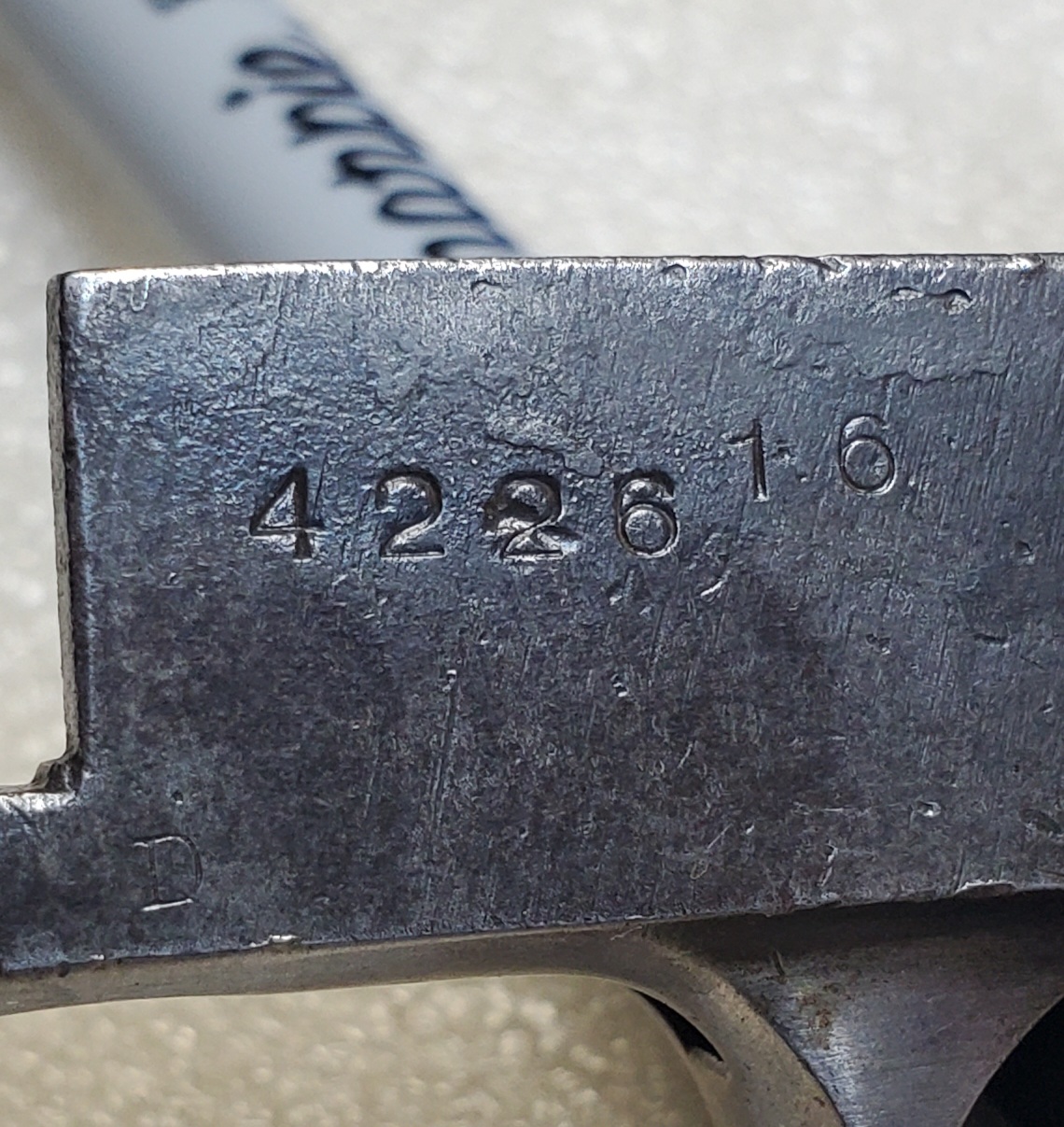

I recently acquired a "nickel" (chromium-plated) trigger guard & trigger. (I think I also have a 1909 Butt Plate in Nickel.) My question, as any avid Collector might ask is: Does anyone have any leads on the other Nickel rifle parts (e.g., Barrel, Receiver, Feeder Tube/Action Bar)? A couple pix attached. Thank you.
Sideways "K" & "0"
Sideways "K" & "0"
Rear Stampings-K0.jpg (5.84 MiB) Viewed 1399 times
SN: 4226 (16) - D
SN: 4226 (16) - D
STAMPINGS-Nickel Triger Guard.jpg (419.28 KiB) Viewed 1399 times
Nickel Trigger Guard
Nickel Trigger Guard with SN.jpg (2.51 MiB) Viewed 1399 times

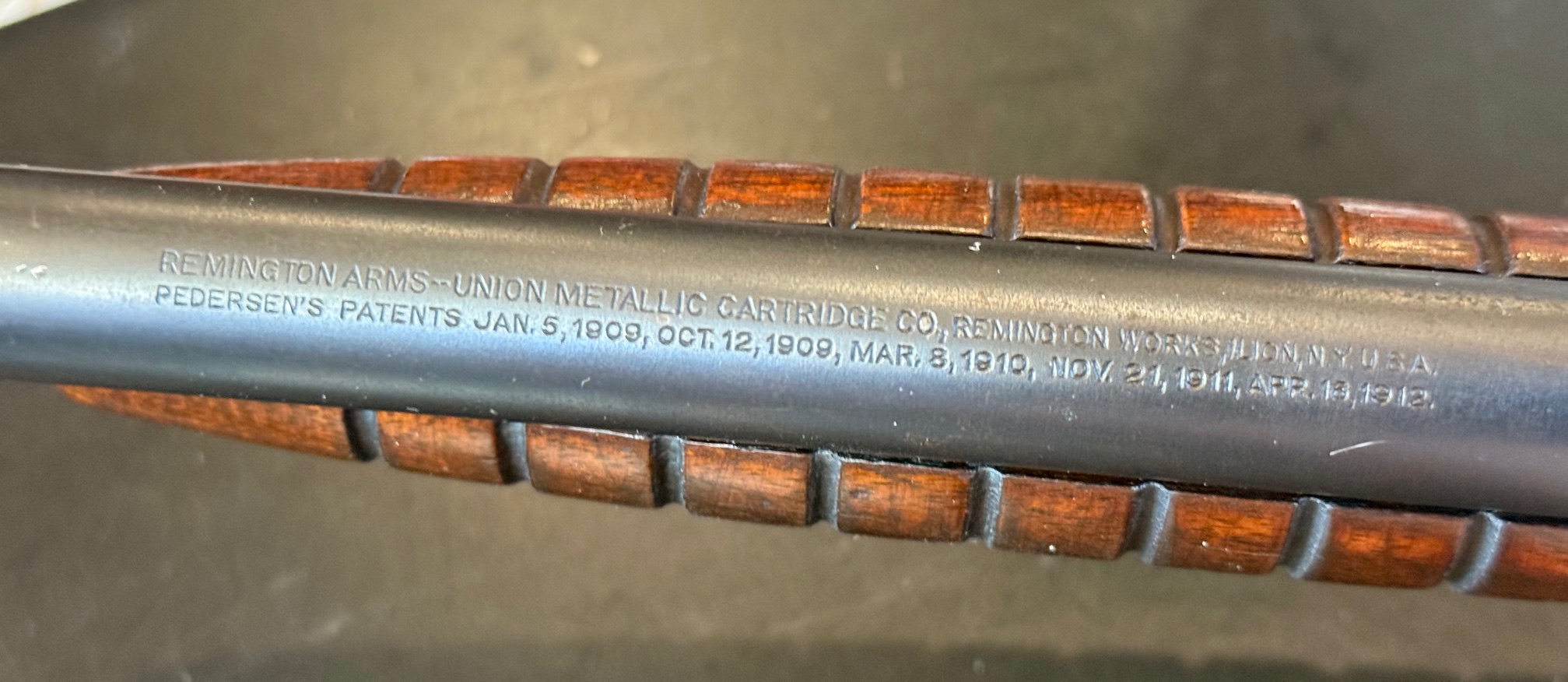

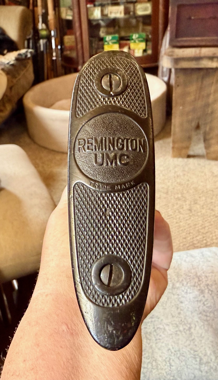

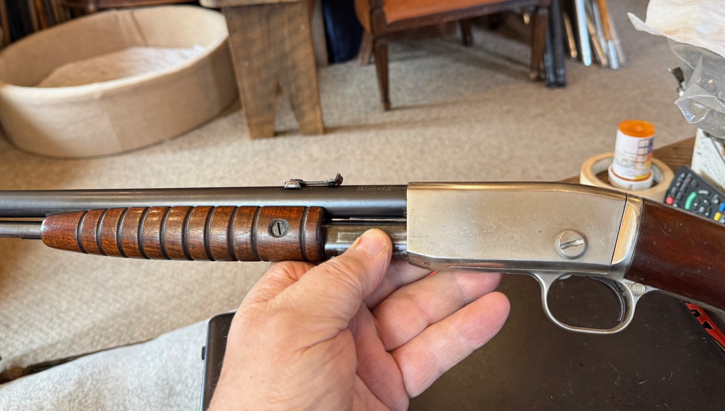

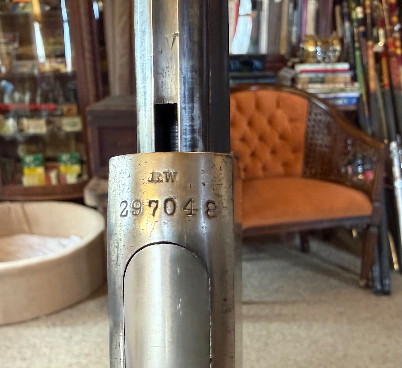

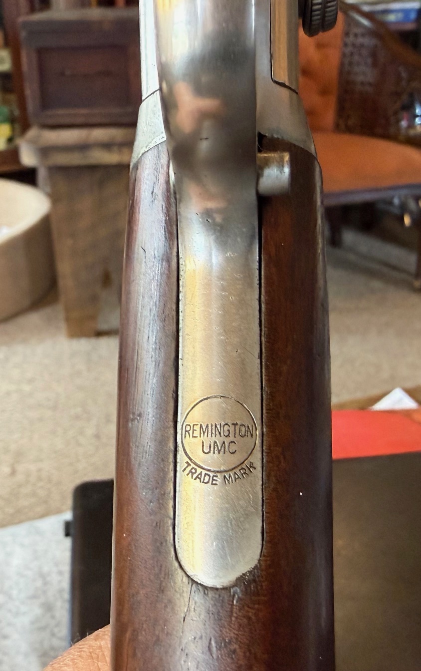

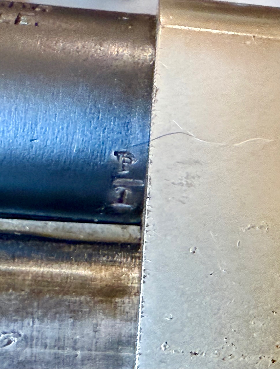

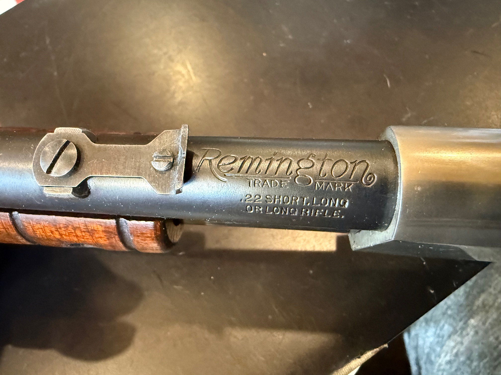

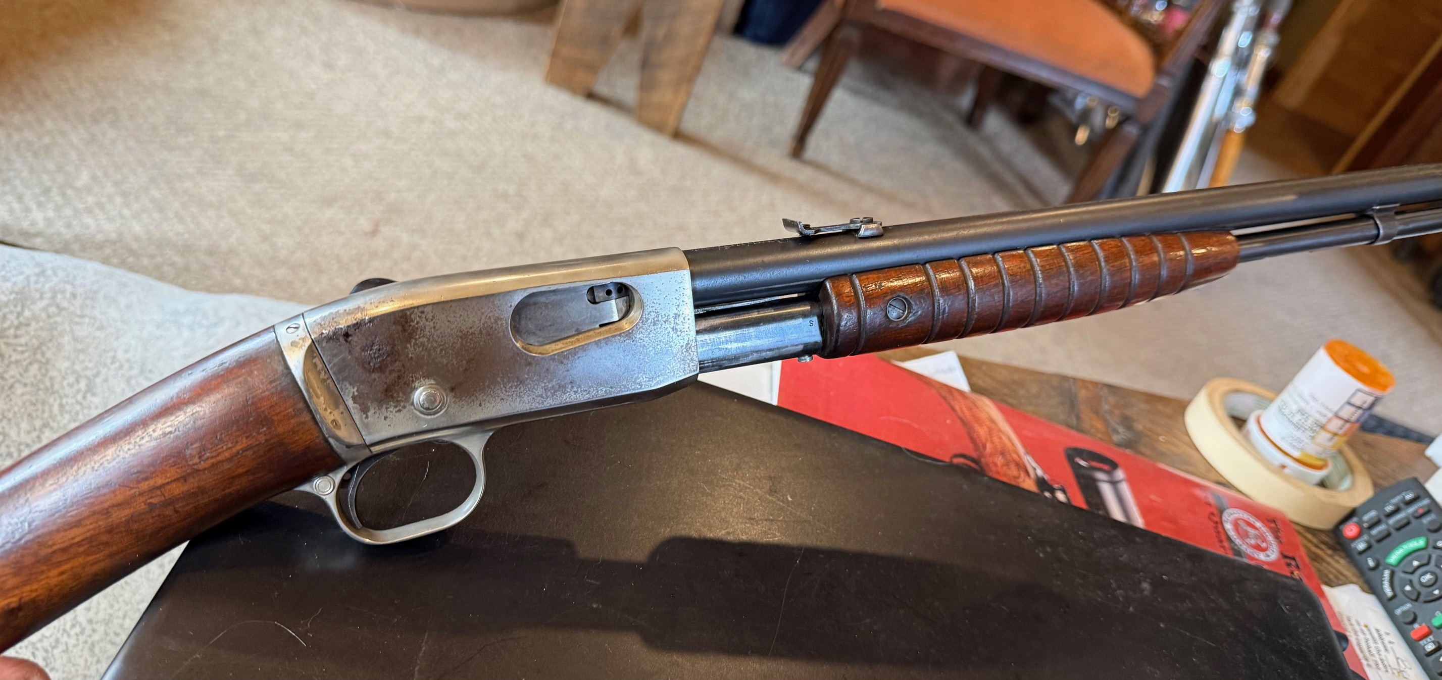

I have what I thought to be known as a Pre Mod 12 serial number # 297048 with RW above. Using the serial number look up it looks like 1915. But it looks like the barrel code is PL Which I think would be 1920 ?? I am not sure about what production date would be ?? Round barrel Nickle plated receiver all other parts are blued. Here are pictures please share any thoughts. John Taylor
