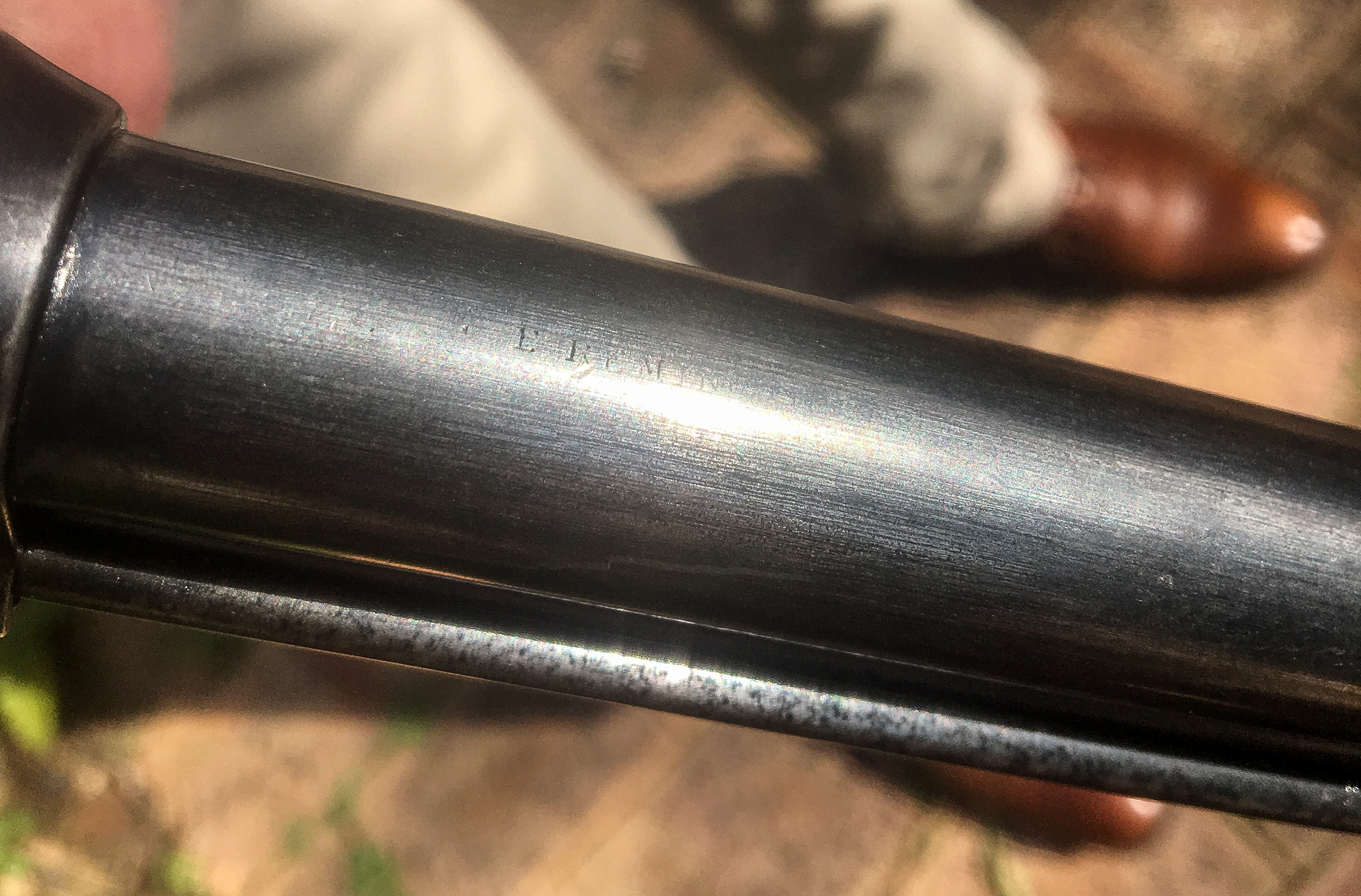

Thanks aardq. Further scrutiny does show a faint barrel address, especially with sun glint or with jeweler's loupe.

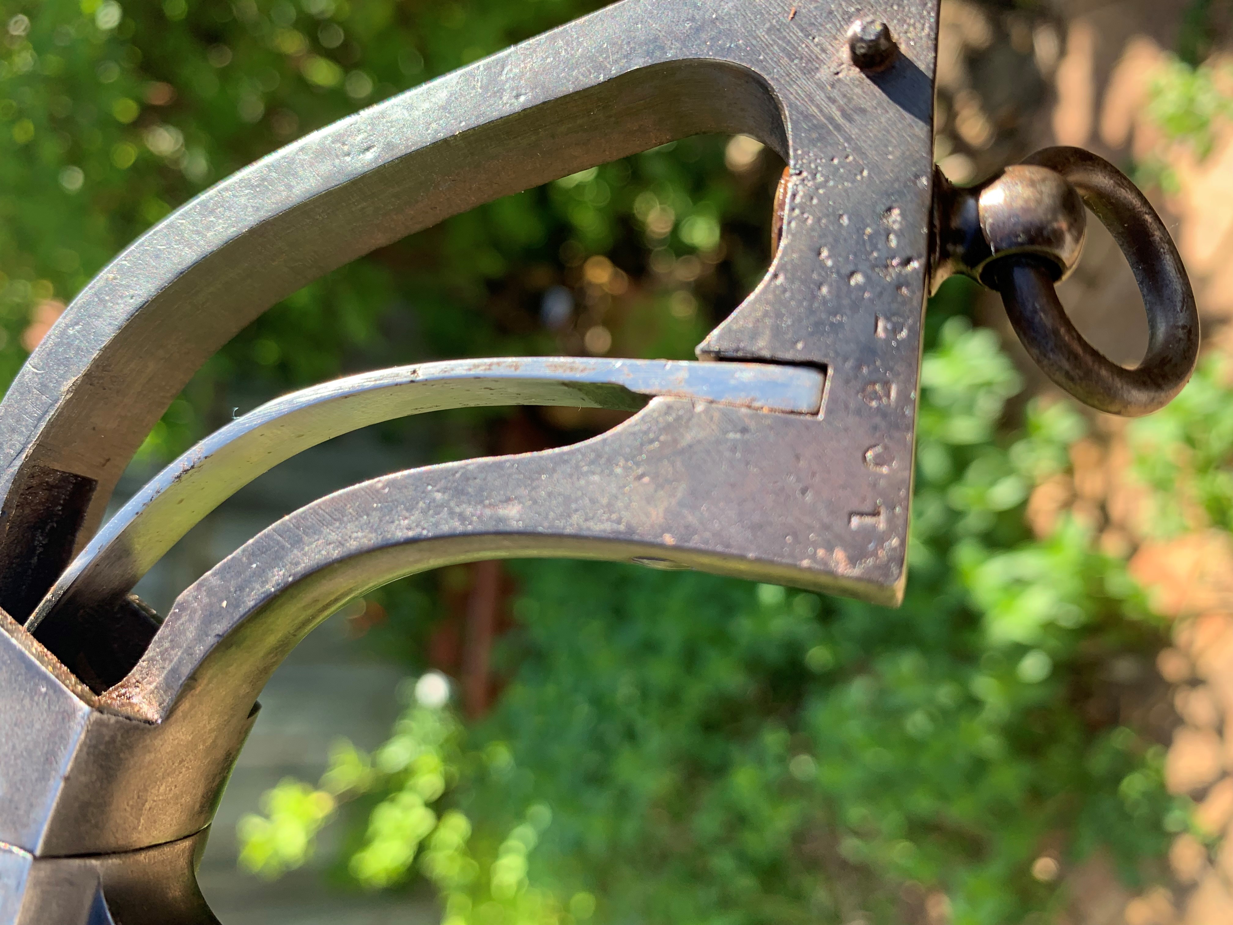

Serial on trigger guard tab the same...

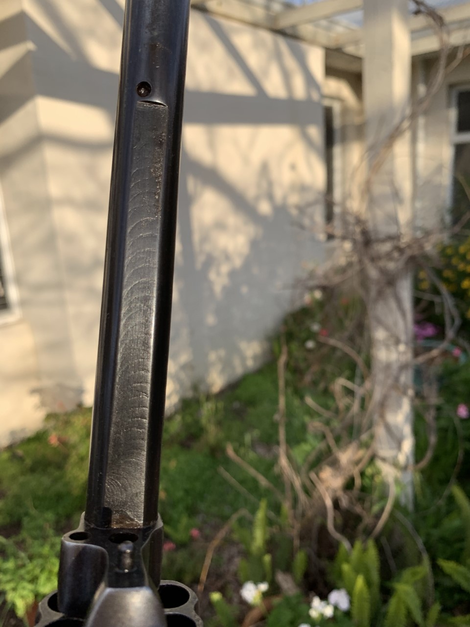

No serial number apparent on barrel beneath ejector assembly

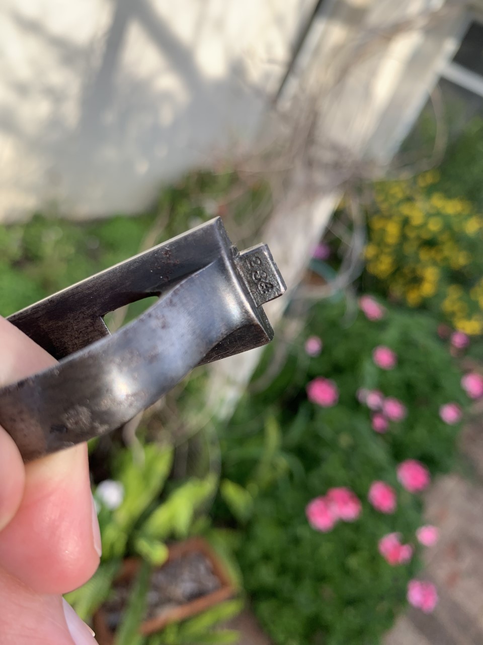

Thanks Bill. I did look on the loading gate, but may have missed it. Would it be on the inside of the gate?
Re: Remington 1875 - No barrel address
It's on the tab that allows the gate to pivot. You will probably only see a couple of numbers because you have a five digit serial number.
Sorry for the mis-info on serial location. Don't know why I thought that. Bill is right on the locations.

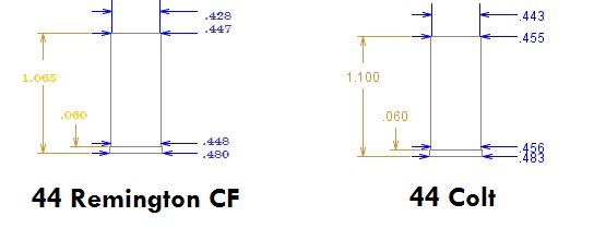

44 Remington Dies are available at CH4D.
I think 44 Remington CF could be formed from 44 Colt,
which is available from Starline.
Bullet mold is available from Old West Bullet Molds.
I'm not sure if the 44 Colt Crimp Die would work with the 44 Rem CF.
Hereis what I have for case dimensions. I'd verify chamber before doing anything.
Hope this helps, AntiqueSledMan.
