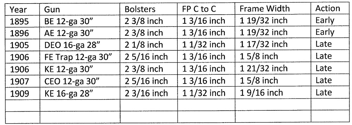

Here are the frame dimensions off the guns I have --
FP C to C is Firing Pin Center to Center.
Re: Model 1900 Forend Missing
Thanks for your data.
From what I can see there are a couple of conclusions that can be made. First, the 16 Ga seem to be consistent and were not used for small frame 12's given the firing pin measurements. Second, there is no variation in the firing pin measurements for the 12 Ga. Lastly, there is a lot more overall variation than I thought possible.
