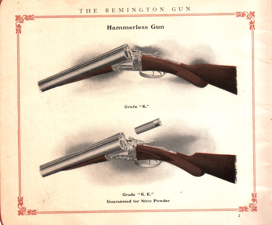

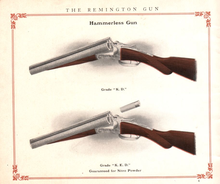

While the gun has the "correct" butt plate, that butt stock is certainly not original Remington. The shape of the grip, the checkering, the shape of the stock cheeks and the nose of the comb are all wrong for a Model 1900 of any vintage.
1906 Remington Arms Co. catalog
K- and KE-Grades 1906 picture.jpg (97.8 KiB) Viewed 10282 times
K- and KE-Grades 1906 text.jpg (94.86 KiB) Viewed 10282 times
KD- and KED-Grade 1906 picture.jpg (79.04 KiB) Viewed 10282 times

Yes I quite agree that the stock is not original to the gun. However, the subject of my last post questioned how it can be determined that this gun is built on a small rather than a standard frame, as stated in a previous post, given the information and photos offered. Any input?
