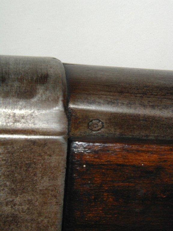

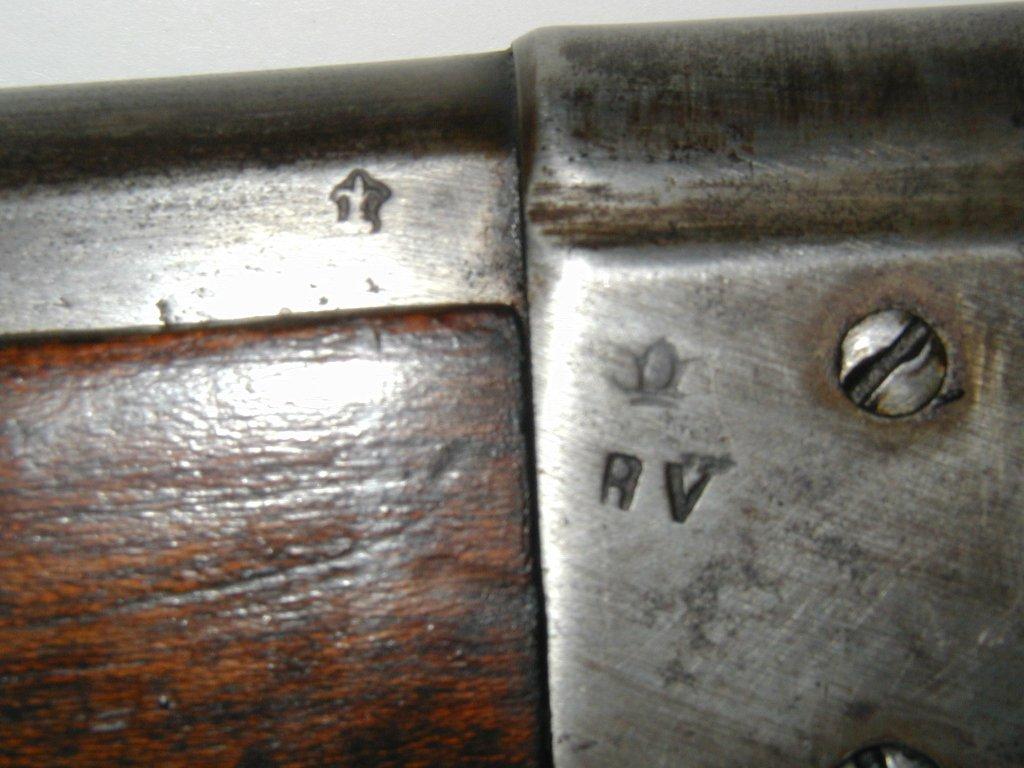

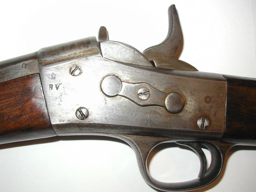

Hello,
Here are some photos of my rolling block rifle with the same markings.

This is what George Layman said about the markings on this gun a few years ago "The bubble like"flower" on the right chamber and the Fleur d Lis on the left chamber is the mark of the Ejercito Ultramar or the Spanish Colonial Overseas Army indicating it was issued in Cuba, or Puerto Rico or even in the Phillipines. "
Hope that helps sum.
Have a Good Day,
Matt
JV Puleo
Re: Remington Rolling block with unknown markings?
Post by JV Puleo »
Thanks Matt, that is really good as it really nails the fleur d'lis down as being a Spanish mark and associates it with Cuba and the volunteers as well.
