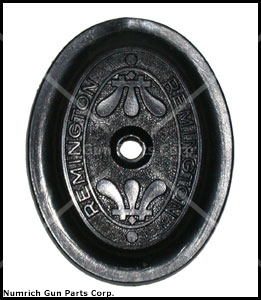

What does the pistol grip cap look like on yours. From the photo, It looks like it could be from an 870,
Since the 58 had an aluminum one.
I don't know if there are any records to verify this, but that's my belief.

Thanks Chuck, I am glad to hear that I am not alone. Here is a drawing I found online of the grip cap on my gun. I think you are right on the money with the buttstock being from an 870. That was my guess too. My grip cap looks just like this and is made from black plastic.

The grip cap is the same as yours. (It might be from a M-31 or M-32)? The standard 58 cap had a dog with bird in it's mouth.
As I said, I think this was a batch where they used up any parts that were still on hand, and would fit, when the M-1100 was introduced.
