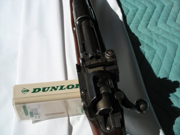

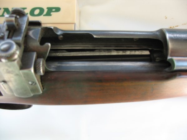

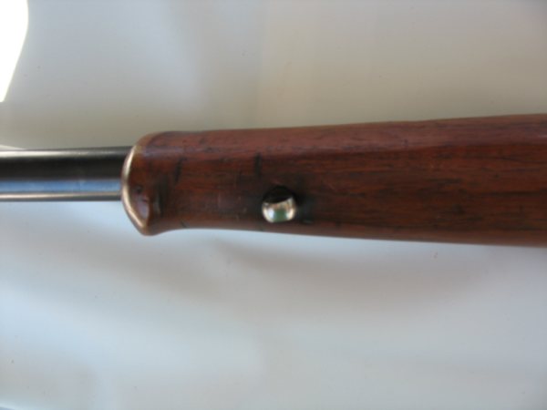

I have some info and pistures now, but the picture that I wanted to get was not readable, but he is retaking the reciever to barrel area for markings and the front sight. Attached at the rest of the pictures of the rifle.
here is the info that he sent me in email:
[which is barrel] says .30 springfield 1906 -- right side is receiver says[very top] REMINGTON trade mart-- then below that is # 680. -----
part way down barrel says:
Remington Arms Company Inc. Successor to the remington
arms UMC. co.inc. remington ilion works, n.y.u.s.a.
the gun has the enfield action[could be spelled infield]
22" barrel---I think the rear sight is the Marble-goss one on the side of sight is marked MG uspa.
When I get the pictures of these markings, I will post them too.

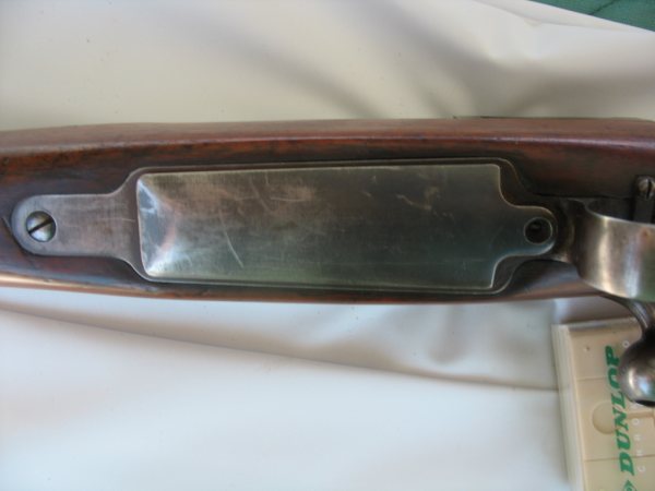

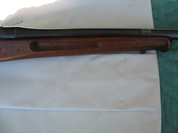

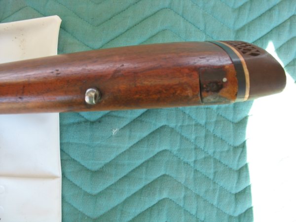

pictures 3 of 9
Ken
Ken
- camera 172.jpg (27.69 KiB) Viewed 9257 times
- camera 170.jpg (22.56 KiB) Viewed 9257 times
- camera 169.jpg (28.79 KiB) Viewed 9257 times

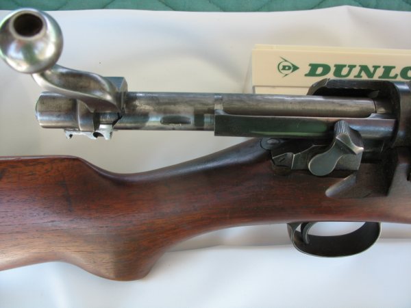

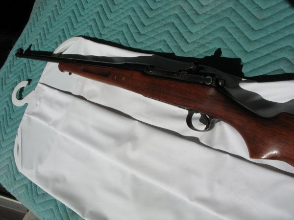

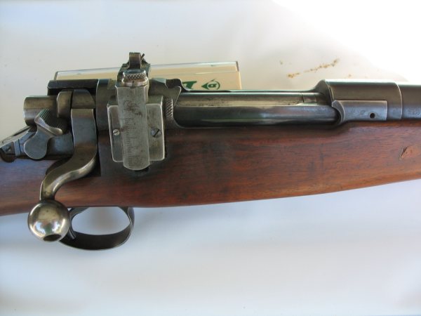

Sabith
Re: Need more info about this REmington .30-06 rifle, please
pictures 6 of 9
Ken
Ken
- camera 178.jpg (26.71 KiB) Viewed 9257 times
- camera 177.jpg (35.53 KiB) Viewed 9257 times
- camera 173.jpg (35.6 KiB) Viewed 9257 times
Sabith
pictures 9 of 9
Ken
Ken
- camera 181.jpg (39.28 KiB) Viewed 9257 times
- camera 180.jpg (40.63 KiB) Viewed 9257 times
- camera 179.jpg (17.36 KiB) Viewed 9257 times

well, second try at pics no luck either, but here is what my father wrote to me about it. I will see if I can get him to find someone that can take a closeup picture in focus (does not know much about the digital Camera, sorry).
you can't really make muck out of the other markings[also their on the bottom side of barrel/breech] had to remove stock, anyway the one marking is a circle/about 6 lines comming out[like a picxture of a eye. then the letter is a B and below it a diamond mark & to left of it is a u
not sure if that helps or not.
Ken
Ken
Sabith,
I believe you have a first Model 30A, The low SN would indicate first year production.
The 1st. Model (1921) had a Remington receiver site dove tailed into the reciever bridge.
They are impossible to find, so a Marble-goss might have been added later. We do know the butt stock has been cut to add the recoil pad, however the grooved fore end was correct for the 1st. Model. It was changed with the introduction of the 30 Express.
There are two things that were different between the 1917 Military and 1st. M-30.
Is there a dovetail under the present receiver sight, and does the bolt cock on opening or closing? Military cocks on closing while the M-30 on opening.
If I was not so technically challenged, I would post photos of my 1st. Model.
ChuckD
ChuckD
