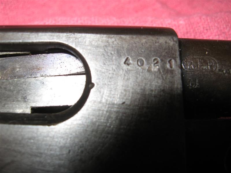

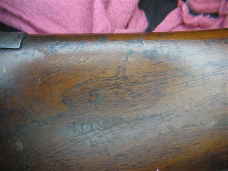

Anyone have an idea what these markings are? They look like inventory marks to me. But who's inventory?
Rifle is a Rem Mo 25 in 32 WCF. Upper and lower receiver sections have mismatched S/Ns. Looks like it has been carried quite a lot.

These guns along with the Model 14 were used a lot by numerous prisons throughout the US,
Canada, and even some in Australia. I have an M25 in 32-20 stamped Dept. of Corrections for Cook County, IL. The police department my Dad worked for had some M25's and when they retired them in the early 60's they were not only "well used" but looked like they had been used to defend Dien Bien Phu!

That sounds about right. Externally it is well worn. But the internals and bore are in excellent condition, and the action slick, indicating it was carried much and shot little. I took it out shooting yesterday and it did very well. I had originally planned to make this the one that I convert to 218Bee, but I am getting a soft spot for it just the way it is.
