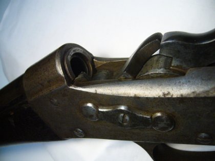

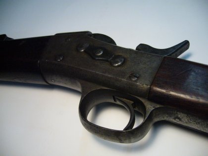

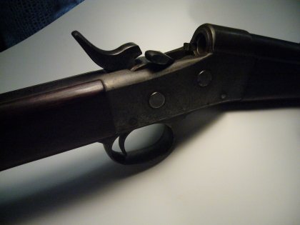

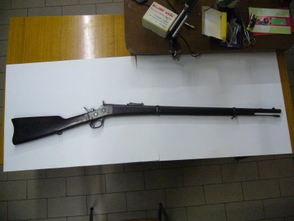

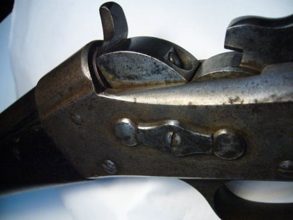

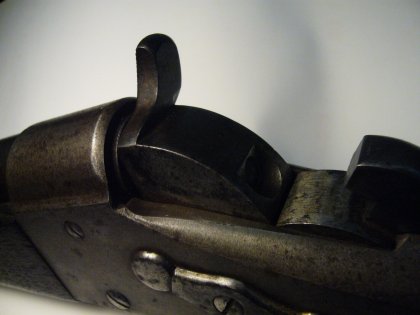

Here are additional details requested:
1-INSCRIPTIONS ON TANG: (only partly legible: a question mark (?) means not legible
REMINGTON'S. ILION. N.Y. USA
PATD MAY 3 1864. MAY 7. JUNE 11. NOV. 12. DEC. 24. 1872
DEC31. 1872 SEPT ? 1873 JAN. ? MARCH ?? ??? (perhaps 1874)
2-SABER-BAYONET LUG: YES
3-OVERALL LENGTH: 115.5 CM (= 45.47 inches.)
4- CALIBER: Definitely .43 EGYPTIAN
I have taken some photos which I am attaching. Hope they will help.
Really many thanks for your help!!!
Ciao!
Marco

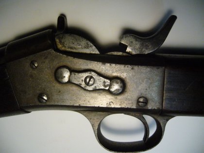

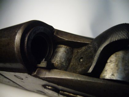

more photos.....

Re: HELP WITH AN ABYSSINIAN/EGYPTIAN (?) REMIGTON FROM ITALY
An Egyptian Musketoon and in remarkably nice condition too, probably because your great-grandfather acquired it when it was still fairly new. They are much more rare than the 3-band rifles. It couldn't have gone to France because it was made long after the Franco-Prussian War was over. They must have been among the last of the Egyptian models made, most likely in 1874-1875. This is the first example I have noted with a side extractor...all of the others have rotary extractors. Remington didn't receive the final payment on the Egyptian rifles until September of 1880 but, prior to that, thousands were stored in warehouses in Birmingham. Total production of all types was slightly less than 200,000 but we have no way of knowing how many were musketoons like yours. While waiting for their money, Remington made a serious effort to sell them to other buyers. We don't know to what extent they succeeded so the chance remains, that even though it was likely made for Egypt, it may have been sold elsewhere.
