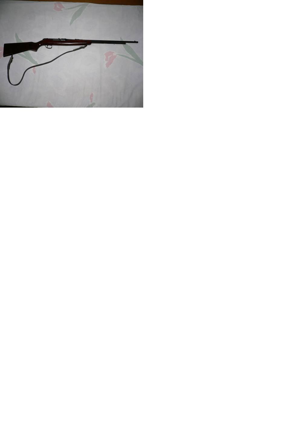

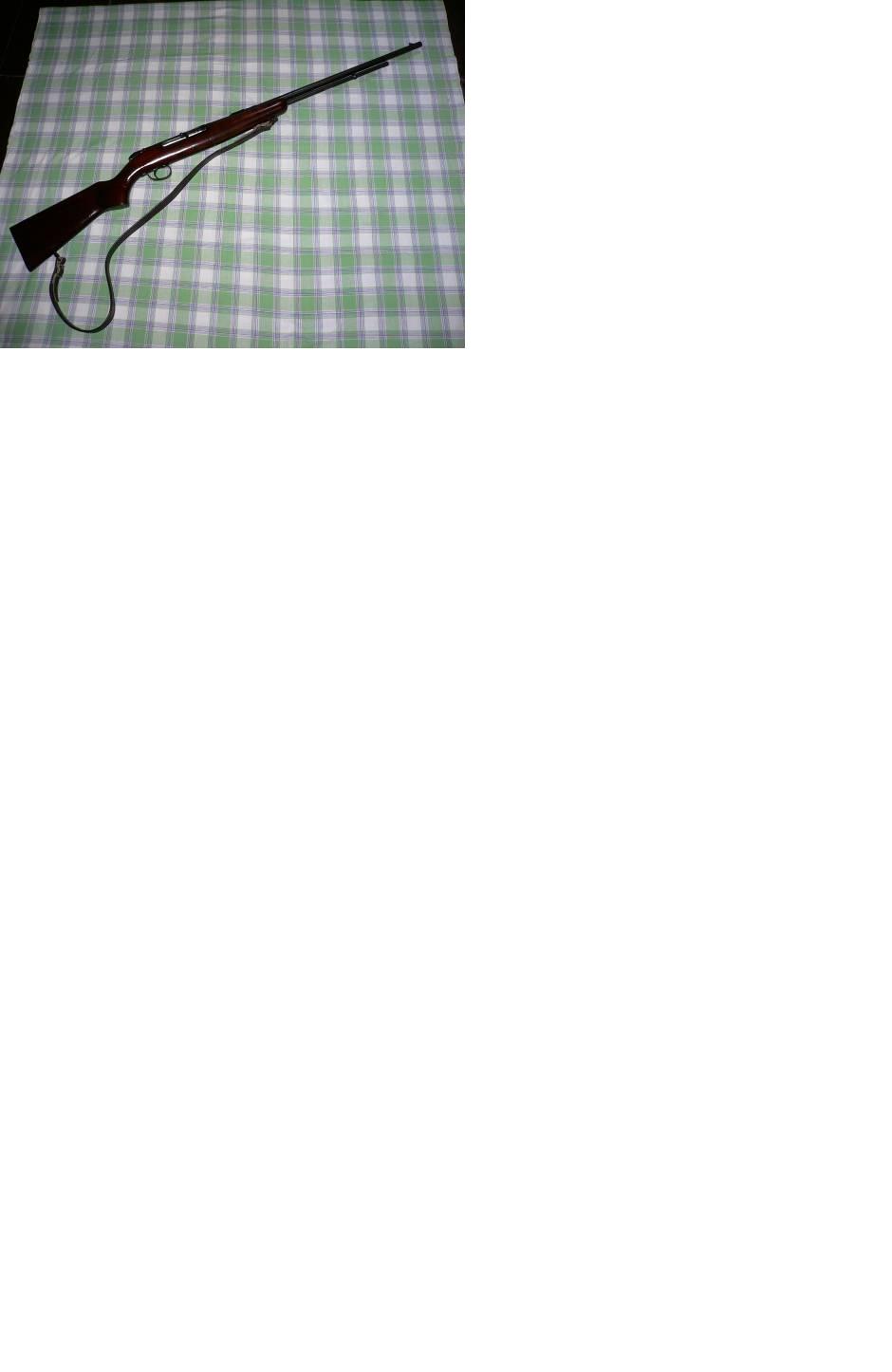

Attached pls find some views of the rifle. Hopefully, we can obtain some clues form them. Unfortunately we do not have a closed-up view of the rifle on hand. We will try to obtain it.

Thats a Remington 550 22 rimfire rifle.
Re: Remington rifle 1950s-1960s
Yep. That's what it is.
Here's a link to Remington's firearms manufacturing history for the 550.
http://www.remington.com/library/histor ... el_550.asp

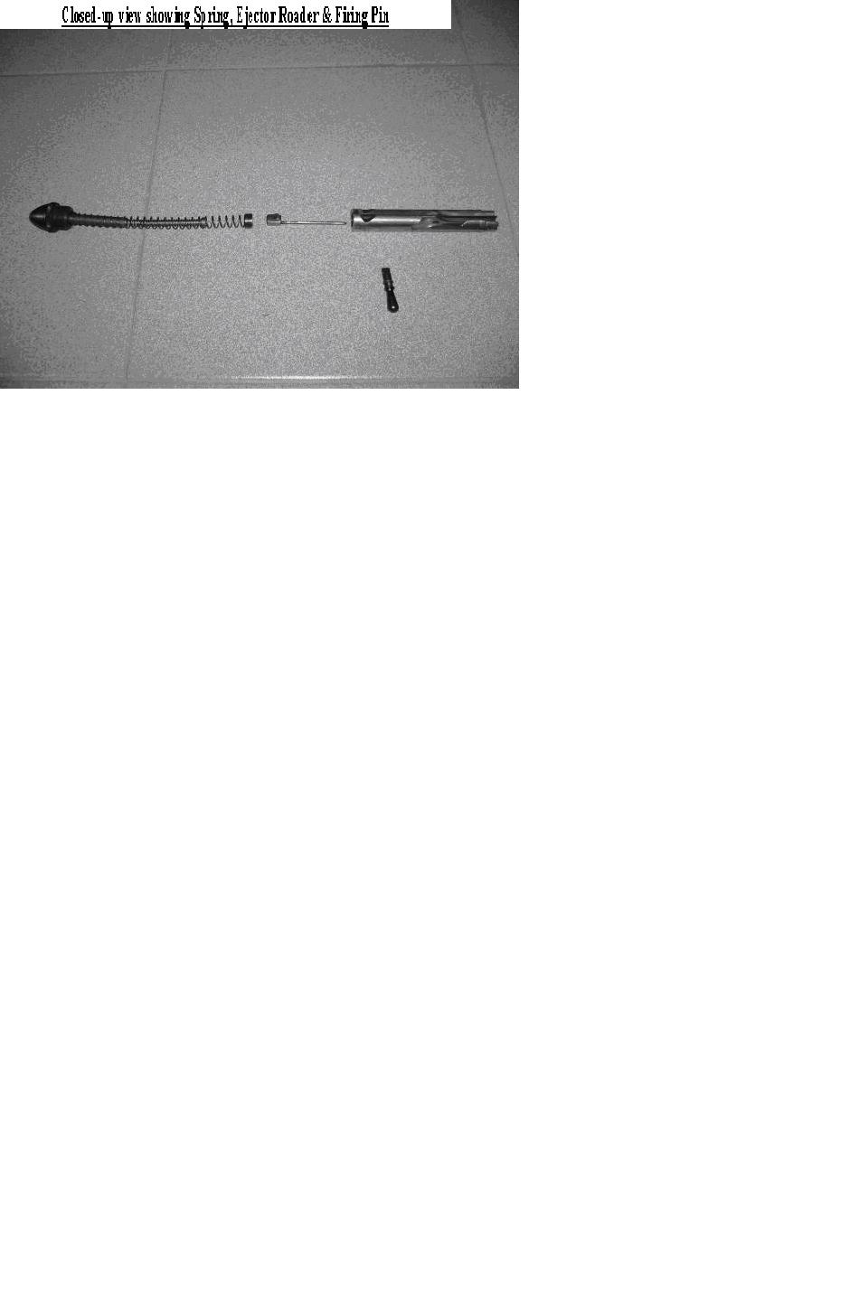

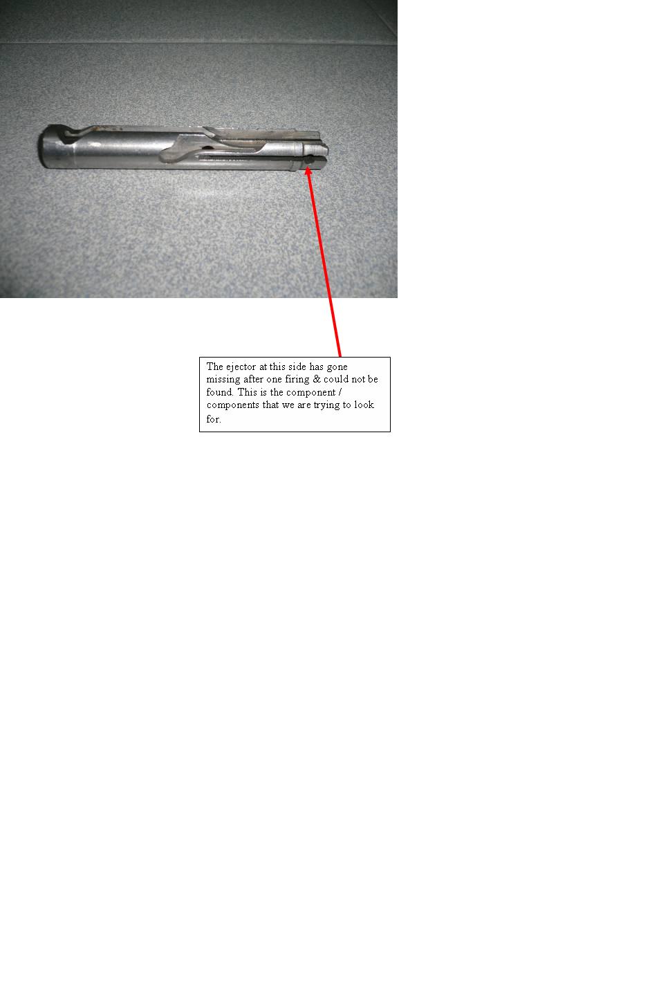

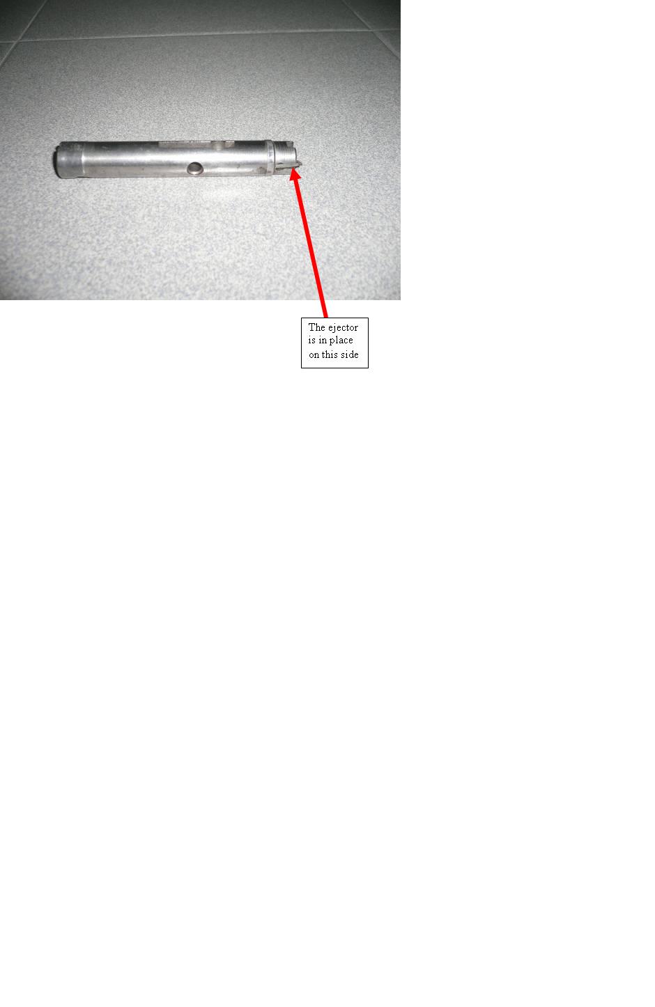

Finally, we have got hold of the closed-up views of the ejector part which had gone missing. We would like to know how or where can we purchase the missing component & its associate parts.
Attached please find the closed-up views for your reference.
Thank you to all who have share the views on this matter.
Have a nice day.
Regards,
bernice
Have a nice day.
Regards,
bernice
- ejector closed-up general view.JPG (63.5 KiB) Viewed 14267 times
- ejector closed-up view 2.JPG (67.51 KiB) Viewed 14267 times
- ejector closed-up view 1.JPG (58.1 KiB) Viewed 14267 times

In my last post, I listed links where you could start looking to obtain the part(s).
Den
