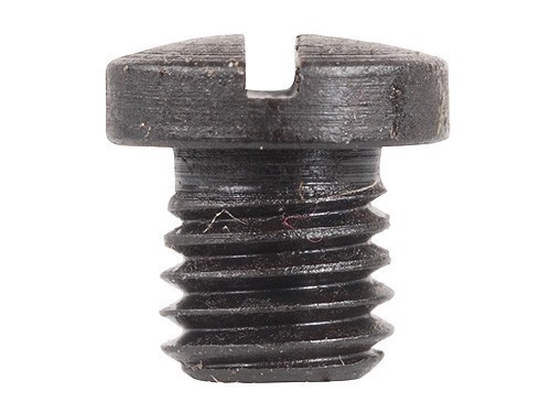

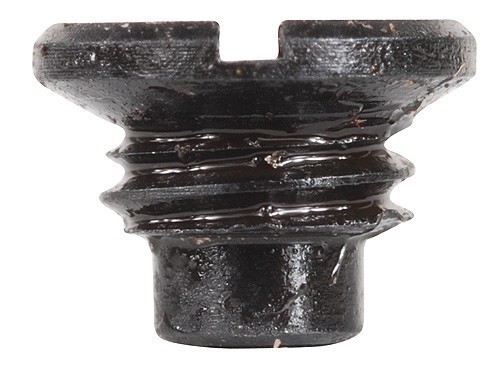

I think I figured out my problem: Midway USA actually sent me the wrong screws, mis-labeled. It appears as though they sent me (2) Magazine Screws instead of (2) Front Sight Screws. This is evident after I studied the following photos of each one and determined what I had. Now it's on to do battle with customer service . . . ugh.
- Magazine Screw
- Rem Magazine Screw 25105.jpg (41.92 KiB) Viewed 2743 times
- Front Site Screw
- Rem Front Sight Screw 16892.jpg (33.79 KiB) Viewed 2743 times
Re: 572 front sight screw question - FRUSTRATED!
Jeff,
Have you contacted Midway and explained your dilemma? If not, I think that's where I would start.
I just looked at the front sight and screws on my Nylon 66, but I don't have a 552 or 572 in BDL models to compare them.......my 552 and 572 are both the "A" models which use the dovetail front sights.
However, I did use my dial caliper and measured the inside diameter of one of the holes in the front sight where the screw goes in (on my Nylon 66) and it measures .208. Then, I removed one of the screws and it measured .201 across the head. The screw diameter itself appears to be .135.
Den
Edit: Oops......I was measuring and typing and wasn't able to see your post.
Den

Thanks Wulfman - I do appreciate your help. I should've done a bit more research before I posted - but it looks like a case of simply the wrong part.
Yeah, I forgot to add that the second picture looks like the one I was measuring.
But, I also learned in this thread that the Nylon 66 apparently used the same front sight as the other two in their BDL models.
Den
Den
