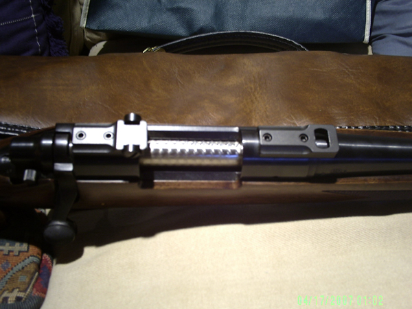

Is the scope mount standard?

Does that look like a standard mount to you that most scopes will fit on? I have lots of gun experience, but almost none with scopes.

The "bases" (in the picture) may be Redfield or Leupold. I have some of each on a couple of 700s, but I'm not sure which is which. One of them looks like the one in your picture except mine are on long action 700s.JDNC wrote:Does that look like a standard mount to you that most scopes will fit on? I have lots of gun experience, but almost none with scopes.
You would only need to get the 1" rings that correspond to the bases. You'd need the type that "turn in" (front) and then the two opposing screws on the back bases secure the rear rings.

When you get the rings, you'd need to determine which "height" you'd need.....low, medium or high. Mediums seem to work best for me. Lows can be too low and you're scrunching your face to the stock and highs can be too high and you have to take your head off the stock to look through the scope. Depending on which scope a person uses, there can be issues with mounting a scope with rings that are too low.
Also, when I mount a scope, I adjust it front-to-back so that when I bring the rifle to my shoulder, my head is vertical and I'm not "crawling the stock" (too far forward). I also adjust it so that there is sufficient eye relief to the scope and that the cross hairs are "clear" (in focus) against a blue sky.
