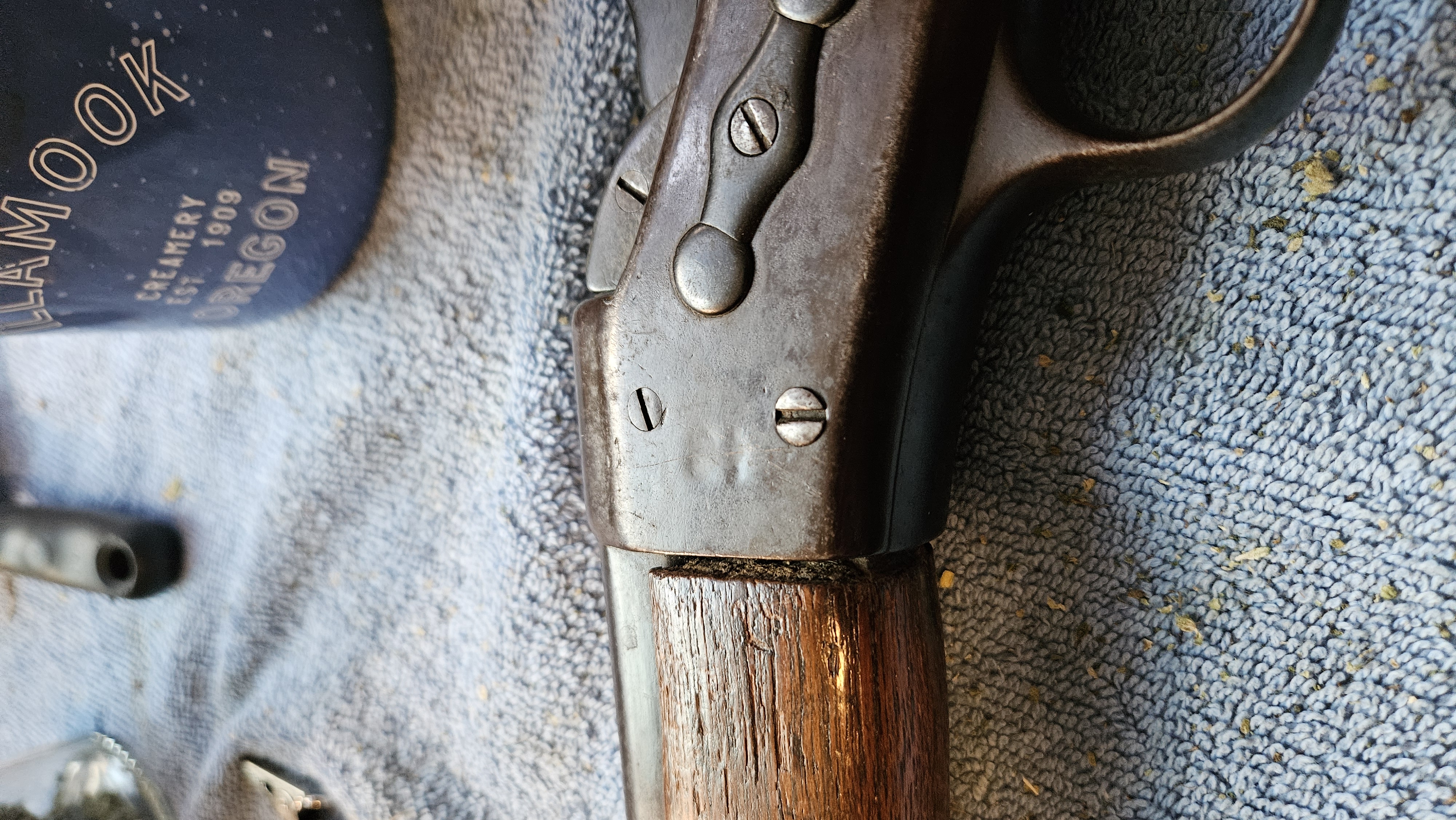

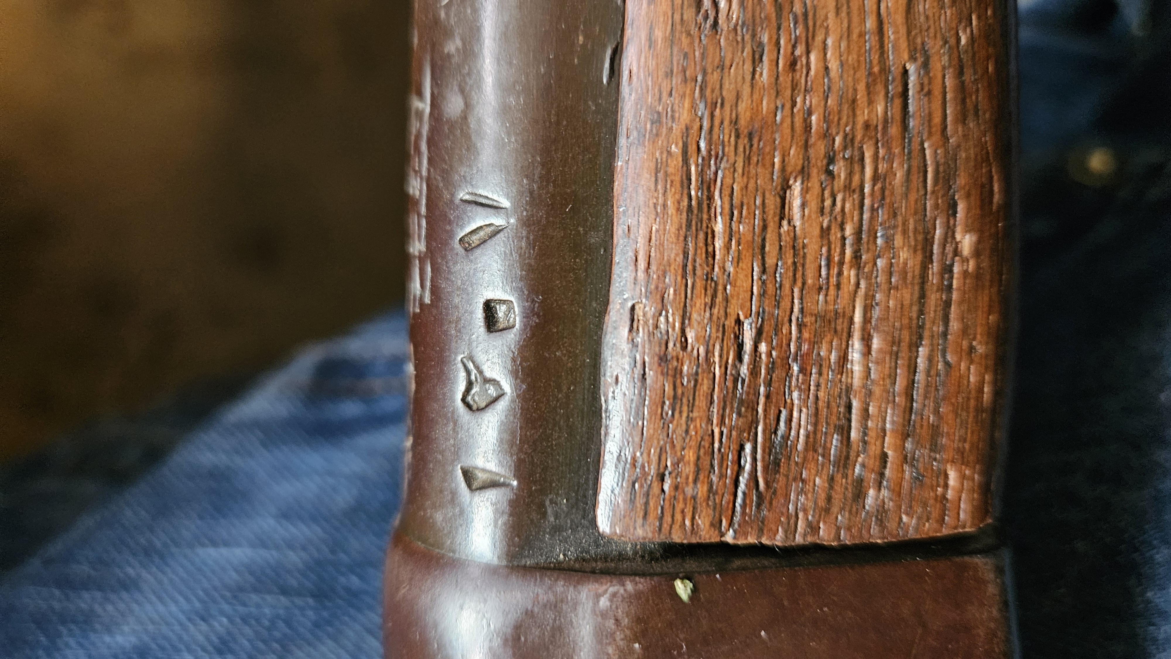

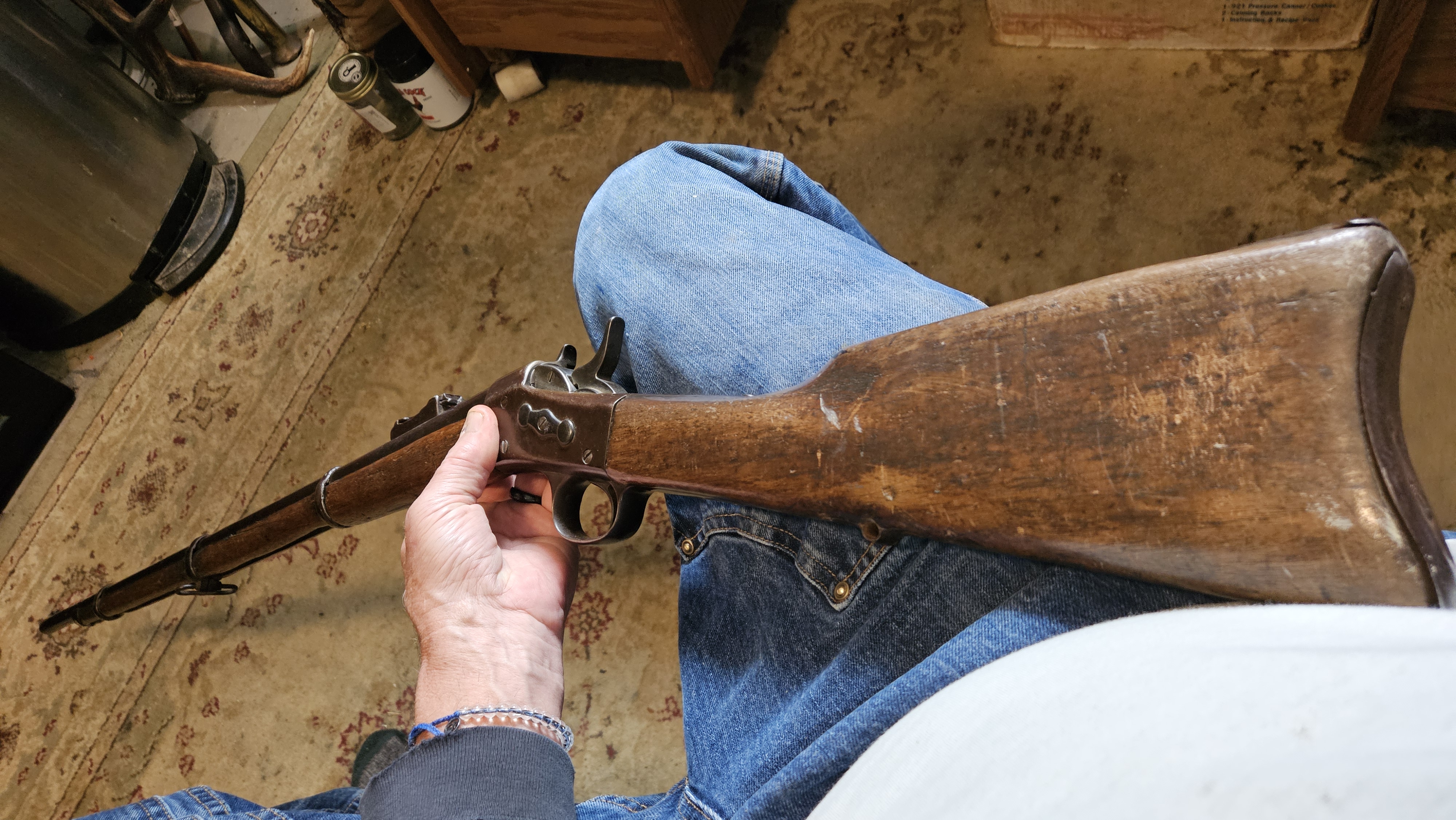

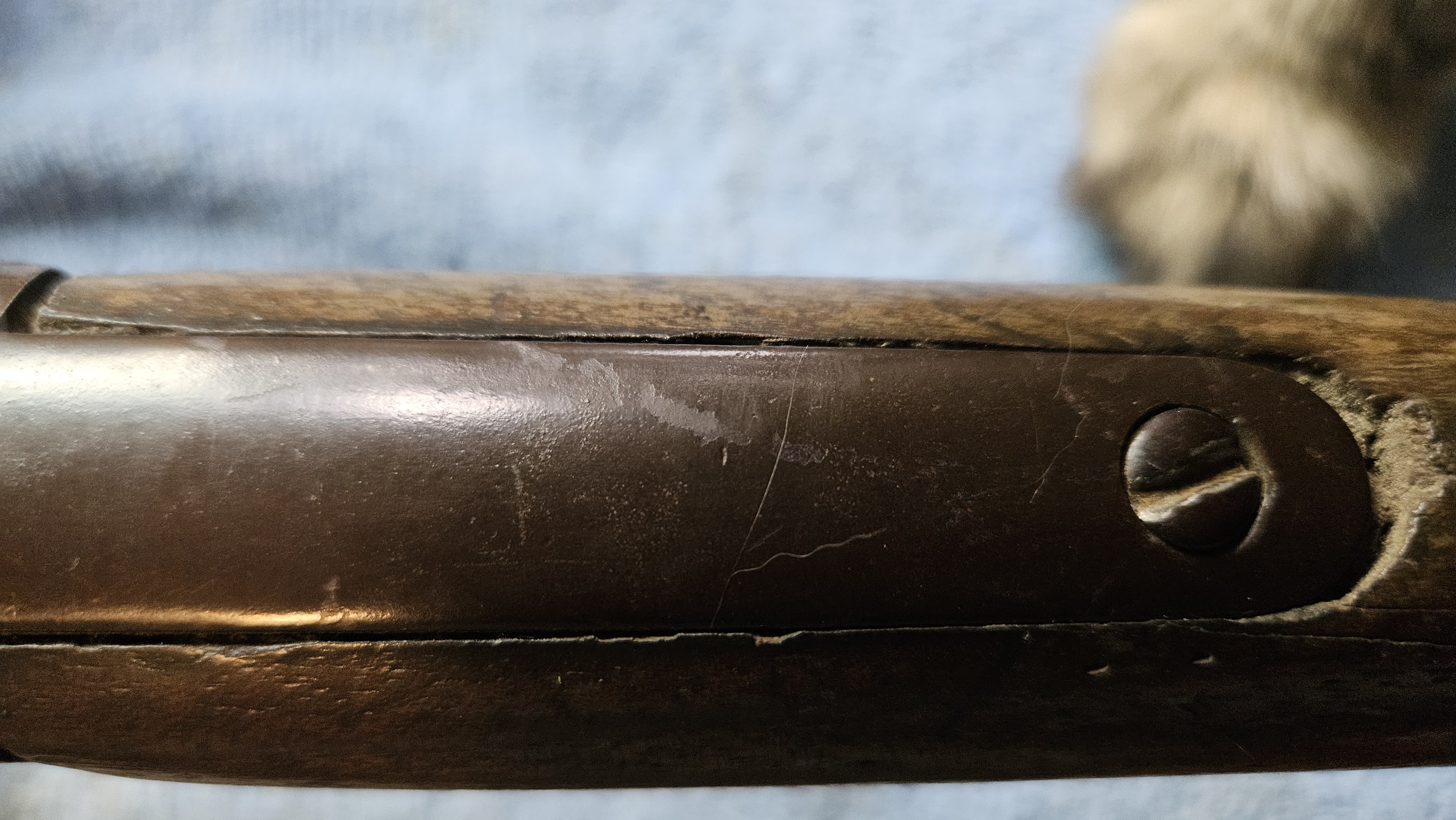

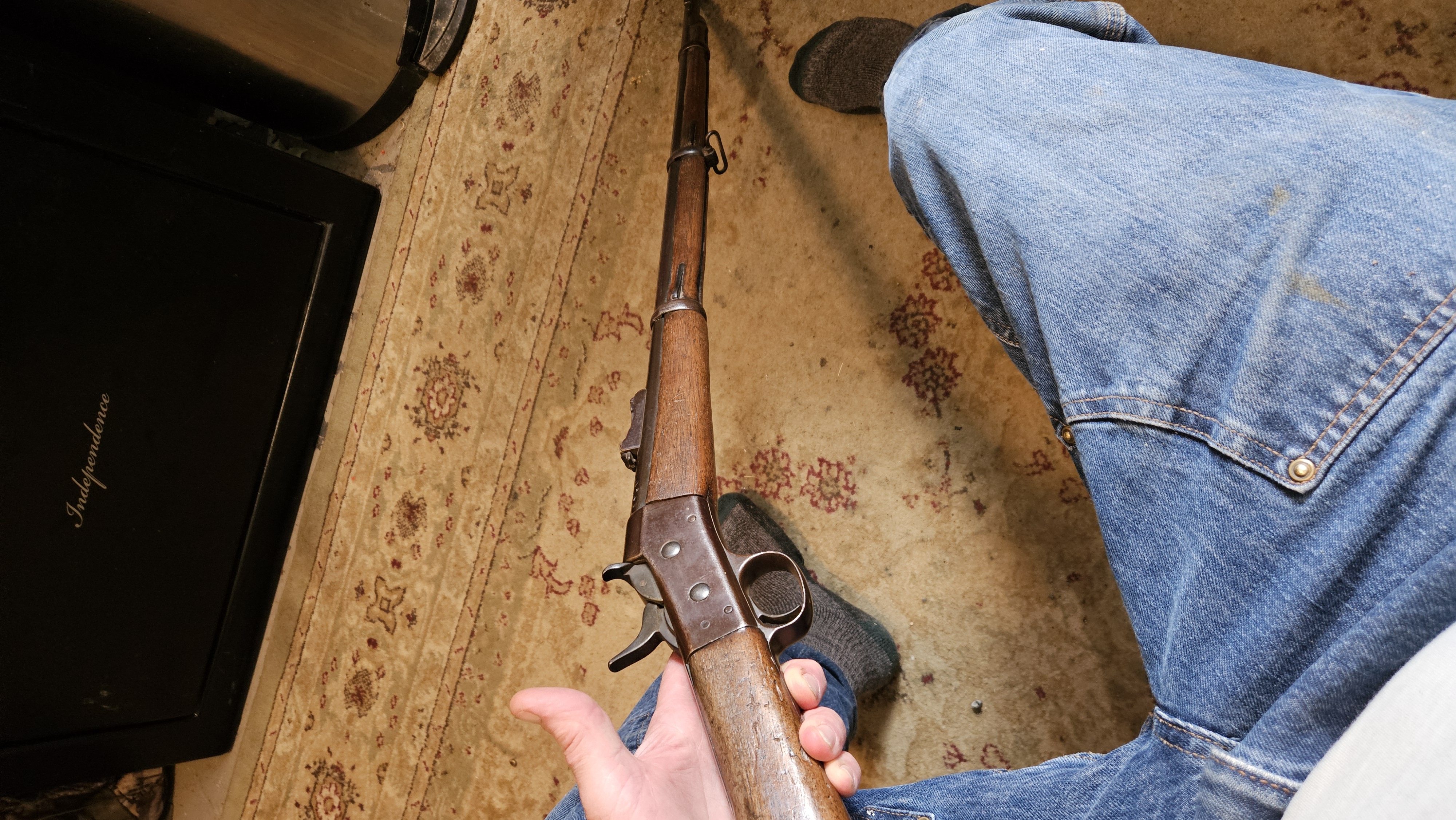

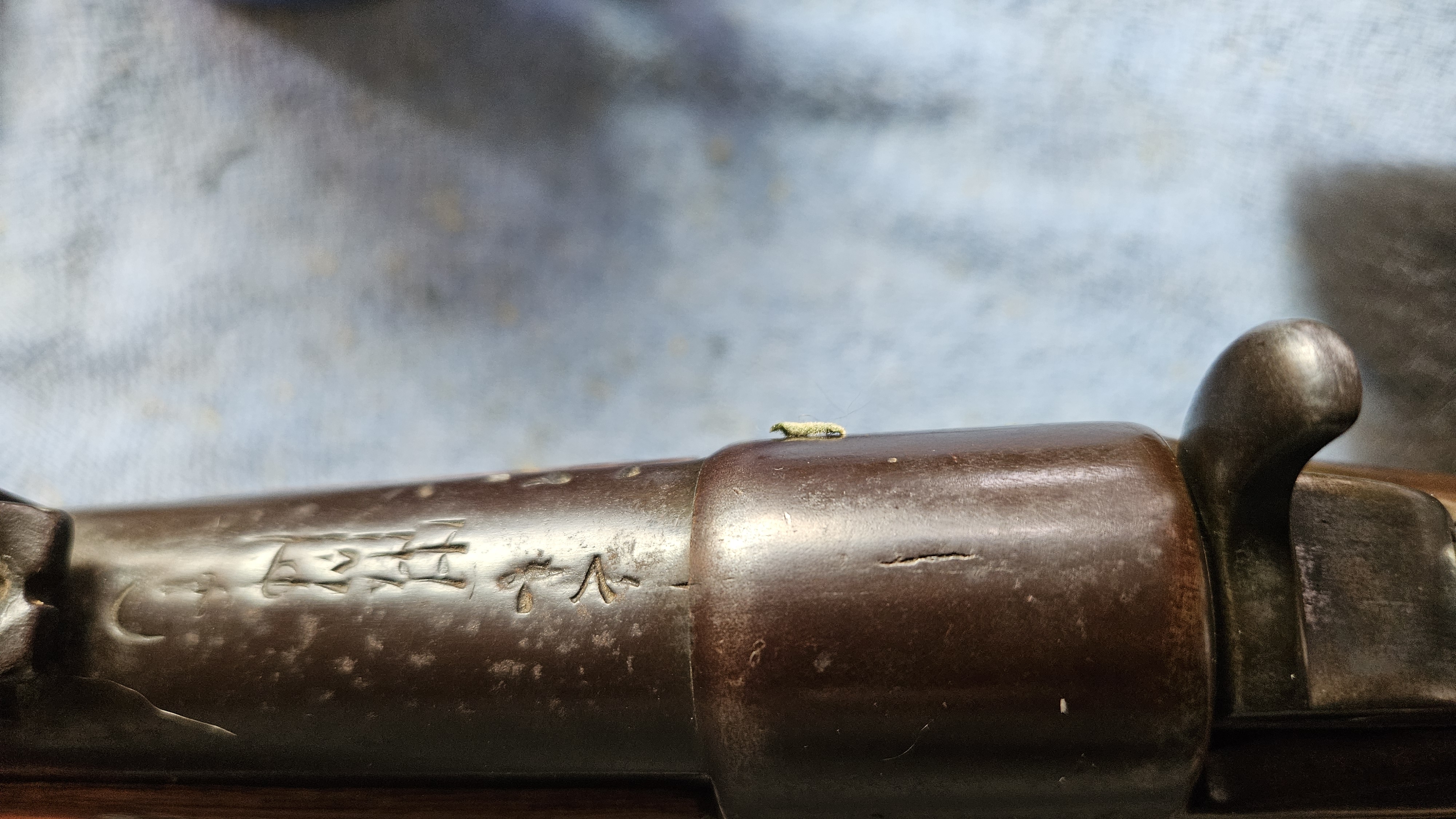

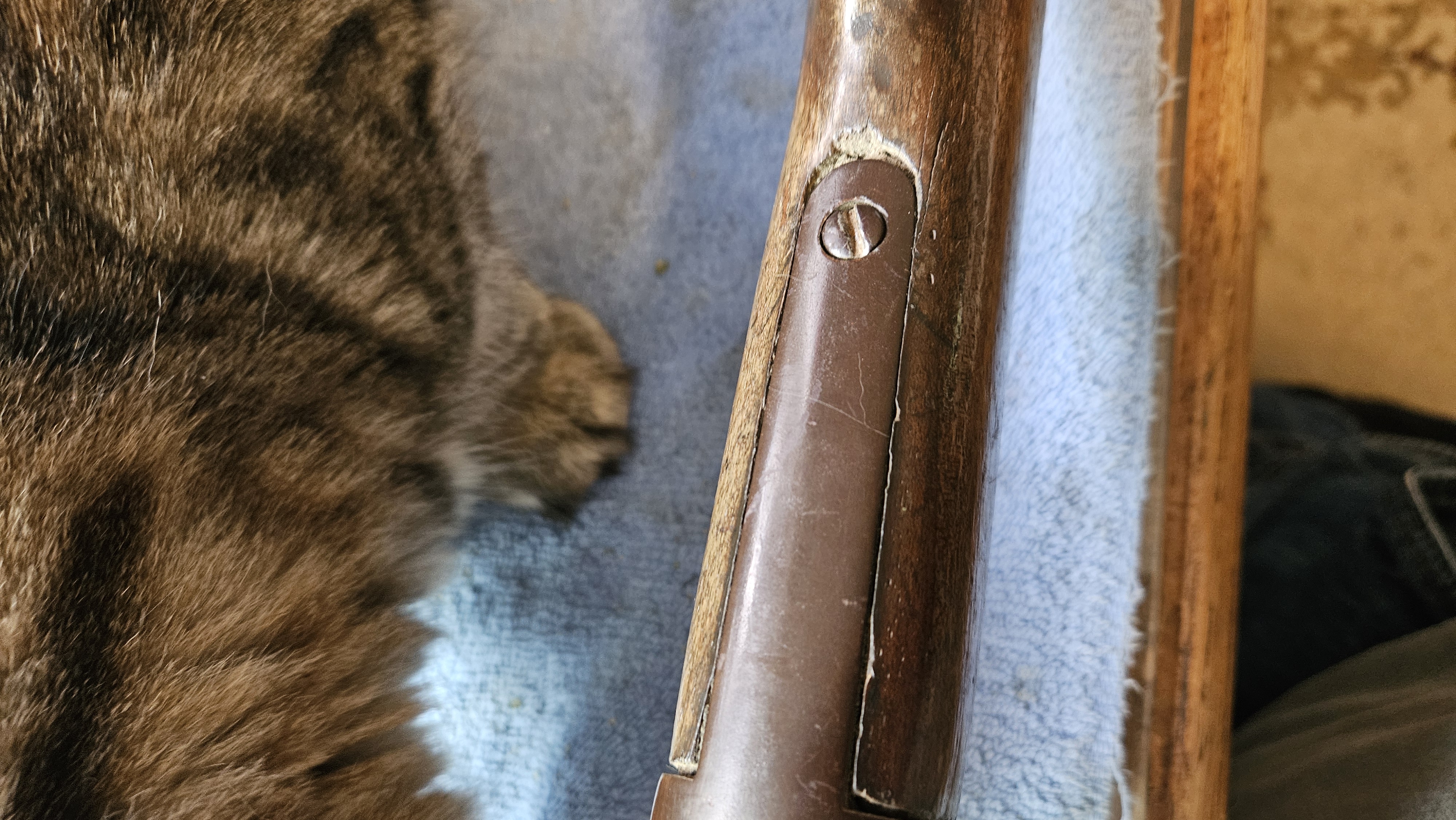

Can anyone help me ID this rolling Block rifle. And maybe it's value.

Post by marlinman93 »
From the stamps on the barrel it appears to be an Egyptian Rolling Block. The wear on the receiver tells me it's seen a awful lot of handling since all the original sharp edges are now rounded over. Likely it's in the .43 Egyptian cartridge, and tough to say a value without knowing the bore and chamber condition. It could be anything from as low as $150 to maybe $350 maximum with the extreme wear if the bore is excellent, which is highly unlikely.
