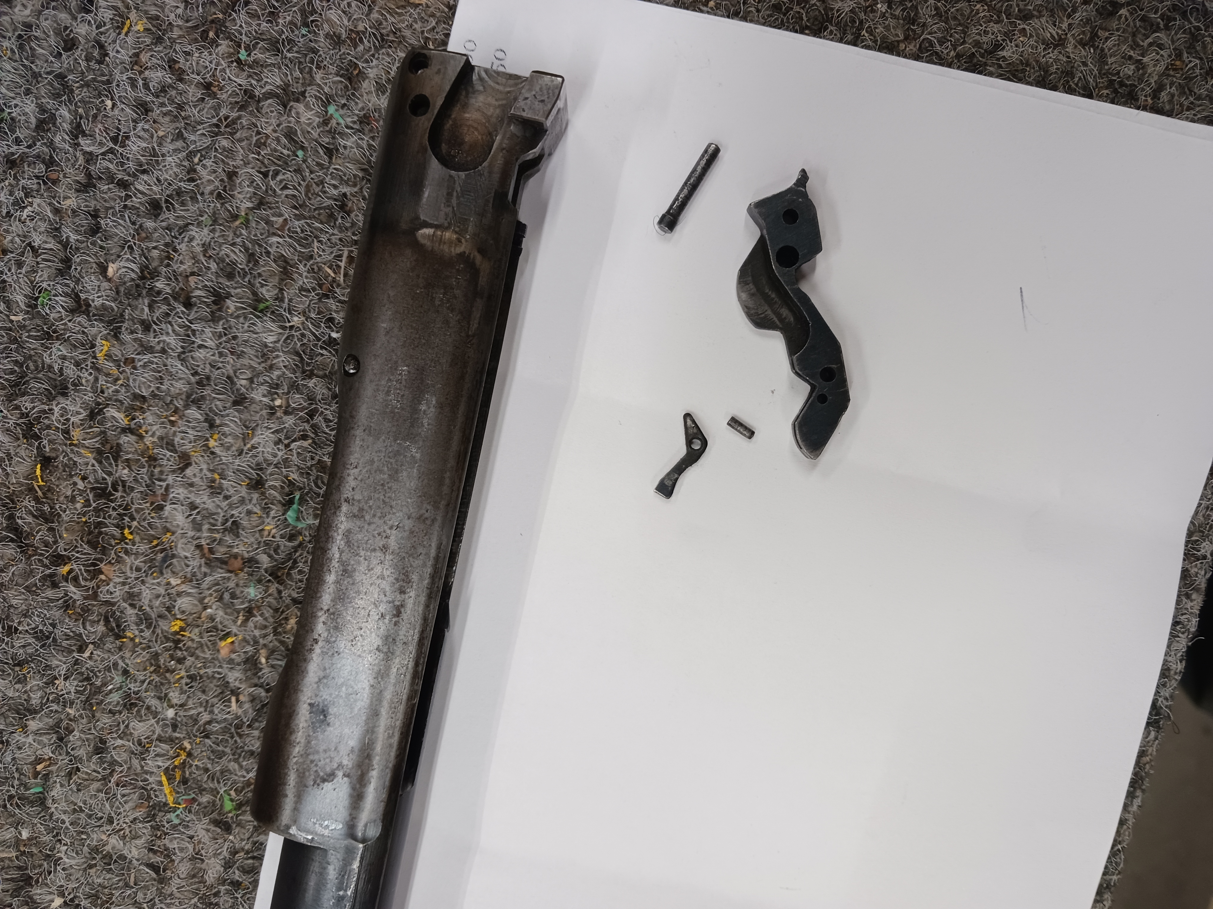

Trying to figure out if I have all the parts and how to assemble the carrier group in a Rem Model 14 in 32 rem. Could someone please post a couple pics showing all the parts and then there orientation in the pinned position. Was able to find references and videos on line but they all seem to blow right past the carrier group. The picture is what I have to work with. I have looked at the model 14 schematic and am pretty sure I am missing a few parts. Thanks for any help.

Yes, you are missing a tiny spring that goes with the parts group you show in the photo, you are also missing the spring/friction plunger that fits into the hole on the side of the carrier..............they came in two sizes. You asked what you are missing, that's what you're missing, and good luck assembling them into a working carrier.
I will offer up a personal opinion here and that's if your rifle is missing just those parts you're lucky but usually when you see something like this it's the "tip of the iceberg"!
