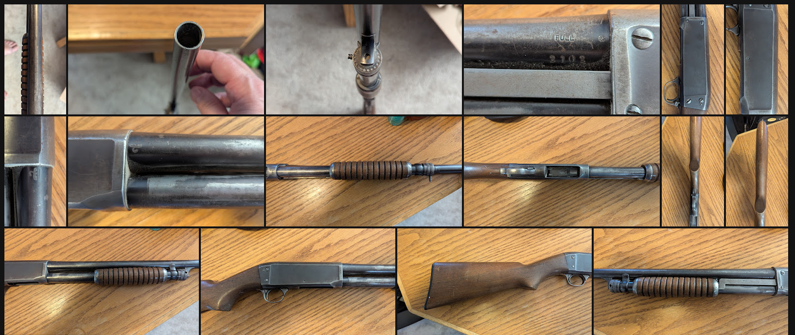

New Member - I have, what appears to be a very early Model 17. It is marked "The Remington Arms Union Metallic Cartridge Co Inc" Model 17 (top of barrel) with low 4 digit serial number (21xx) and no reciever side markings. patent date June 15, 1915 with B0 above the serial number. It is marked "FULL" on the left site of the barrel above the SN with a small "sun" stamp near the reciever. It also has a "REP" stamp in an oval with a small circle below (or partial - appears to be offcenter stamping) It appears to have the 28 inch barrel (measured 27" from barrel end to reciever - not disasembled yet) It also has a "REMINGTON UMC" buttplate.
I have reviewed other posts and have found bits and pieces of info but nothing definitive on date. Some of the info seems to indicate the very early ones may be impossible to accurately date.
Condition - Still fully functional but well used. Appears to be all original and NO restoration attempts.
Trying to determine manufacture date and value.

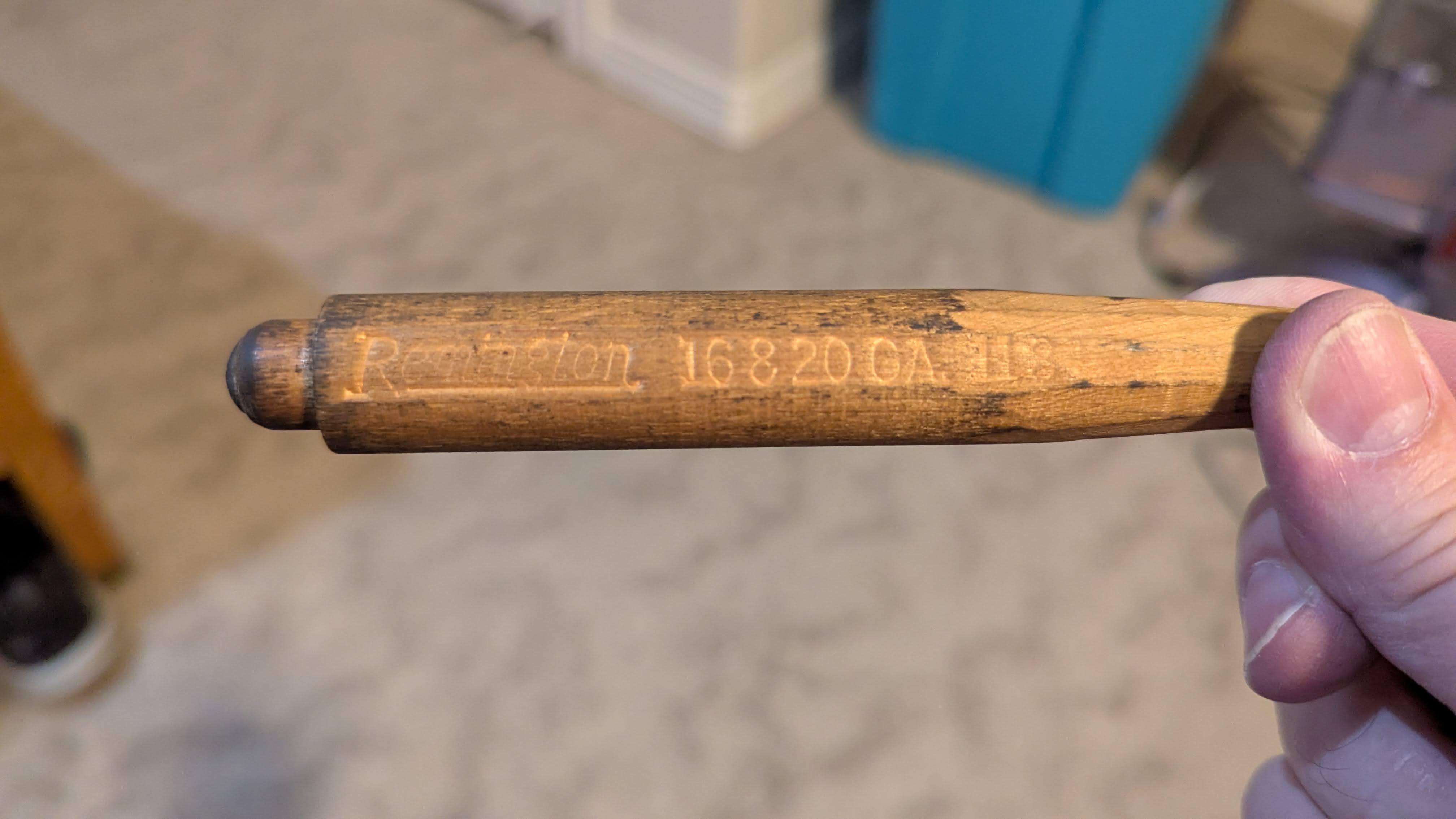

I removed the barrel and did not find any other markings. I did find two other interesting things....
When I pulled the barrel and removed the retainer cap I found a piece of wood in it. At first I was like, that is odd. I pulled it out and it actually has Remington markings on it - What is it?

- the wood piece
- Remington Model 17 part.jpg (3.5 MiB) Viewed 9632 times

Re: New Member - Early Model 17 identification
That is the magazine plug, it limits the capacity for hunting legality.
Thanks for the additional info.
So if I am not hunting with it, can I remove it? Is it that easy or is there something else to do to increase the number of shells it will hold?
It's just for hunting purposes, removing it should not be an issue. If you live in an anti-gun jurisdiction there might be some local reasons for leaving it in, a call to your gunshop should inform one way or the other. No other way to increase magazine capacity.
