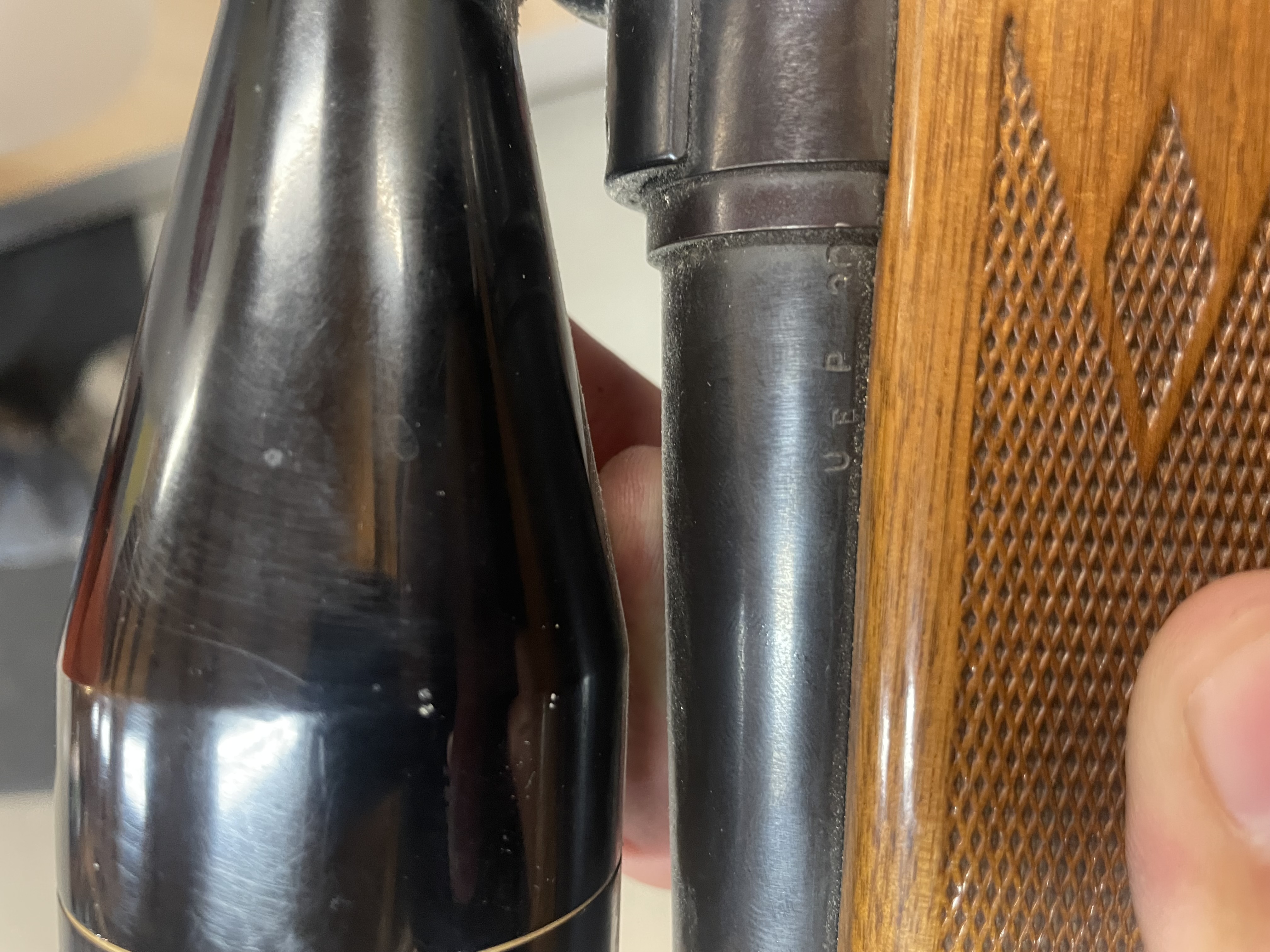

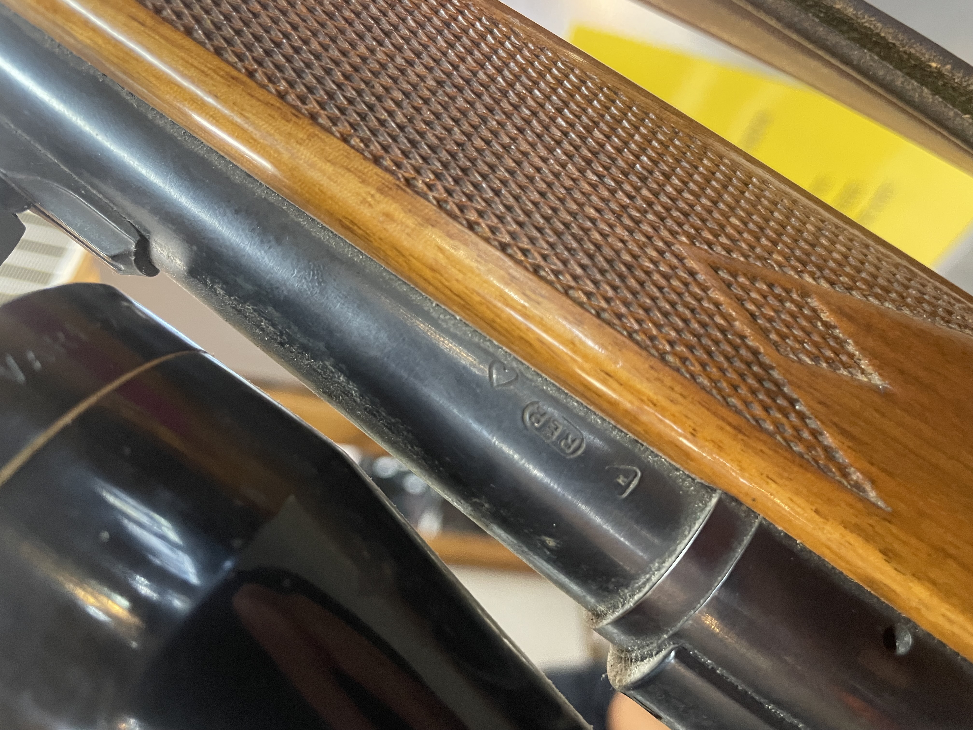

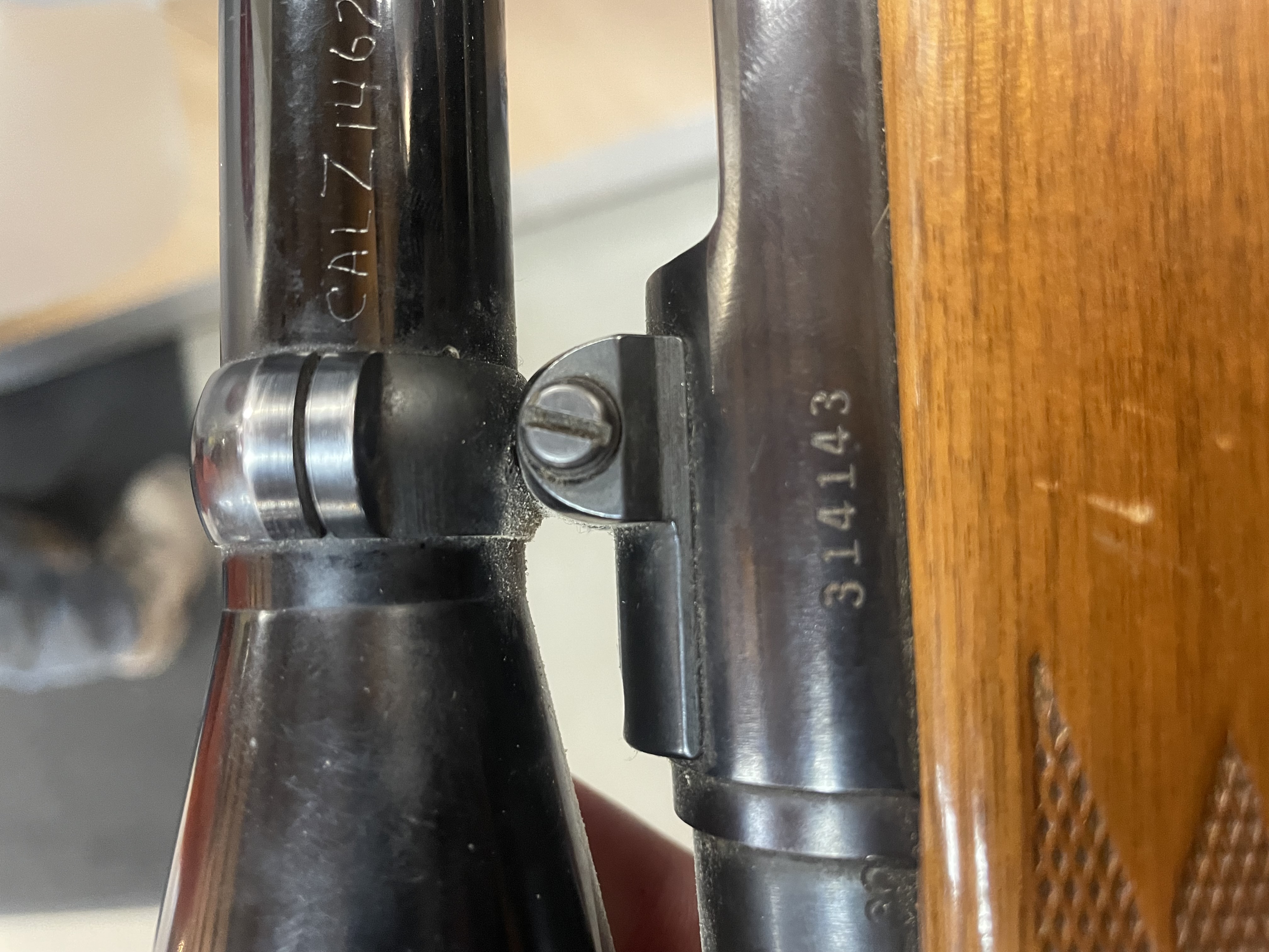

Recently acquired this rifle as far as I can tell from what I’ve read it’s an early model ADL. Mostly intact other than the buttstock. Serial is a 6 digit 314143 number. Someone engraved Calz146287 on the scope, receiver and stock which is unfortunate. It’s chambered in 30-06. If anyone can help me date or give me info on this rifle it would be very much appreciated. Thanks in advance.

Everything you need is on the left hand side, U E P 30 / 314143.
U is the symbol of the final inspector
E stands for October
P stands for 1967
30 is the symbol for the assembler
314143 serial number confirms the year 1967 when compared to others in the same range
Stock checkering confirms ADL
