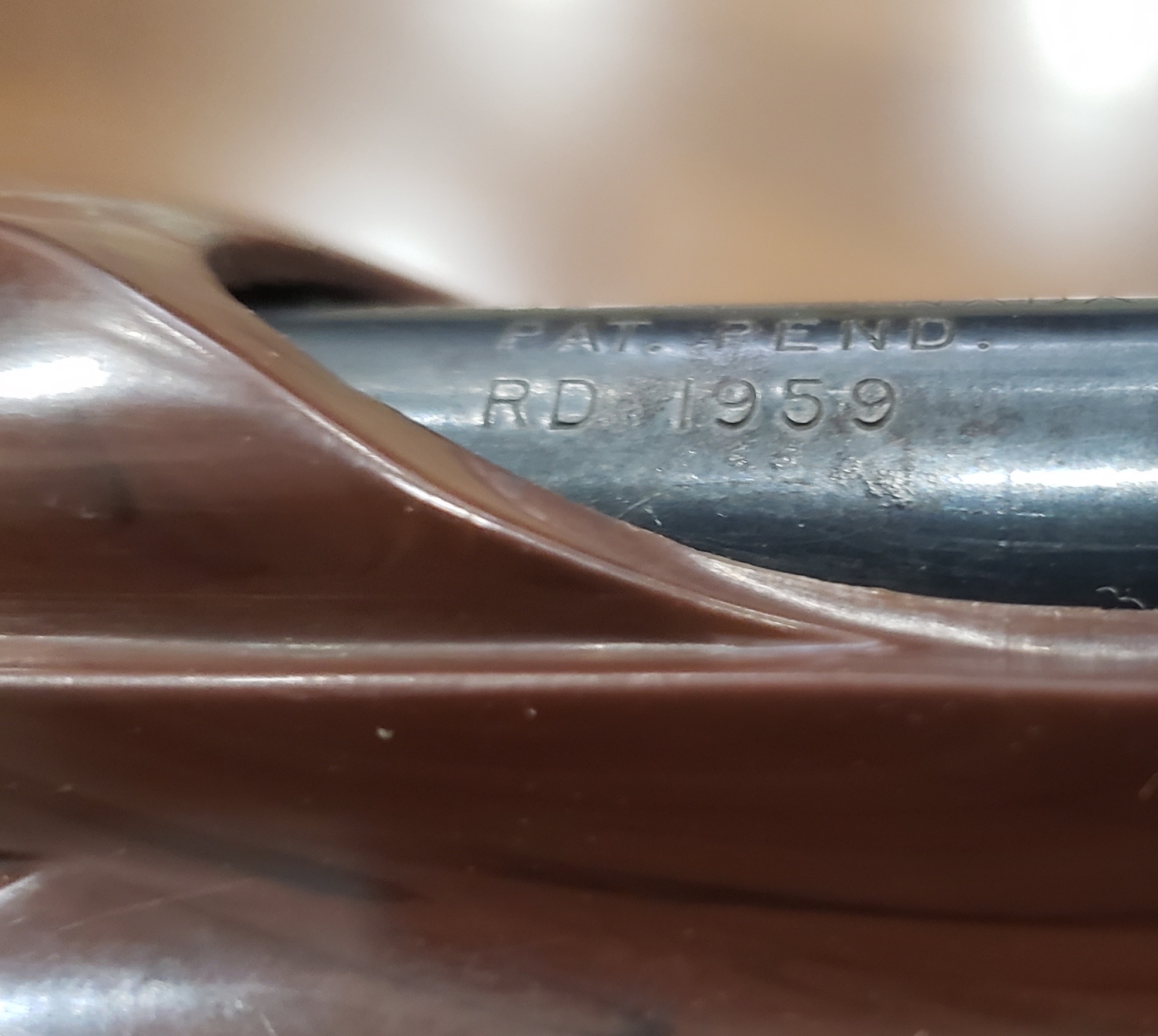

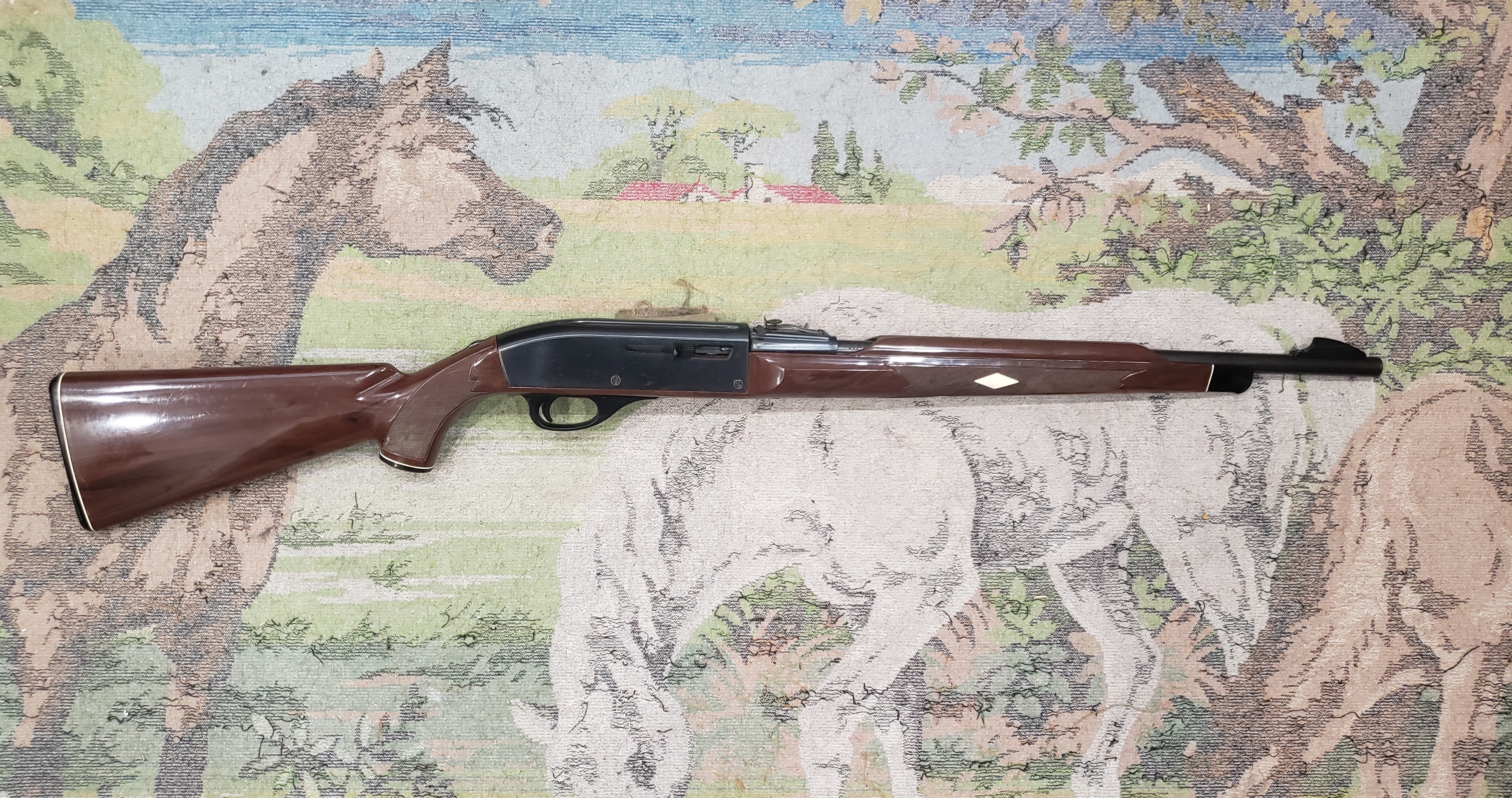

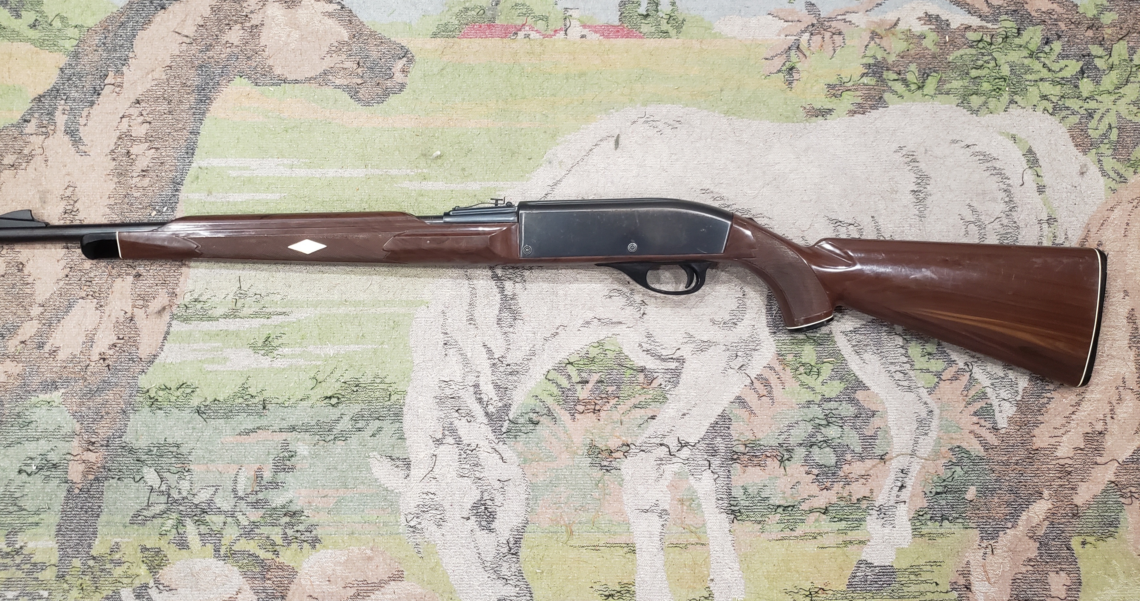

Hi all ,
Recently picked up an early decent condition Nylon 66 MB.
Was just curious on dating the rifle.
It doesn't have the common barrel date code ie: 2 letters but does have an actual date-
1959.
There is an RD preceding this but that would put the date at 1957.
2 years before production.
Is this simply a first year (1959) rifle.
Thanks in advance

Re: Dating a Nylon 66
Fair pictures, but we need one of the top of the barrel ahead of the rear site. RD is not a date code

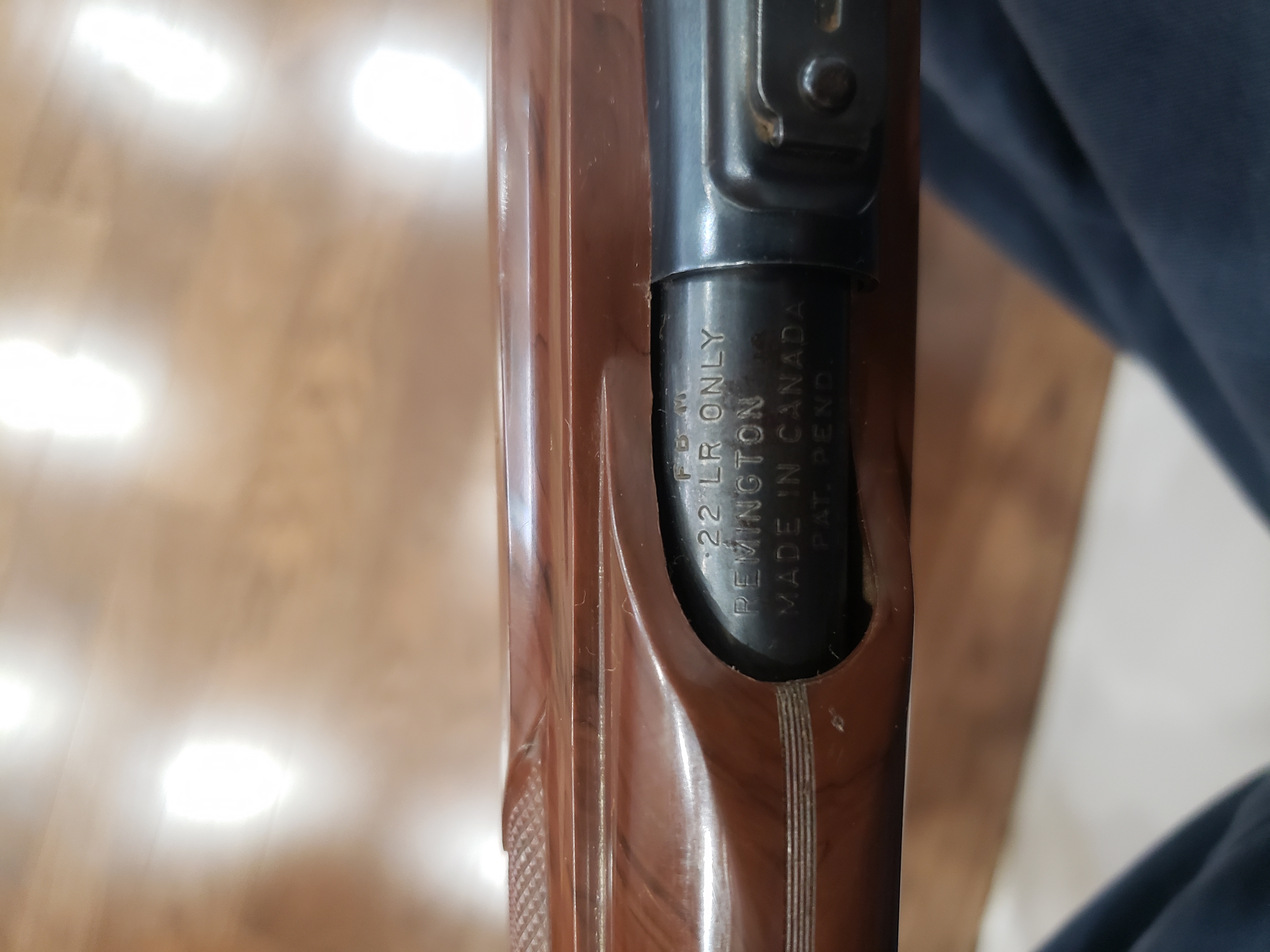

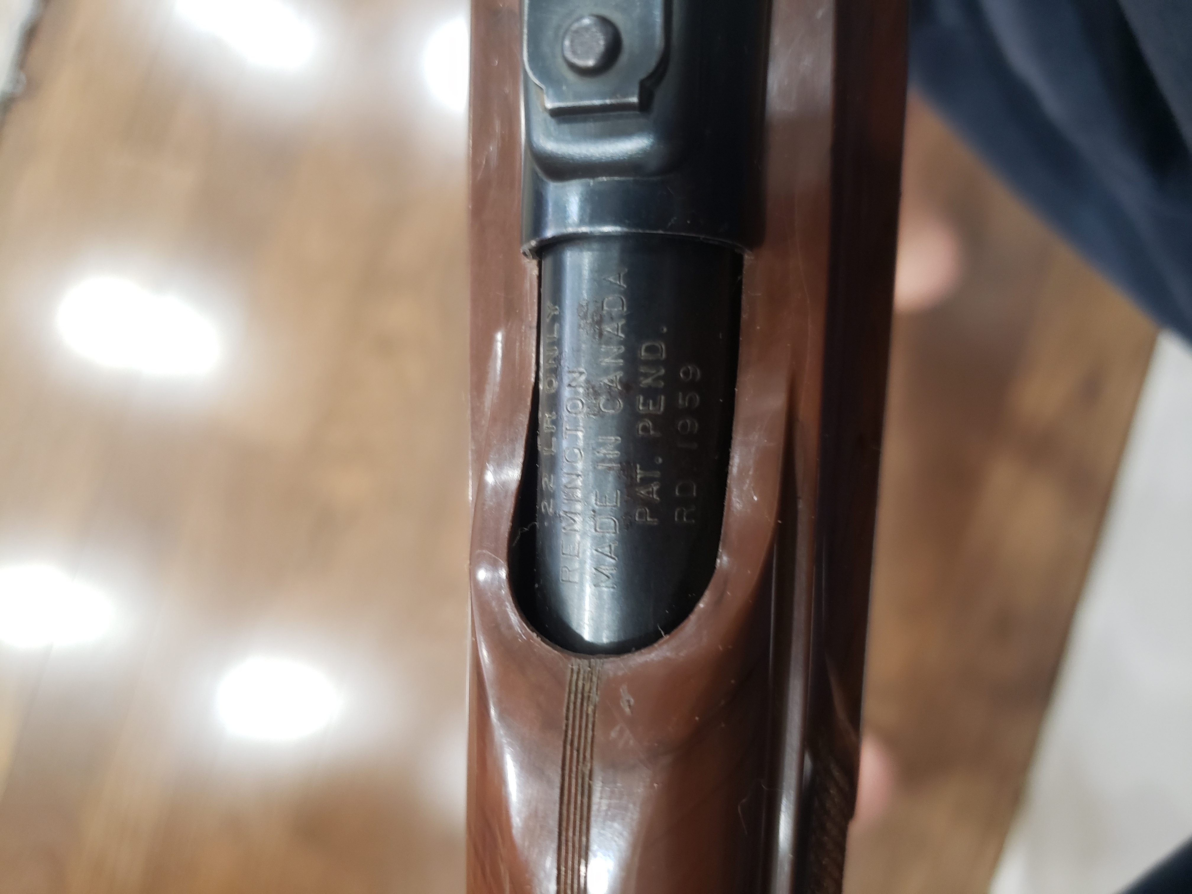

Ok,
Here's a couple more pictures
Is that the date code at the top?
I always thought they were on the left side of the barrel
The Made in Canada stamp changes things a bit. The rifle appears to have additional stamps, these might be a Canada only method of marking and cataloging. Most of the Canadian made rifles happened in the 1960's, the 1959 stamp might indicate year but I just don't know enough on that topic to say for sure.
Is the first letter an F or a P? Look close for incomplete stamping
I think you're right.
Initially I thought it was an F but I think it could be an incomplete P
I think maybe P as well. so...P B M
P could be June, but B is 1955 and there was no rifle model to assemble in Canada at that point. And the practice ended long before 1981. So that is out.
B could be January and M could be 1965. This is the only feasible solution. In this case, the P (and hell, maybe even F) is likely the assembler-Stamped opposite of what happened normally.
I'm unaware of exactly when Canadian stamped rifles stopped being produced but it may well have been into the mid 1960s
So we are looking at a 1965.
I'm inclined to agree.
Would have been nice to be a first year model though
After further research it appears that the early Nylon 66's (1959 - 1967) assembled in Canada all had the 1959 stamp on them.
This wasn't a date but a model reference number they used for these rifles.
