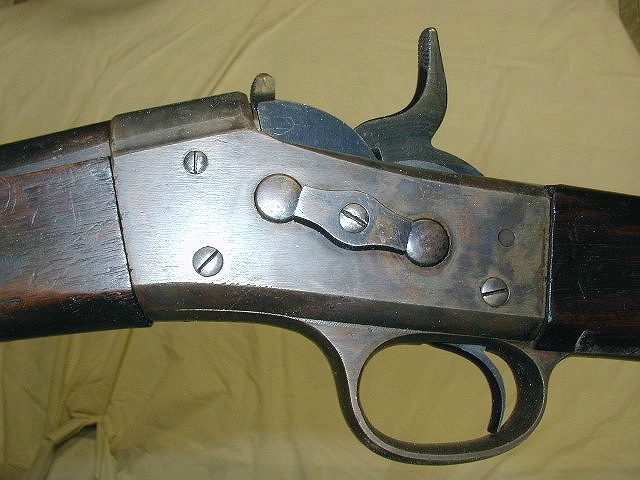

Acquired a No 1 Musket (3 band) in 50-70 that has no Remington Address or Patent Date on the barrel or the tang
There are only these markings on the rifle:
* Remington Inspector 'P' on the barrel - receiver - trigger guard and shoehorn butt plate
* Lot number on the inside of the upper and lower tag. Not the normal repeating 10,000 block of numbers but 'F 97975'
* Armory Rack No on butt stock

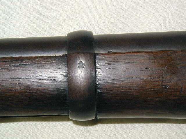

* Bands: Middle band has the normal forward 'U' and the 1st and 3rd bands have this mark that I cannot determine:
Anyone know what this mark represents - inspector, country or ? (white paint applied to sharpen the mark)

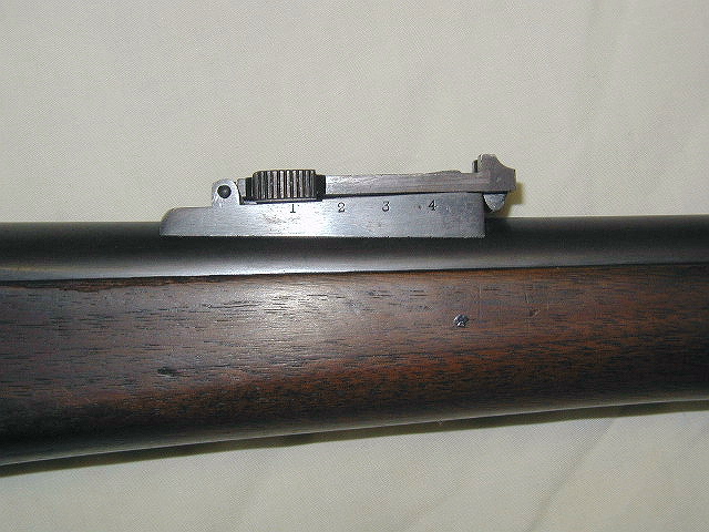

* Argentine type sight but with an extender in the staff that can be raised to 1600yds

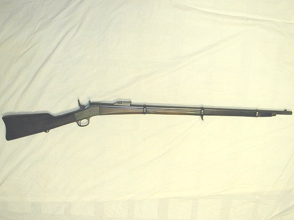

Have a question for you. The full lenght photo you have is not to clear, does the forearm have a barrel band spring at the middle barrel band. Also does the rifle have a slide extractor that is fitted in a milled slot along the left side of the barrel at the breech or a rotary type extractor that is fitted to the breech block.
Have a good day,
Matt
John Boy
Re: No 1 (50-70) with No Remington Address or Patent Date?
Post by John Boy »
Matt - answers to your Q's:
1. The 1st and 3rd bands are spring -loaded barrel bands
2. Yes - a slide extractor that is fitted in a milled slot along the left side of the barrel at the breech

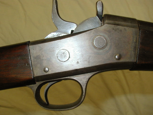

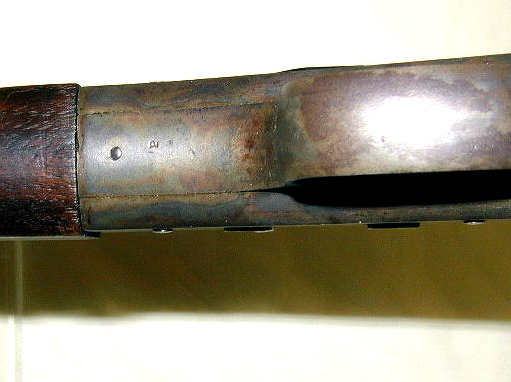

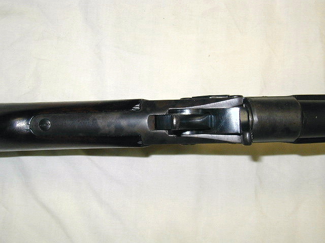

Here are some photo's of a gun in my collection, it is the same type as yours. The gun is in mint condition, with very good case coloring on the receiver and bluing on the barrel. The rack number on the butt stock is 125. The forearm has no barrel band spring for the middle barel band. The rear sight is the type used on the Argentine rifles.
I believe that Remington may of taken some rolling block rifles back in on trade and made new rifles out of them. I know when Remington got the order from New York State to make the Model 1871 rifles and carbines, that they agreed to buy back about 5000 civil war pistols and muskets from the State of New York to seal the deal.
I believe the rifles were stripped down, the receivers were then repolished removing the Remington markings found on the upper tang before they were recase colored. Then new 50-70 barrels were put back on the receivers. My gun before it was coverted had the side extractor, now it is set up with the rotary extractor.
See next post for more photo's

Hello John Boy,
Here are more photo's of the rifle.
No markings on upper tang
No middle barrel band spring
Has crown on 1st and 3rd barrel band
Have a good day,
Matt

What is your lot number on the inside of the tangs? This one is ... F 97975
The two punch marks after the 5 are not on the upper tang. They also don't appear to be pit marks from the casting because there are no grinding marks on the edges of the two dots

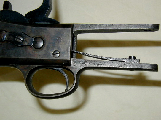

Hello John,
Here are some more photo's of my gun.
The upper and lower tang numbers are mismatch, the top is 19509 and the bottom is G 85365
The bottom of the trigger guard has a "P" for Proof stamped on it

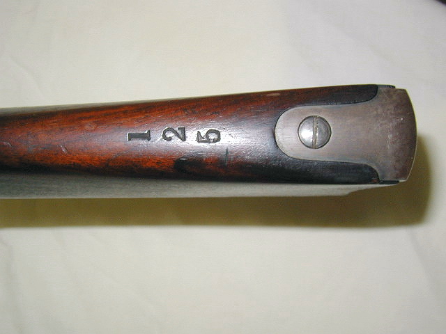

The rack number on my stock is in the same place as yours. The numbers are approximately 5/16" high.

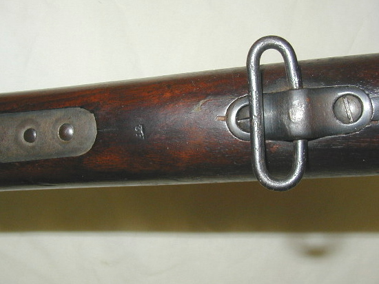

On the bottom of the butt stock is stamped "H2", don't have any Idea what it could stand for.

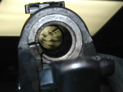

Here is a photo of the bore, it is in mint condition and shines like a mirror.

* Rack Number - your 125 and my 220 had to go to the Michigan State Troop contract. The no 2 is the same die stamp

* ...tang numbers are mismatch, the top is 19509 and the bottom is G 85365 - It was my understanding through Don Muno and my historian friend, Bill Roth, that the numbers were always the same. I'll get Don's telephone number and ask him about mismatches and get back to you with his answer.

* ... the butt stock is stamped "H2", don't have any Idea what it could stand for. -Mine does not have this type of stamp anywhere on the rifle. Here is a possible answer to your 'H2'. Take a look at the Michigan State Troops Website. There were 2 Regiments formed (1872 and 1874) and in each Regiment there were a Company 'H' What the '2' signifies - a guess ... Platoon or their subdivision of a Company?

As for the tang numbers being mismatched, this happen a lot when rifles were dismantled. The
parts were usually not keep together to be refinished and reassembled at a later time. The parts
were put in bins of the same type. May be your gun used a newly made trigger guard and they
stamped it to match the upper tang. Have a couple of guns in my collection that were sent to
France for the Franco-Prussian War. After the War, Belgium bought some of the rolling block
rifles and converted them from .58 caliber to 43 Spanish, and the tang markings on these guns
don’t match.
Would like to hear now the rifle shoots for you. I think that the Argentine rear sight is a far
better sight then found on other rolling block rifles. Must be nice to have a rifle range out to 600

I was wondering if the number “2" on your gun matched the style found on mine.
The '2' on yours and mine were punched using the same die. My rack number picture is posted up the thread.
