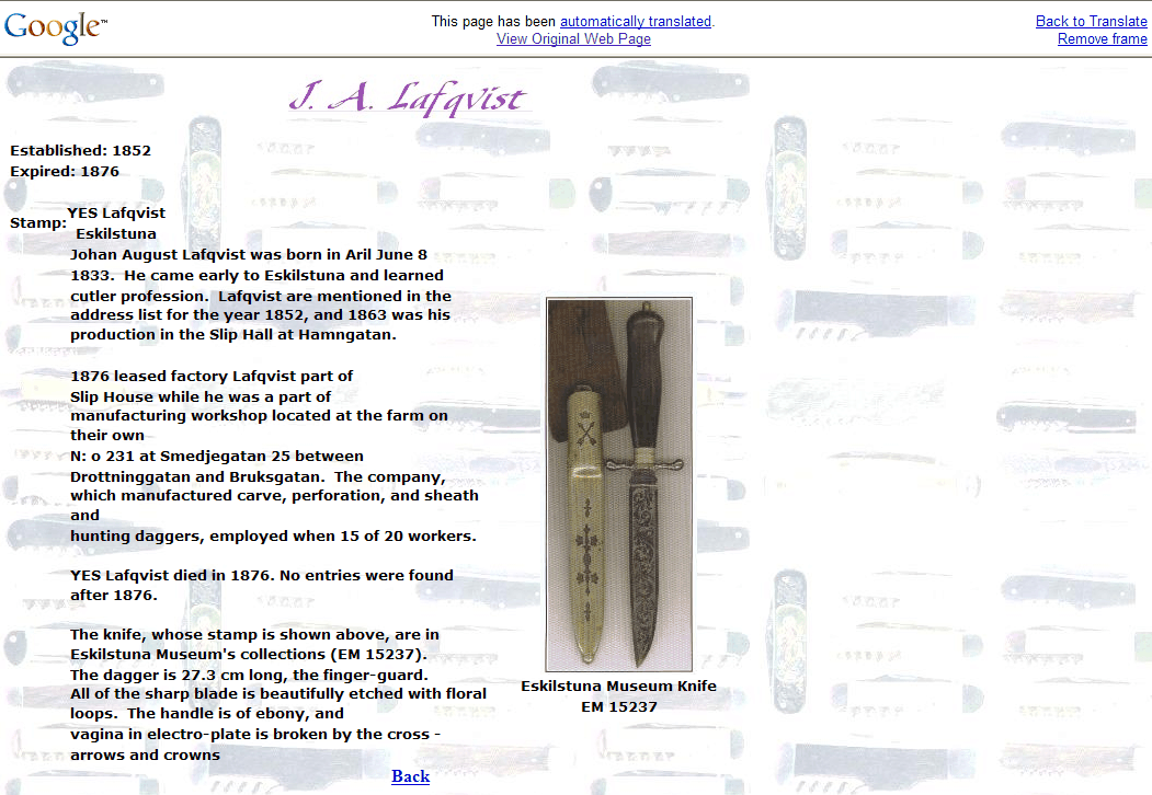

Here's all info I have (in Swedish from Eskilstuna museum) on knife-maker J.A. Lafqvist
http://web.telia.com/~u16502260/tillverkare/sid127.htm
except he was also member of the city hall a few years before his death 1876.
I've seen his knifes turning up now and then at (web) sales in Europe

Welcome Erik! That's a beautiful knife, obviously built by true craftsman! Wish I could read Swedish so I could read the info!-Vall
oldremguy
Posts: 221
Location: Rochester, NY
Re: Help with roller from a newbie
Post by oldremguy »
Hello Vall,
Here is a translation about the knife
ScreenHunter_01 Feb. 26 19.49.gif (235.43 KiB) Viewed 6374 times
Have a good day,
Matt
