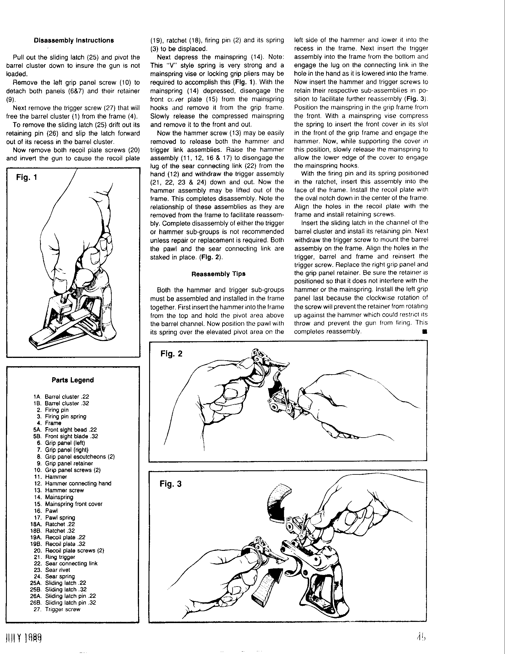

Are there any sources for instructions for assembly/disassembly of the elliot-remington deringers? Take down? parts lists? breakdown diagrams? I am especially interested in the 22 cal. but others would be helpful. Thanks in advance. Maybe one of you owners has detailed pictures of the internals...

Yep I believe I have most of the above and probably do have detailed pictures of the internals but doubt I could even find them anymore. I also have a diagram of the tool I made with specs to put a elliot or ZigZag back together, but frankly I would recommend you DO NOT take out the hammer and leave the bottom half alone or your asking for grief. If you do take it apart I think I have more replacement springs because you WILL break it.
Let me go dig, the stuff is from the American Rifleman from years ago...

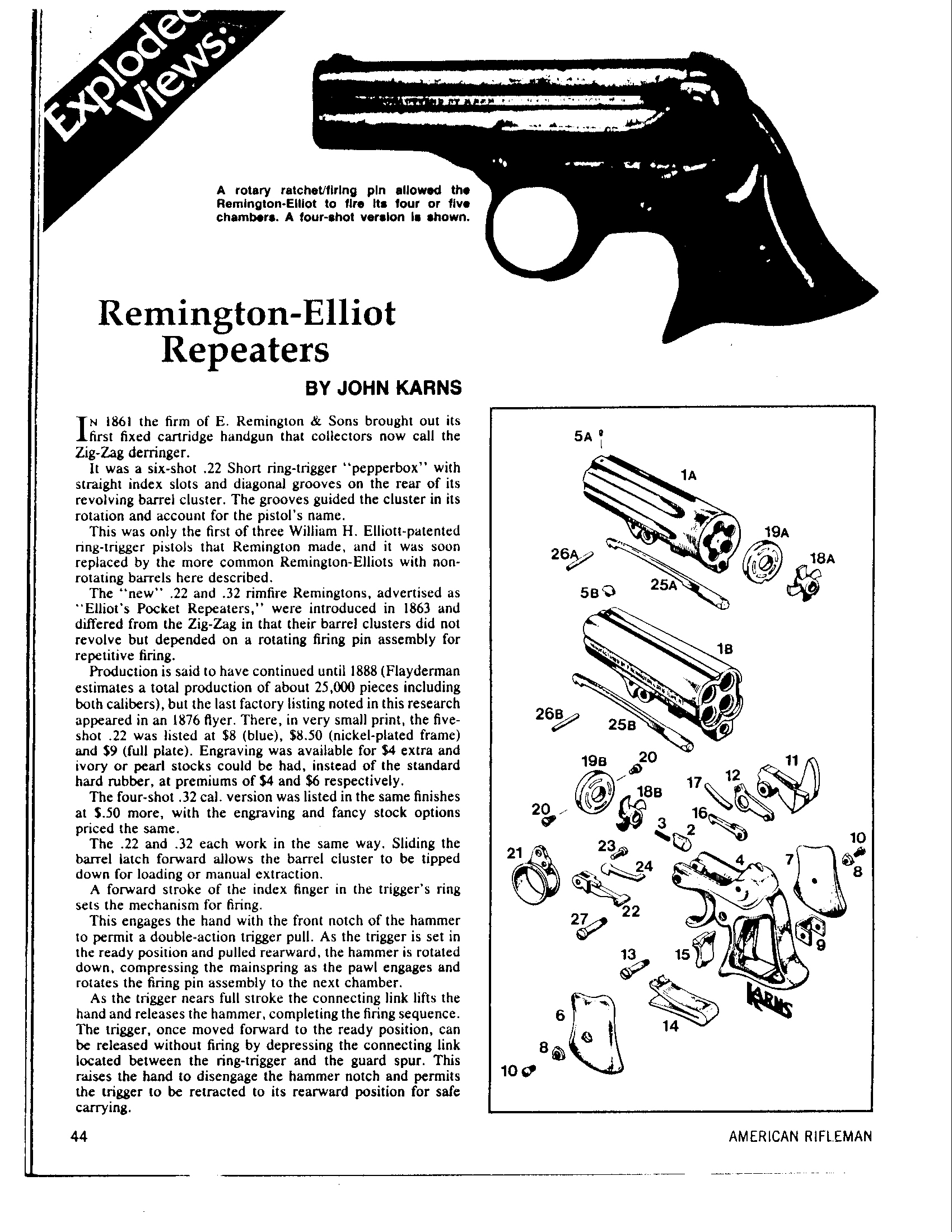

American Rifleman...
I have to scan my drawings of the tool.

Thank you David! It is just the kind of information I knew someone had. Thanks for taking the time to find it and then to post it. I appreciate it... a lot! :D
