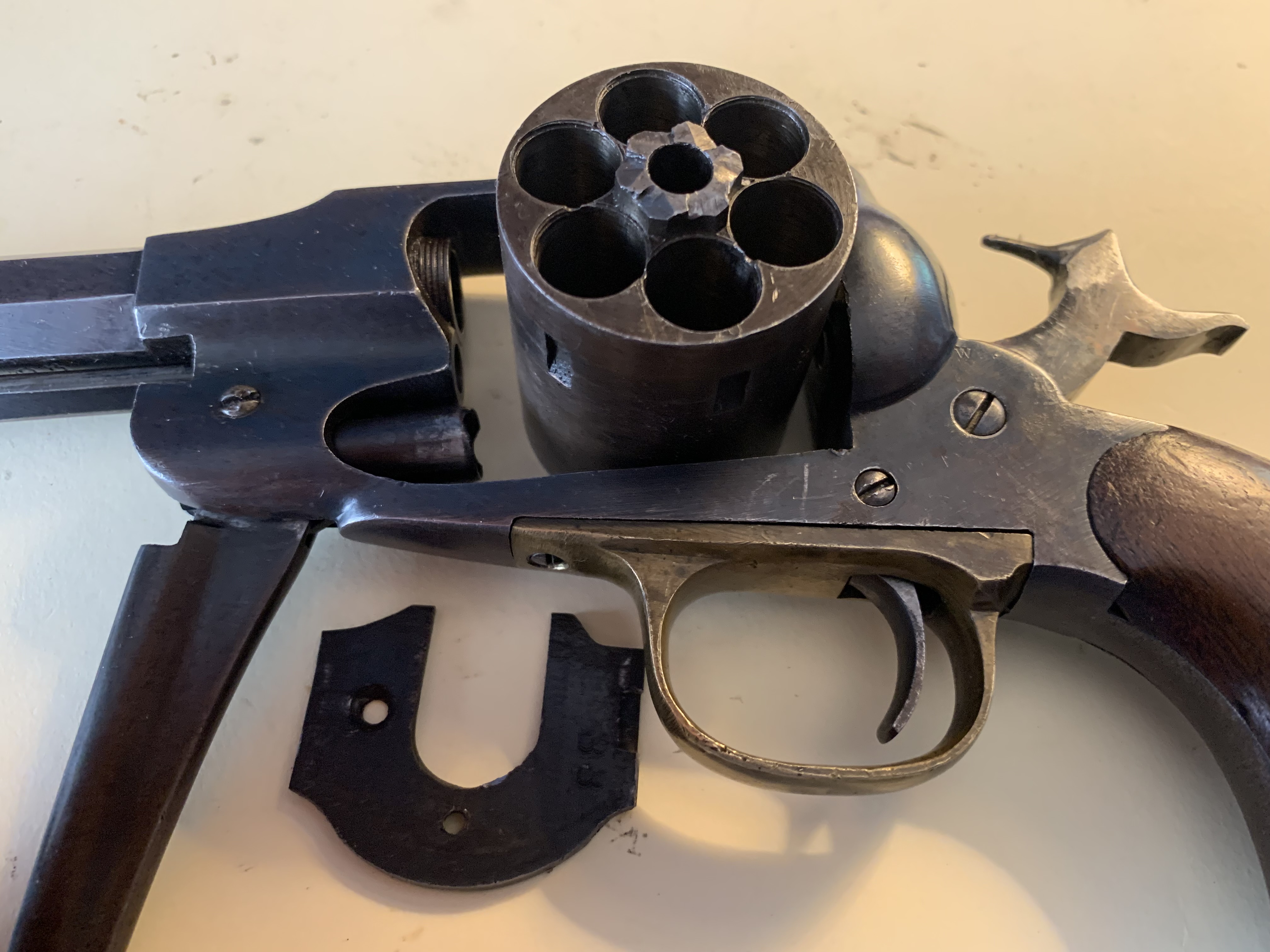

Have a NMA (S/N 86326) converted to 45 LC. Problem is that the rims overlap when loading which means I can only load 3 rounds. As shown in the pic slots were milled on the blast shield and a plate was installed. No other milling on frame as no loading gate was installed. The barrel, hammer, frame and steel plate are all stamped 33.
Cylinder seams to have had the rear milled off and new end for conversion pressed on.
Any comments as to who did the conversion and any means to correct loading issue?

DO NOT SHOOT THIS GUN!!
The cylinder walls are very, very thin, and the metal is 160 years old, and there is no way to know how much strength those thin chamber walls have.
This pistol was made in October of 1864. Are there any inspector's initials on any of the major parts of the gun? If so, it is US surplus, and may have been among the 15,000 to 20,000 NMAs sent to France in 1870-71.
It appears that this may have been done by someone who was more of a machinist than a gunsmith. I say that because a real gunsmith wouldn't have bored the chambers that large, or that off center, and weakened the chamber walls. It is not a factory conversion.
The gun could have been converted at any time in the past 160 years, and there is no way to tell when, where, or by who. There is no way to fix the problem of only holding 3 rounds. In a world of mostly percussion revolvers, being able to shoot 3x and reload quickly could have been more important than having 6 percussion shots with a slow reload.
That is a very interesting conversion, and it raises more questions than it answers. It also leaves wide open the reason(s) for the conversion, and the story behind it. Enjoy it for what it is, and leave the shooting to a different revolver.

I agree - not safe.
Compared to my other '58 (S/N 63328) it does appear to have similar sub inspector stamps but no cartouche on grip. S/N on trigger guard does not match frame. However, from what I've read, a mismatched S/N usually indicates military issue.
63328 does have a grip cartouche and matching S/N on trigger guard.
Thinking of converting back to percussion unless I can find a safe cylinder. Ideas?

There will be cost involved in buying a hammer and cylinder, but that is all you need to convert it back to percussion. I don't know what parts are available in Europe, and parts in the US will add mailing cost. Maybe advertise here on the WTB section. Finding a conversion cylinder that will work is another possibility, but maybe harder that finding a percussion cylinder. Good luck which ever way you go, and please let us know if you get it back in shooting condition.
Rem NMA revolvers generally had a barrel for 454 dia round ball, and didn't change the barrel when converting it. You might be able to find a cylinder in 44 Colt, or 44 Remington that will work.
Mismatched numbers usually mean that it was a gov gun and went through a tear down, inspection, and rebuild. Military armorers never considered future collectors when reassembling guns, so a part was just a part and was used without checking the numbers. The grips may have been replaced at this time.

As for converting back to percussion, I have a hammer and repro cylinders seem to work. The one I have is a few thou too long but a file should take care of that.
The problem is finding a cartridge conversion cylinder. The 44-40 has the widest rim at 0.525 , the 45 LC is 0.512 while 44 Colt and 44 S&W are both 0.514". The cylinder diameter on my 1875 in 44-40 is the same as the 1858 using my crapy caliper so any of the above should work.

Did a chamber cast when I first obtained the NMR and it measures as a 45 LC. As to the 44 Colt, it would be a better match for the cylinder than the 45 LC but isn't it obsolete? The rim on the 44 measures 0.483" while the 45 is 0.512".
Question - is it possible to machine a cylinder to accommodate 45 LC so that the rims don't overlap?

Yes, I have a NMA conversion to 45LC which was done by Frank Osgood in 1908. It only has a five shot cylinder much like the 46RF Remington conversions.
