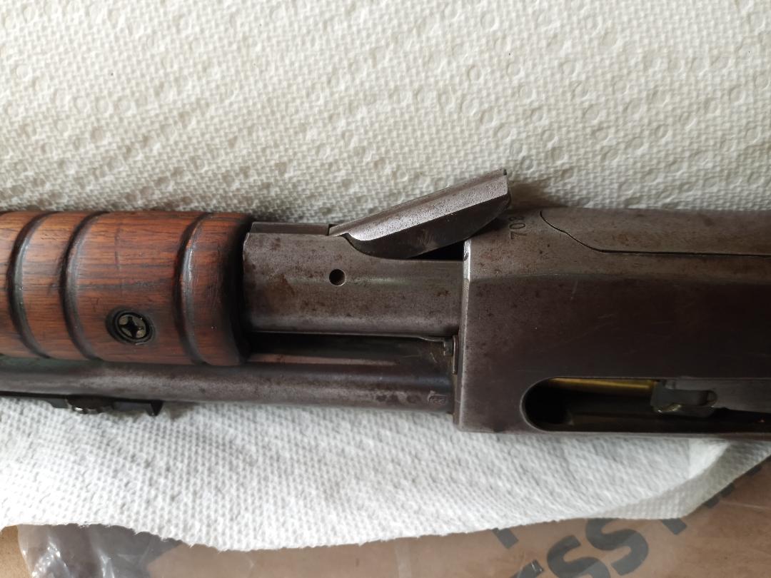

While shooting my 14 1/2 upon ejection the loading gate opened and became lodged with the receiver. It will not cycle to extract the spend cartridge. How can I get the spent cartridge out?

The loading gate opened while cycling a round and it's jammed against the receiver and I cannot pull the forearm up to move it.

Thanks, I'll try that. It seems the loading gate is sticking up too much and won't go into the receiver. I thought it might be held in by that pin.

I tried to attach a picture. Don't know if it worked. Find under attached files.

Picture sure tells the bloody story, never in 50+ years of screwing with these rifles have I ever seen that, probably the spring for the loading gate gave up or is missing. Again, the only way I can see you going forward is to remove the loading gate pin, should not be very difficult, and they usually come out easily. Look for the spring/plunger once you remove the gate. No doubt in my mind there is something else going on but with the gate in that position the magazine spring & follower have by-passed the gate and have made there way up into the action.
You of course can try to pull the spring/follower out through the end of the magazine tube but its probably hung up pretty good so it looks like a lot of fun, these rifles provide more than their share of challenges.
I'm NOT saying this is the case with your rifle but 90% of all loading & feed problems are the result of reloaded ammunition. Both the 14 & 14-1/2 were designed to use "new" factory ammunition, OACL is critical and in the case of 38-40 or 44-40 if you are just a "hair" to long it will result in serious feed problems, mainly jamming!!
