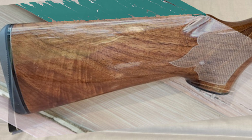

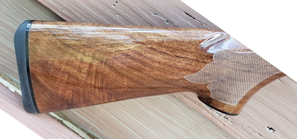

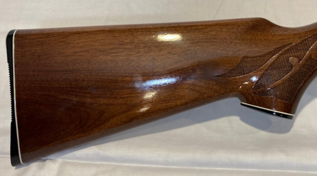

I pulled a couple stock photos and overlaid them. Clearly the old darker stock is taller...
overlaid buttstock.jpg (103.71 KiB) Viewed 2831 times
Difficult to get precise with overlay, but this shows the difference in height of pad. As well the older ones are narrower.
Perhaps there is someone who actually owns one of each...
