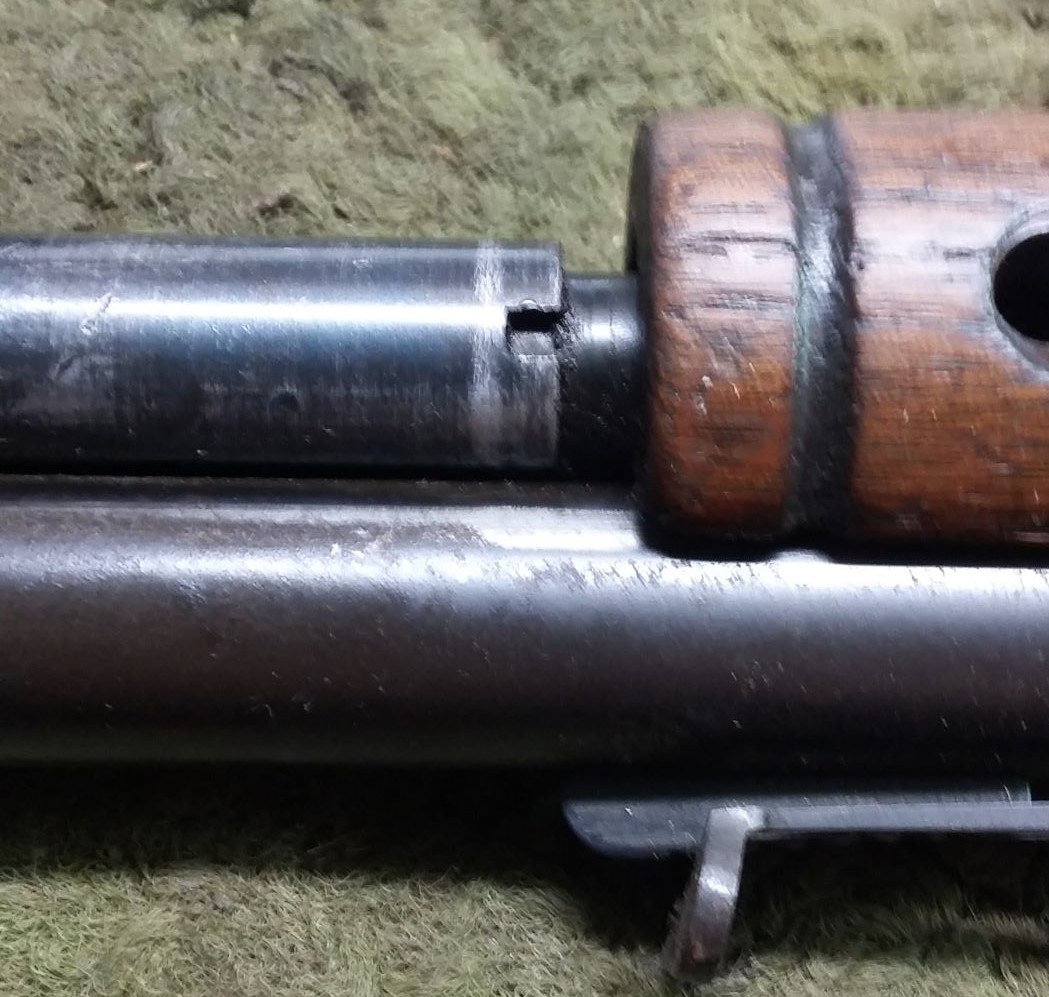

Thanks, I'll check all that again. I cannot get the mag tube free from the front of the breech block. Someone else tried many years ago and burred up the part the tube goes into. Or it is just rusty.

Another question. The Rem 25 manual say to "turn out the magazine" from the breech block extension. I am not seeing any threads so am I correct in assuming the set screw holds the mag in place? I need to figure out how to turn and pull without damaging the thin tube. I have soaked the joint in KROIL and let it sit for several hours. I'll try again tomorrow.

I have not had one of these apart in many years.
I think the tube is threaded and that the set screw keeps it from unscrewing. A set screw alone would have a big job of holding the thin tube securely. The weight of the tube, it's parts and the ammo would all have to be held in place during the cycling of the action and recoil.

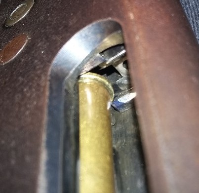

Here is a pic of the interference issue. If the cartridge is moved back toward the breech face about 1/32 inch all feeds well. But the mechanism does not cause it to happen. There is no pressure on the front of the cartridge to put it in place, and the lifting lever does not apply rearward pressure. The only thing that moves it back is gravity. So, if the muzzle is pointed upwards when the action is operated, it feeds very well. If the muzzle is down, this jam occurs. Raising the muzzle and moving the forend forward a bit allows the cartridge to move rearward and is able to be lifted into the breech block rim guides. I give up.
