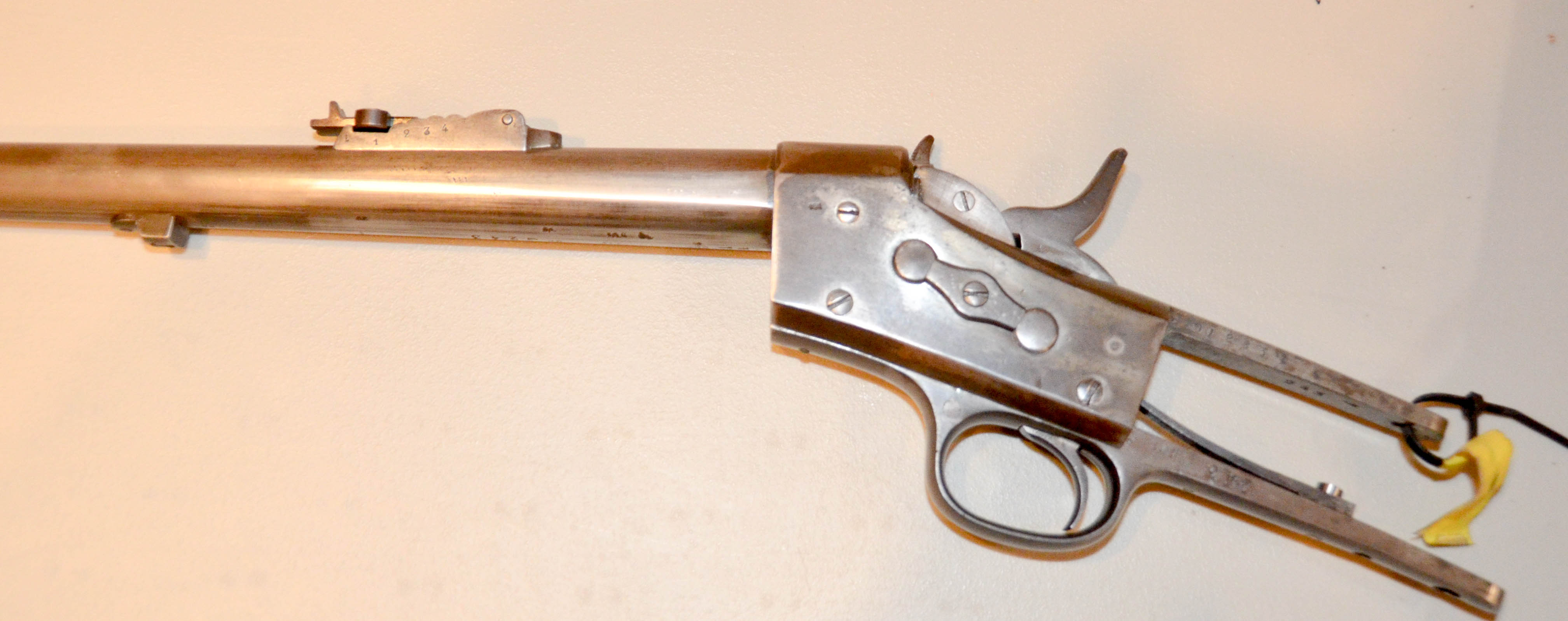

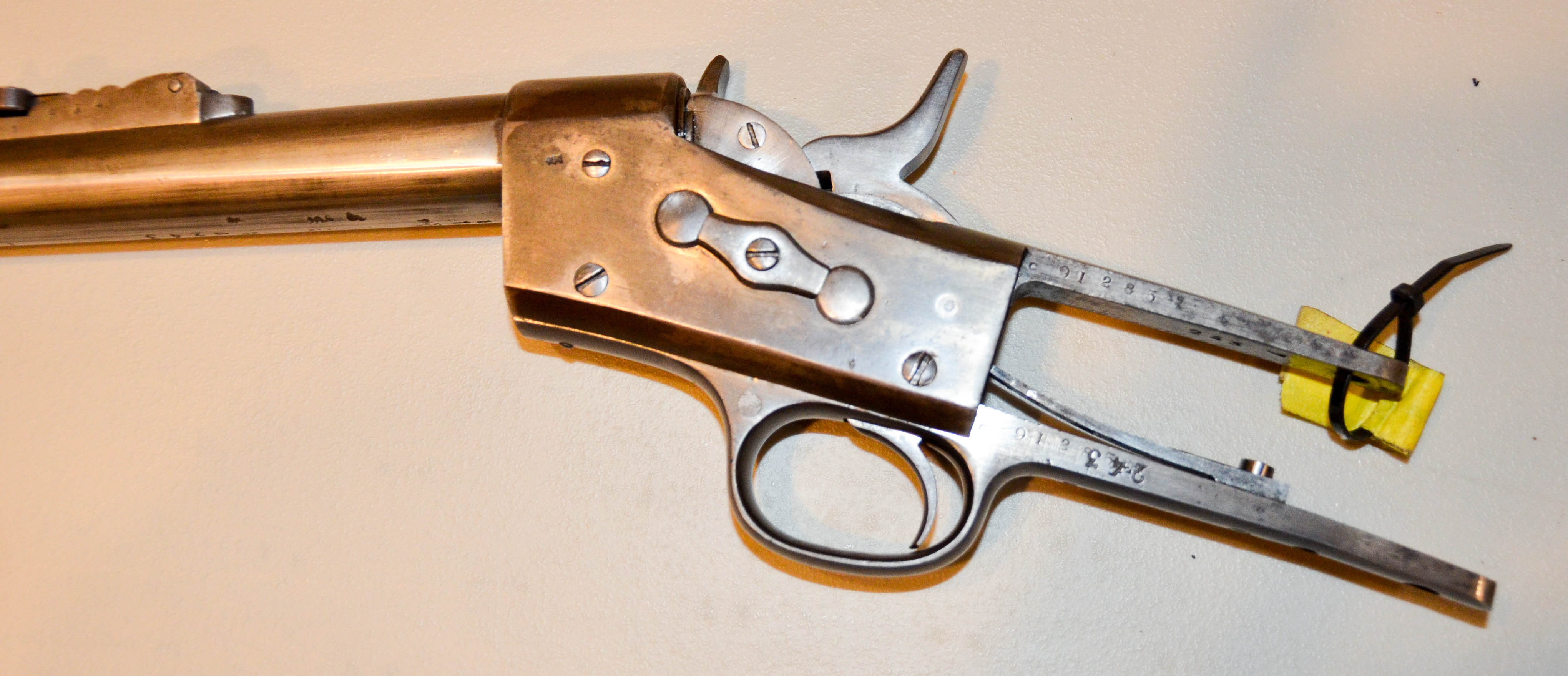

Hi all, I have a rolling block I am trying to ID I posted earlier but here are the pictures.

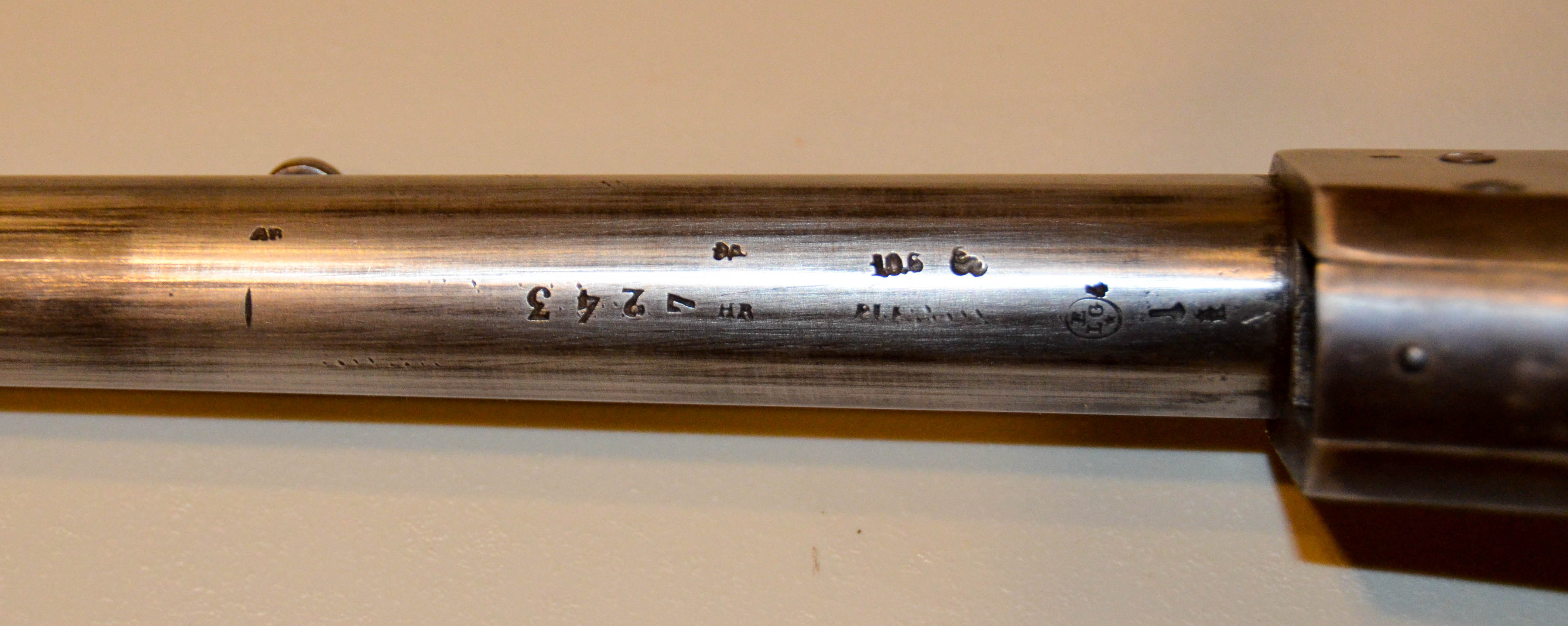

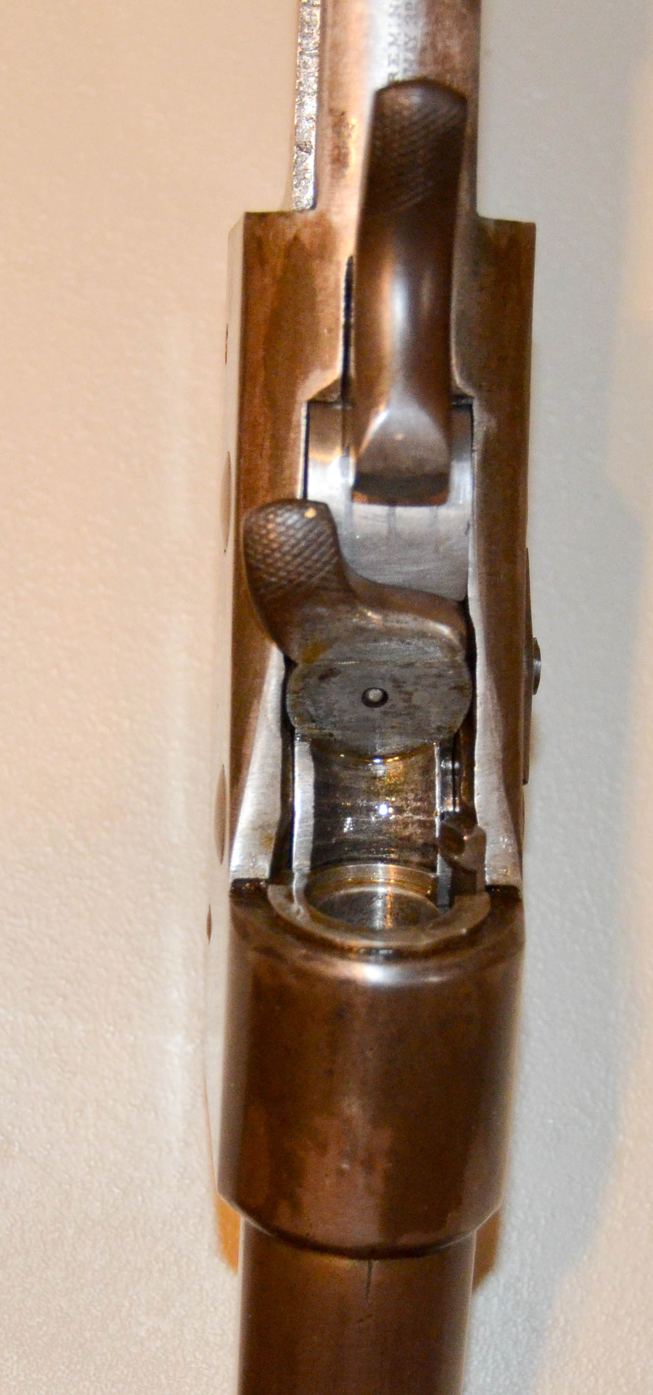

Your action started life as what is known as the Transformed Rifle in .58 caliber made from surplus Civil War rifle parts mated to a Remington action. This is evident in your 5th photo where the sides of the breech block are rounded to accommodate the larger diameter of the .58 cal. cartridge. It (yours) was probably one of those sent to France during the Franco-Prussian War, 1870, and surplused out after the war. Many of these were rebarreled in Belgium to .43 Spanish caliber, a much more resalable product than the obsolete .58 caliber. The markings on the bottom of your barrel are Belgian inspector/proof markings.

As to the markings on the bottom of the barrel, the only ones that have significance to us today is the 10.6 which indicates bore diameter in millimeters for the 11 mm Spanish cartridge. On Belgian rebarreled Egyptian Rolling Blocks in the Egyptian caliber, they stamped 11.1 for mm. I read your initial post when you posted it but, like you, I'm getting on in years so didn't remember it. The Spanish in their own rifles and some rifles in their colonies converted lots of rifles to the Reformado cartridge. Talking with Geo. Layman many years ago I was of the opinion that, due to the pretty huge differences in fired cases in my various Reformado rifles and carbines, that the conversion was done "in the field" rather than at an arsenal. It seemed that no two chambers were the same. The Reformado case is just a blown out Spanish case so that it can take a larger diameter bullet; the rim and the base are basically the same. All my Reformados are fired with Spanish cases fire formed to their chamber. For subsequent loadings, I neck size with a .45 Colt die or maybe a seat die for a .44 Spl., etc. But, since it has been 140 some years since these were rebarreled, there has been a lot of time for someone to do something weird to the chamber. The best bet would be to make a chamber cast to determine what the measurements are. Good luck!

As far as the barrel goes it has the fleur de lis on the left side by the action on the right is the 4 sided flower? I've seen mentioned before. There is a small stamping on the left action but even under a magnifying lens i can't make out. Under the barrel is 7 perpendicular to the barrel on top of a six. Both guns have the same markings as well as the chamber casts are the same. I will post a drawing of them when I get done it. Thanks for the answer it's much appreciated Bill

According to Geo. Layman in his "Remington Military Rolling Block Rifles of the World" the fleur d ' lis is found on Spanish rifles and is a symbol if the Spanish Royal Family and the House of Bourbon. He also says that the 1st contract for Spain went to Cuba and was the only contract that should have a concave breech block. Your receiver is definitely that of the Transformed model as it has the "wings" on the breech block and the lower tang is longer than the upper tang. So, it was originally in .58 caliber. Somehow, it made it to Belgium where it was re barreled to 11 mm Spanish caliber. All the markings on the bottom of the barrel had significance to those working in the shop at the time of re barreling.
