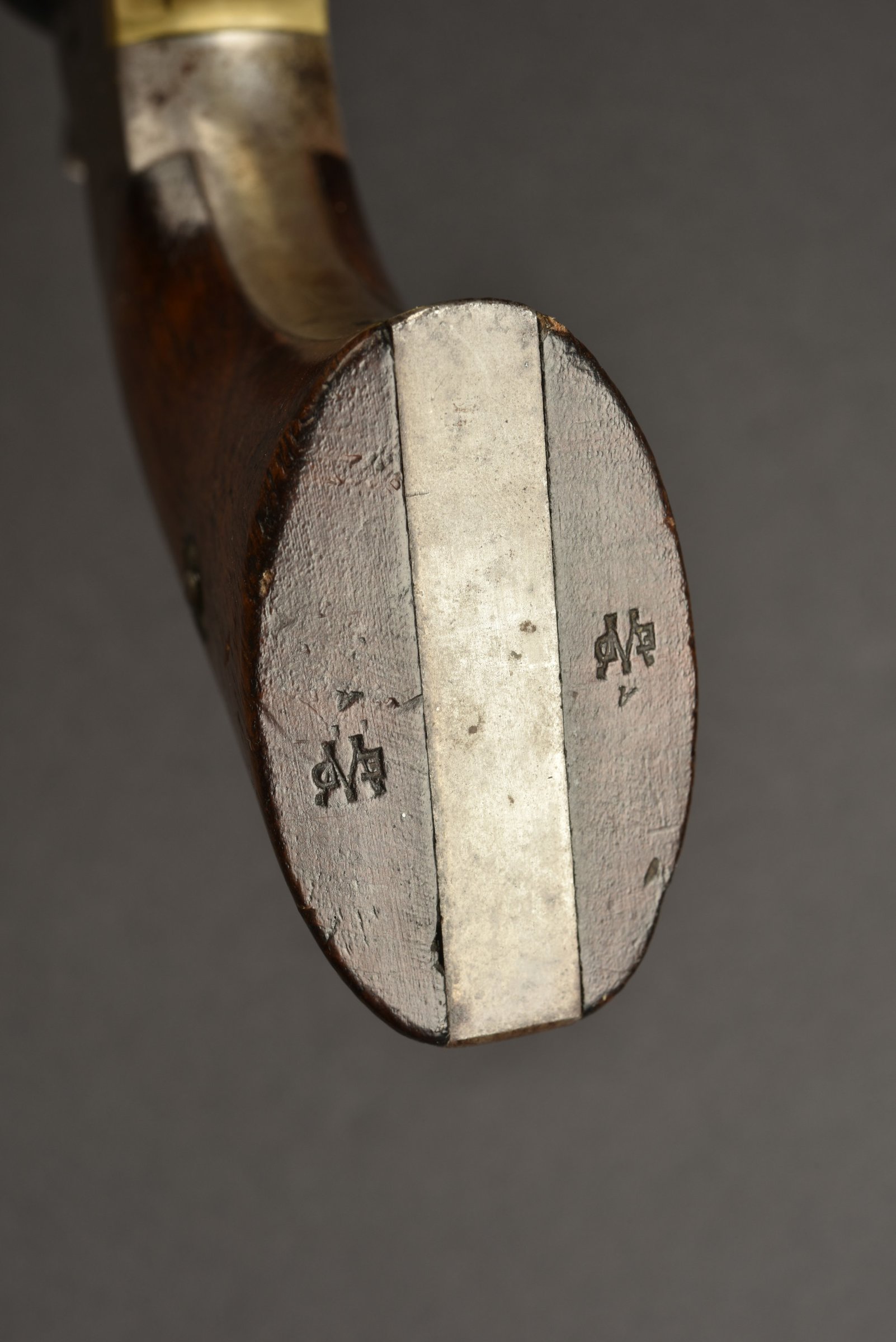

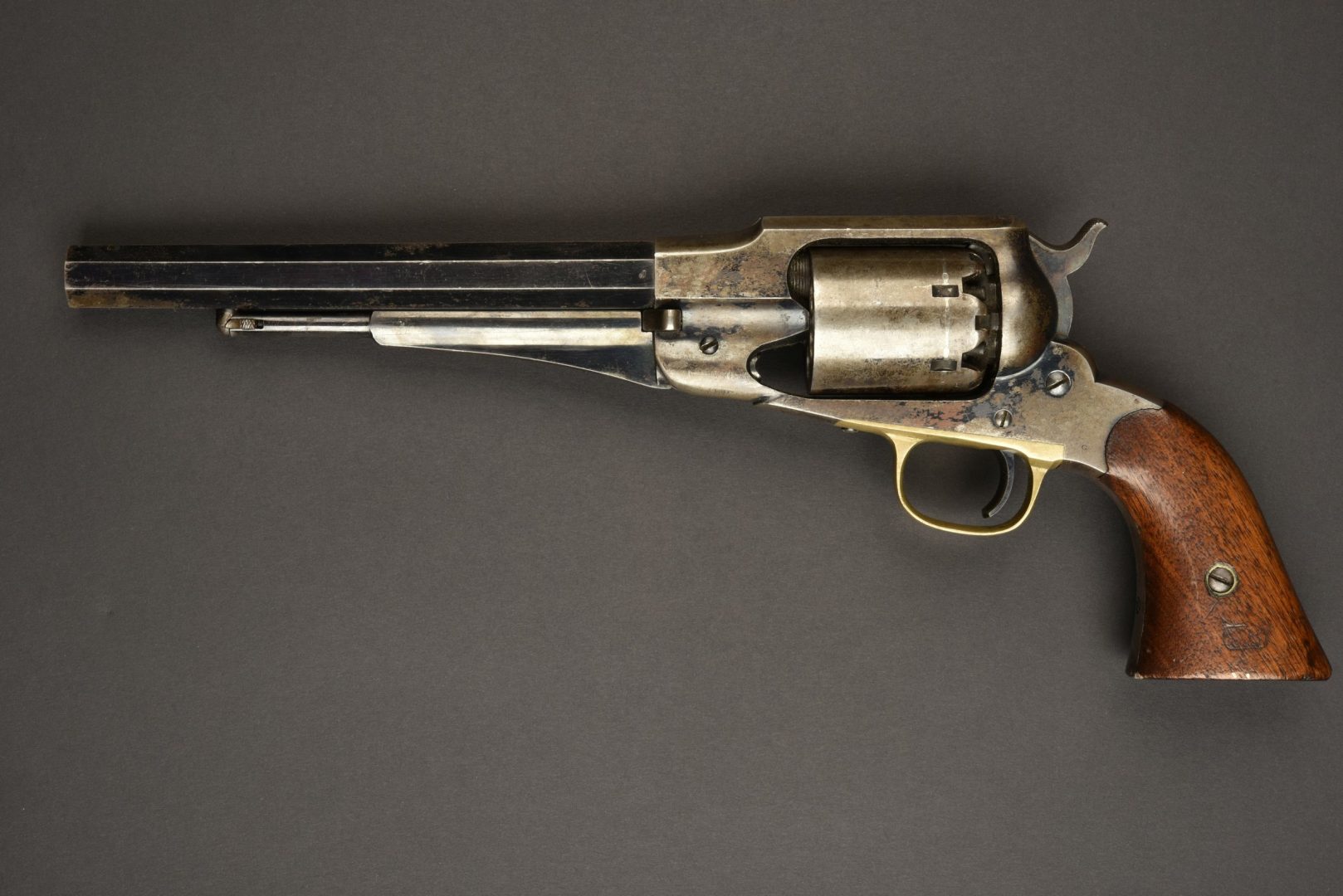

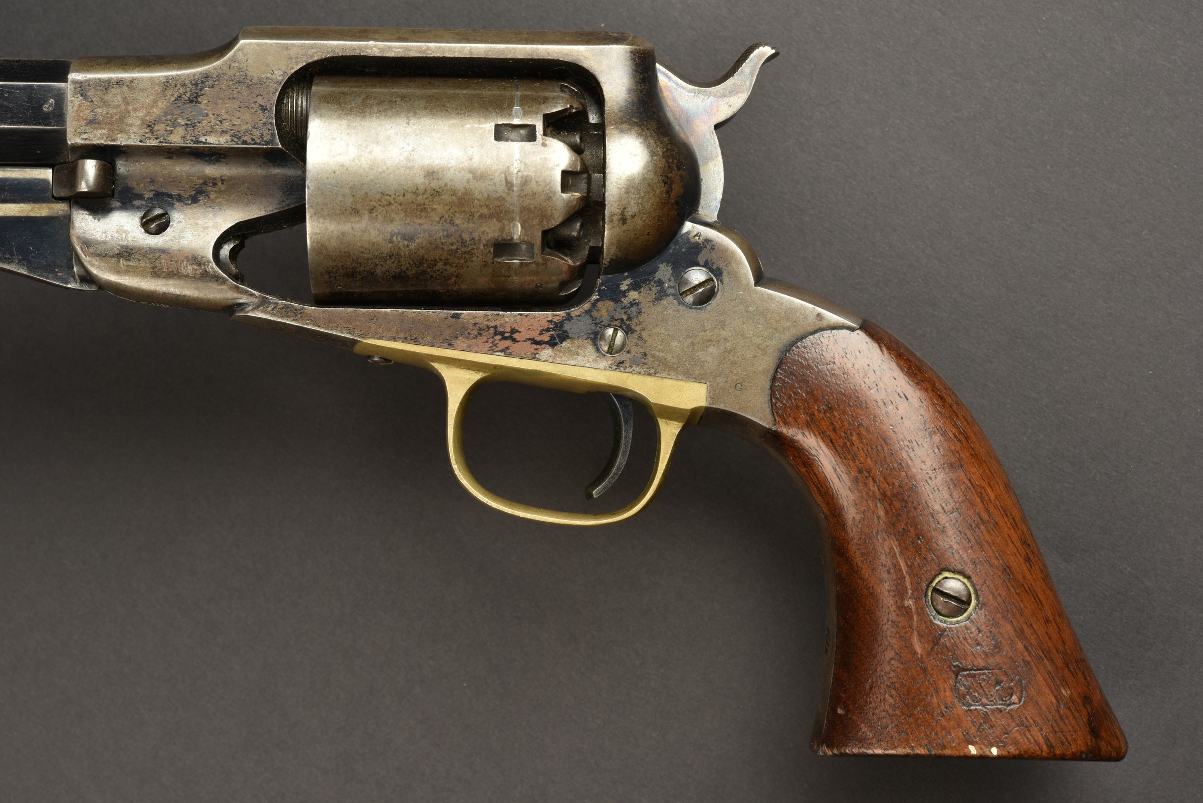

A Remington NMA revolver was sold a few days ago in France and this transitionnal model, #19272, has some interesting feature on the grip.
The left grip panel has a cartouche from, I believe, Benjamin Hannis (BH) and on the bottom of the grip panels, there are some dual inspectors’ marks.
This is not a common practice to have so many inspection’s marks, so I was wondering if you Guys have please, any idea of what it could be ?
« EWD » ? May be an US Army/Navy officer commanding an arsenal or a navy yard..
I hope it would help someone.

Here in Europe, we can find a large number of Remington NM Belt SA revolvers wich is surprising in comparaison with the small quantity produced (not so much when you know that Samuel Remington was the purveyor of arms for the French War Ministry in 1870-1871).
But more surprising is that most of the Belt SA revolvers, has a number stamped on the grip panels (left or right).
It may be a French military marking but I don't think.. Belt SA revolvers can also be found in the US, with a number on the grip.

Hi Karu,
That is a very interesting marking on the butt. There are no US inspectors marks on grips, since they were a disposable item, and no inspection was necessary. Also, the US sub- inspectors used only the first letter of their last name, and the actual acceptance stamp was the cartouche in the left grip.
.My guess is that it is a company stamp. In the US, the initials written that way is a fancy way to write initials that would normally be written as E D W. The large W in the center would be for the last name. For example, The fancy way for JFK would be: jKf. I would think that it would be unusual for an individual to have a marking stamp, thus my presumption that it is a company marking.
The 50 stamped in the upper left grip may be an inventory number, or a Dept. number, or it could mean just about anything. This also makes me think that it si a company marking.

As to the number in the grip of the Belt models in Europe, could they be from a French contract? Another guess is that a company ordered a group of Belts and stamped the number in the grip. There are just too many possibilities to know with finding some documents.
If you’d like, I can send a little more info on the Belt Models.

There is a possibility because I have a Starr 1863 Army, with a number (28) on the right side of the grip.
That revolver is one of the 20.000 revolvers purchased by the French governement when the war started in 1870.
The way the number is located, on the right side or the left side of the grips, is may be a clue.
Belt models seems to have a number on the left side of the grip while the others (US percussion revolvers - all brands combined) have a number on the right side..

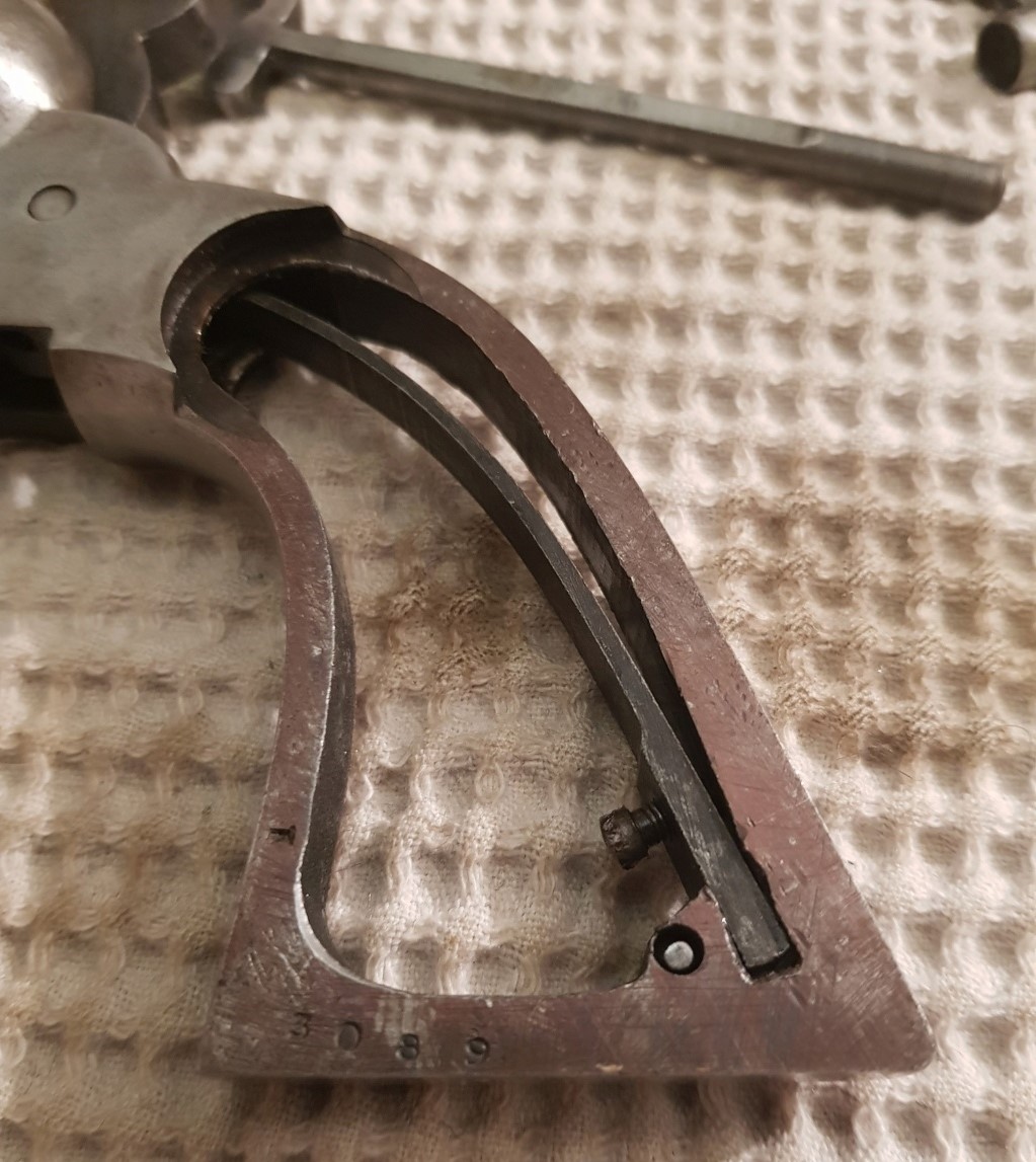

On SA #3089, the main spring screw enters from inside although there is a hole in the backstrap.
Do the 2 models have the same frame ?

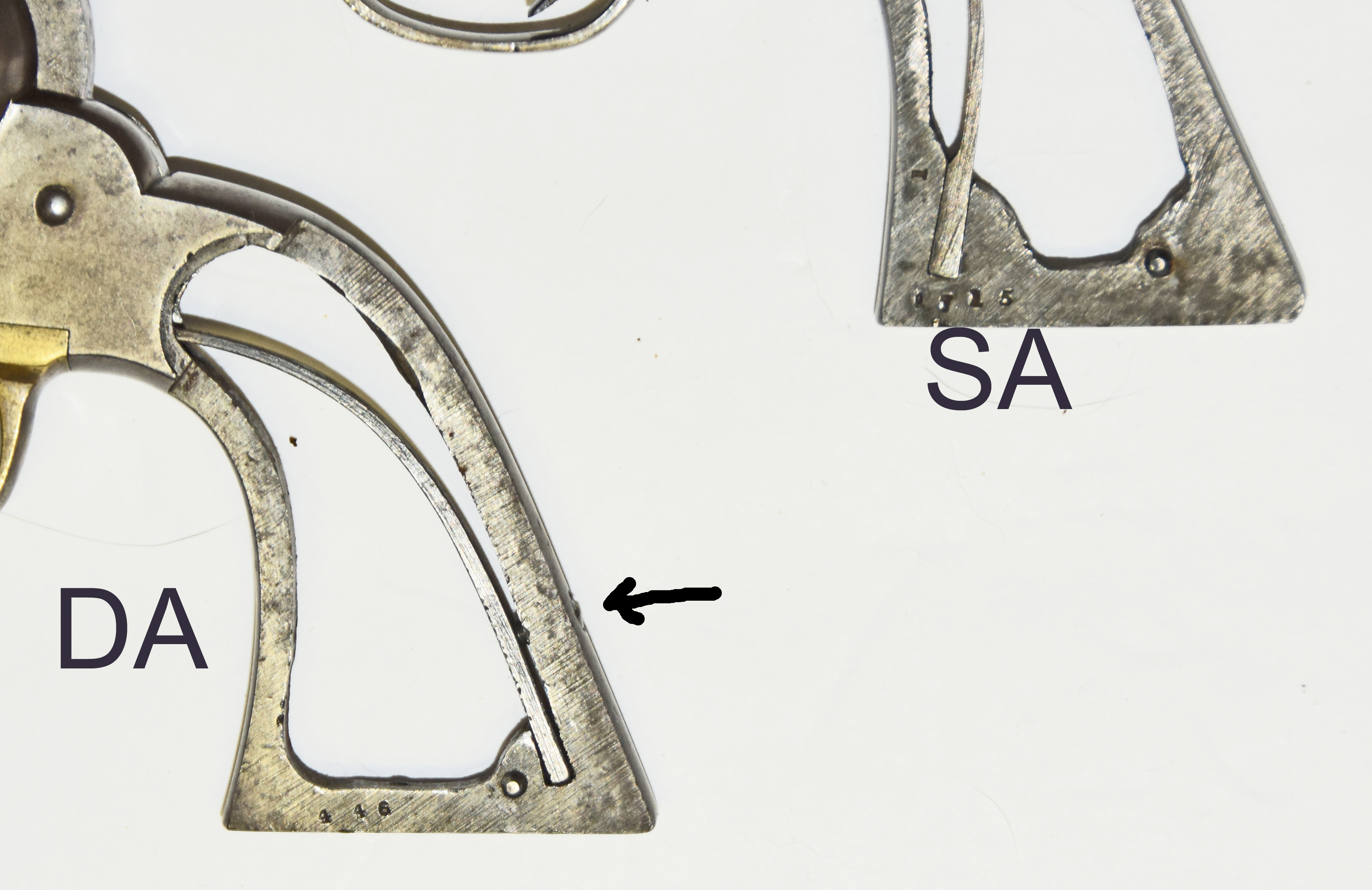

The frames of Remington guns were cast, and the mainspring holder is part of the frame. The SA spring was attached at the lower front of the frame, and the DA spring was attached at the lower rear of the frame. Moldenhauer noted that some SA were made on DA frames. In the photo, the arrow points to the mainspring screw in the DA backstrap.
[attachment=1]DA Belt spring screw-2.jpg[/attachment]
Most collectors believe that there were different frames made for the SA, and the DA. Looking at the frames that I have, and without taking any dimensions, it may be that there was only one frame made. It is possible that the frames were made with metal in the front and rear of the lower inside of the frame. The frames were machined with a slot for one style, and the “excess” metal on the other side of the frame machined away.
Your questions:
1) There is no mainspring screw on the SAs, but Moldenhauer’s drawing shows a small spring screw, on the inside of a SA that was made on a DA frame.
2) The frames of the SA and DA are the same size, and as above, most think that each had it’s own frame. It is possible that only one frame was made as I said above. Moldenhauer did find at least one SA that was made on a DA frame, and there likely could have been more. The hole would have been drilled into the frame after the initial machining had been done. Take off the grips of the gun in question and you can tell if the frame was machined as a SA, or a DA. Your photo doesn’t clearly show if the hole has one diameter, or if it is a two diameter hole to allow the screw head to be recessed. If it is a two diameter hole, then as you suspect, it may have been drilled for a DA, but made as a SA.

I believe that the early Belt revolvers (DA & SA) were made, with a mainspring holder in a different location, as you’re already said ;
- at the lower rear of the grip frame for the DA,
- at the lower front of the grip frame for the SA.
The mainspring holder of the SA is deep and makes a good angle for the mainspring and then no screw is necessary.
I don’t know much about the DA but it looks to me that the mainspring holder was placed at the rear because of its mechanism.. The mainspring tension is good enough and not too hard for a DA.
After a while, Remington decided to save cost and to placed the mainspring holder at the same place for both.
For the SA, a new screw was added inside to? ... secure the mainspring position?? :)
It’s likely that a change during manufacturing appears ?

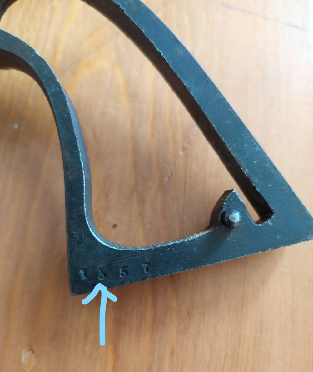

It could explain why most of the SAs I’ve seen, in the middle serial number range, has the mainspring holder at the rear.
SA #1557
#3089
#3089 2.jpg (255.01 KiB) Viewed 5188 times
From top to bottom (et merci beaucoup à KAISERKILLER)
SA #4297
SA #4230
DA #1890
SA frame.jpg (240.35 KiB) Viewed 5188 times
The most important point is to determine once for all if the 2 models has the same frame.
The shape of the grip frame is sometimes surprising and seems to be different..
Otherwise I found only minor differences.
