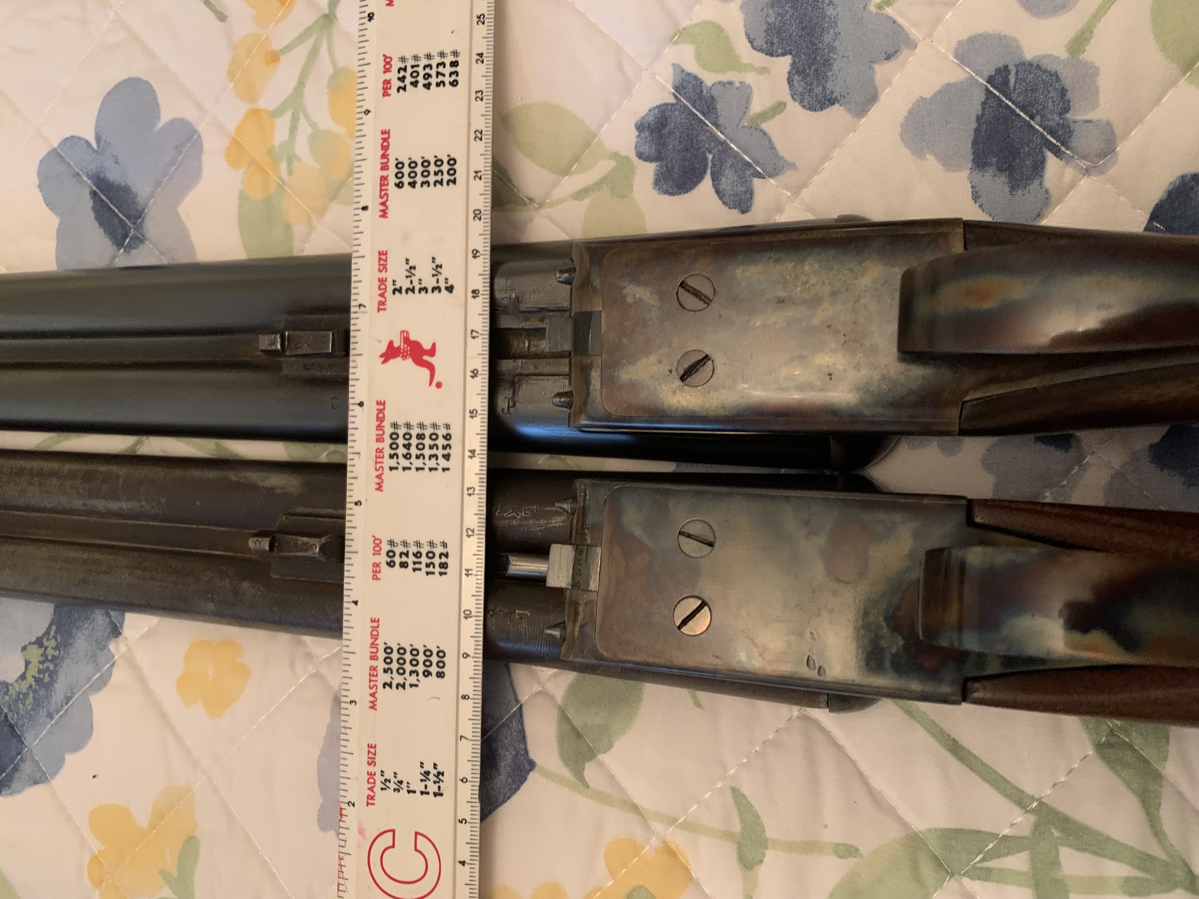

Here are a couple pics of my 1910 KED "lightweight" (left or up) and 1902 K (right or down). Hopefully the size difference can be seen.

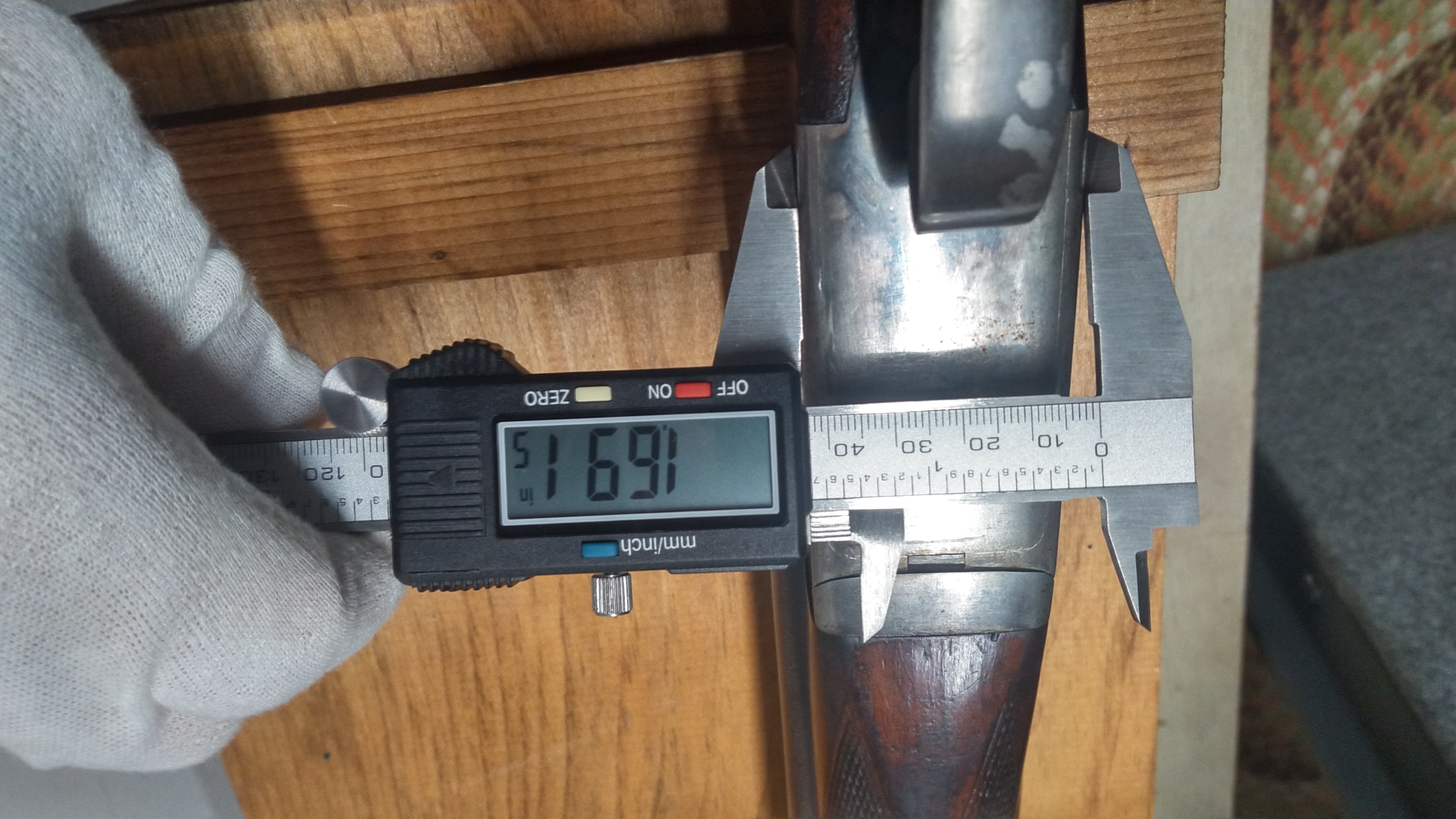

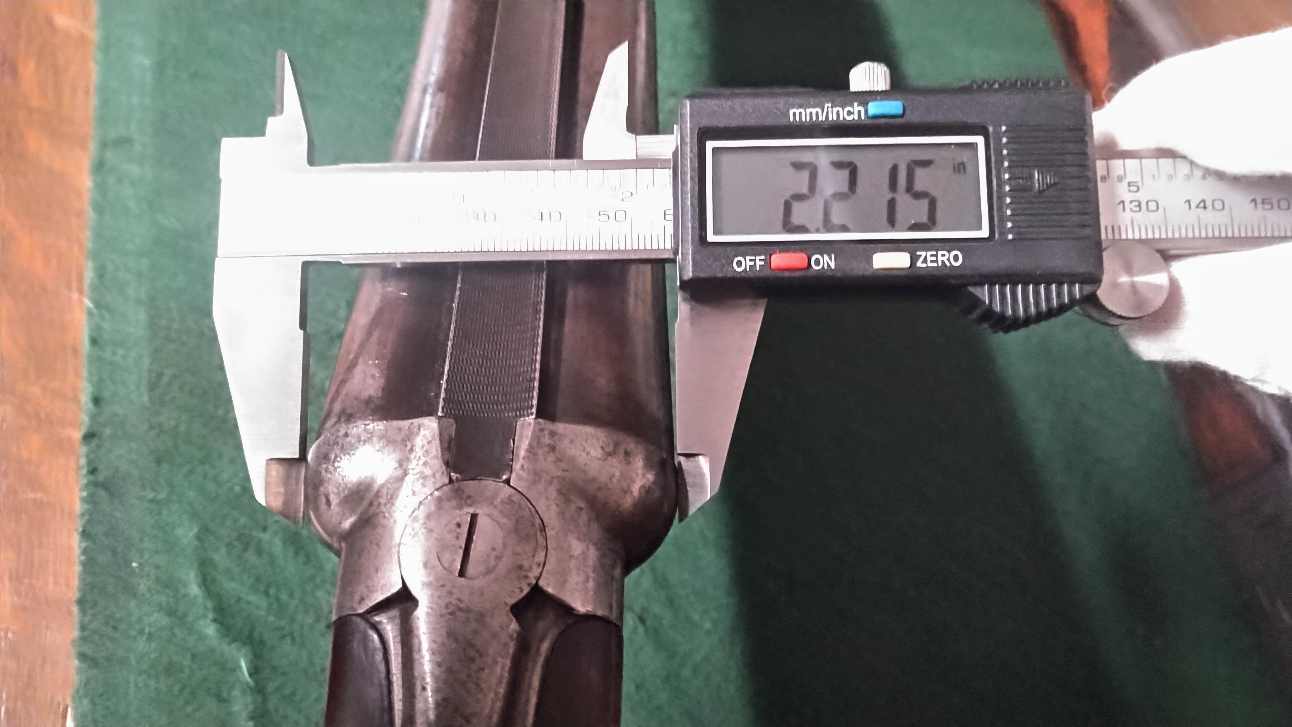

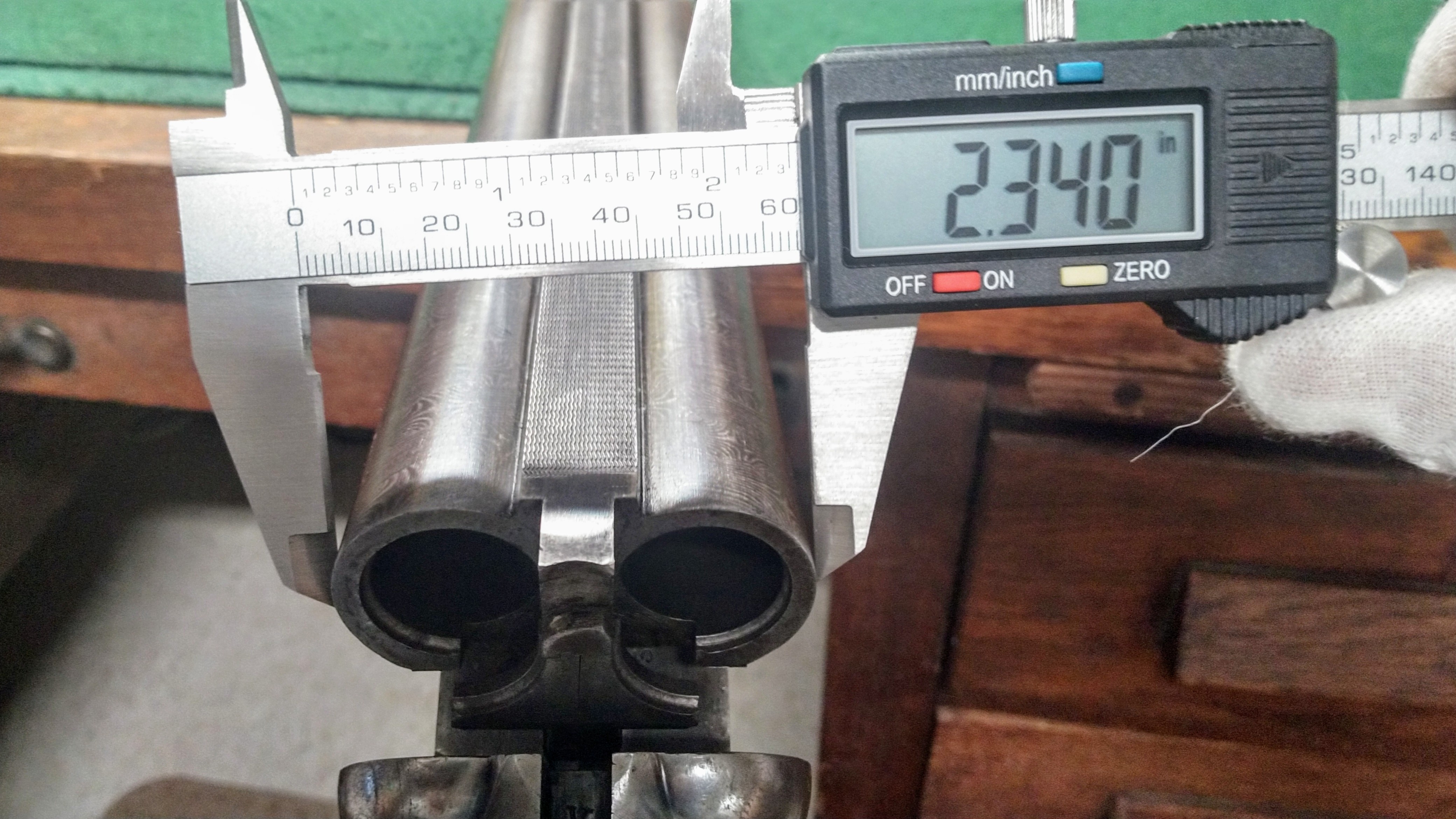

here are some measurements from my small frame 1900 12 gauge
- Small frame 1900 barrels.JPG (1.52 MiB) Viewed 38460 times
- Small frame 1900 bottom.JPG (2.08 MiB) Viewed 38460 times
- Small frame 1900.JPG (1.29 MiB) Viewed 38460 times

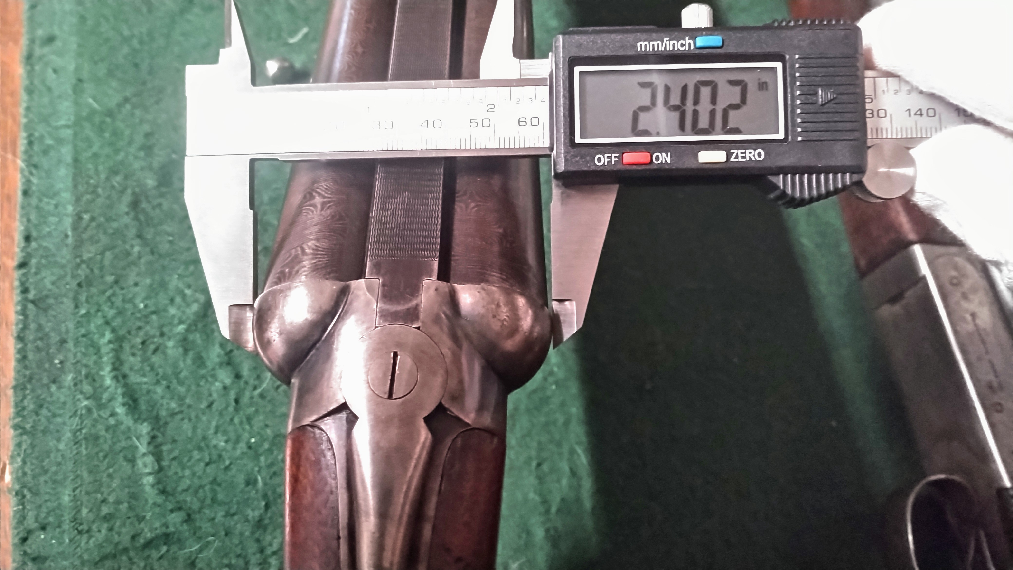

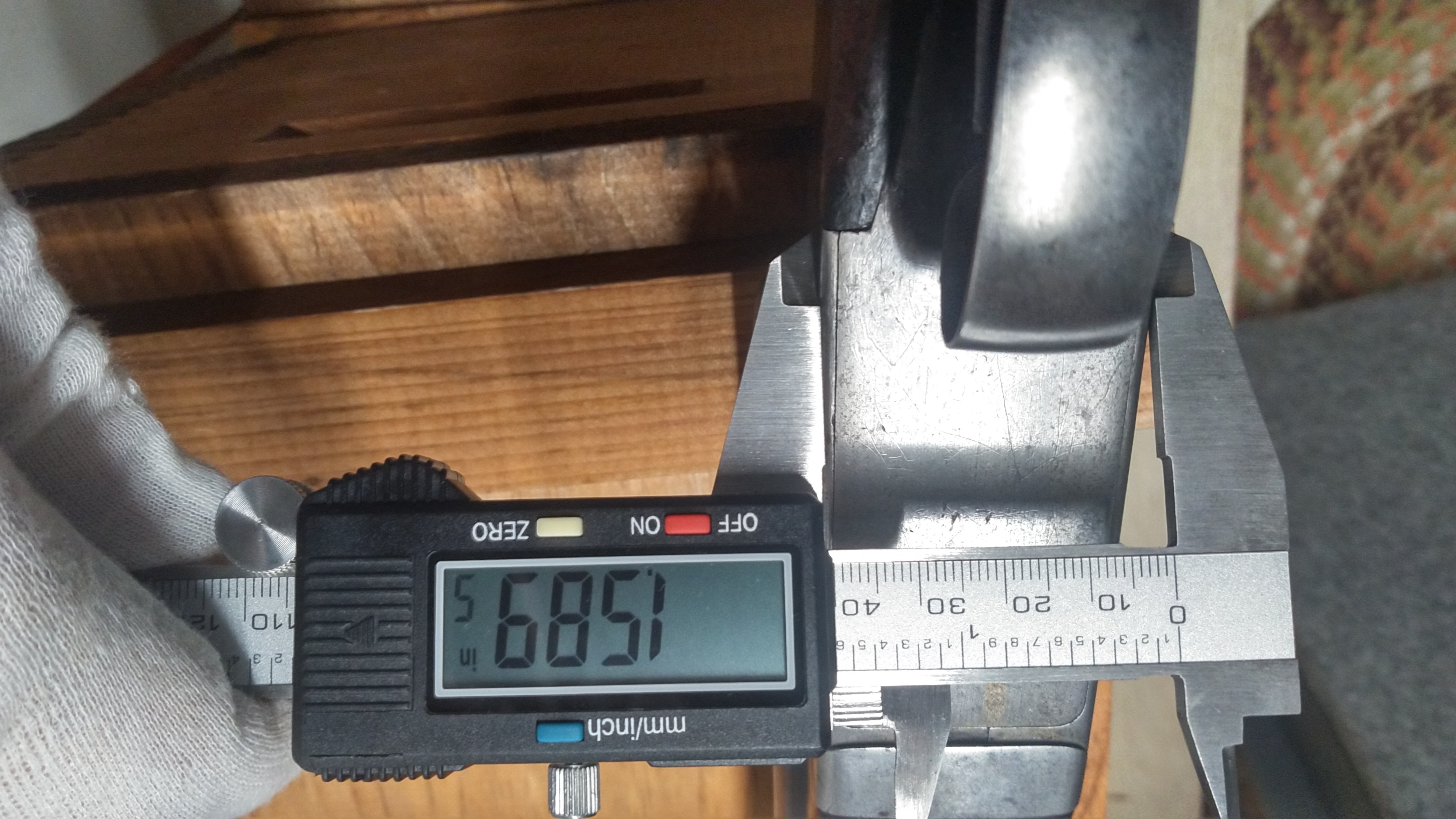

And some measurements from my regular size frame 1900 to compare
- 1900 regular frame barrels.JPG (1.59 MiB) Viewed 38460 times
- 1900 regular frame bottom.JPG (2.08 MiB) Viewed 38460 times
- 1900 regular frame.JPG (1.29 MiB) Viewed 38460 times

Well it looks like several of us collectors have "lightweight" 12 bore hammerless Remingtons!
My next question (with no answer I'm betting) is why there are not many catalog references? The other makers already were building smaller frames and gauges to expand markets I would assume. My 12 gauge light 1900 even feels poised for game shooting!
Thanks for the great pictures Mike & DieNusse1
