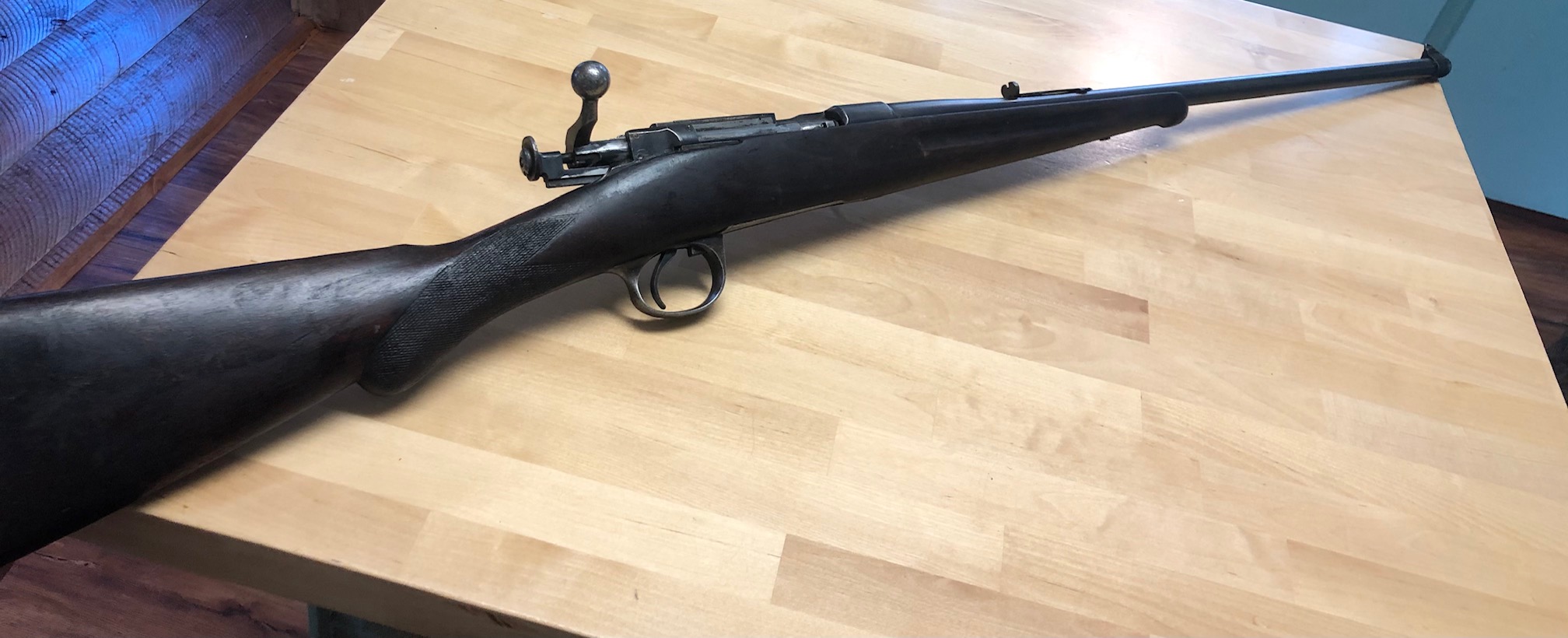

Remington - Lee 1899 Sporting rifle?

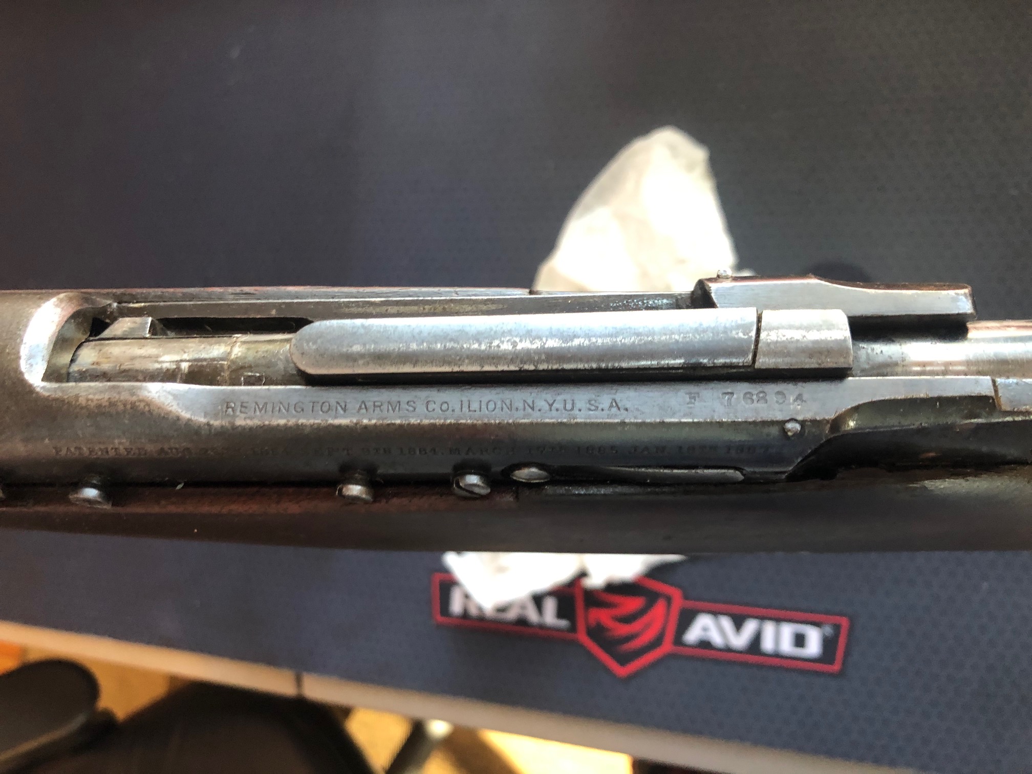

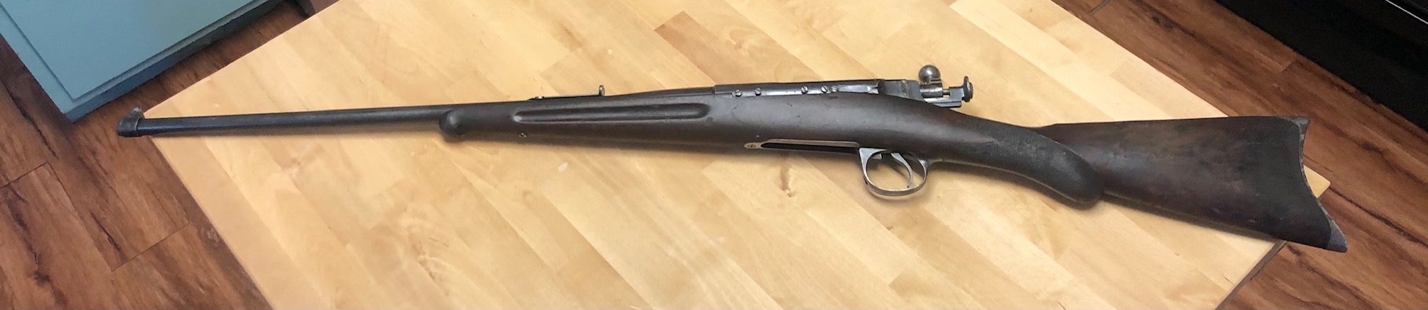

I'm going through my late FIL's firearms and trying to identify this rifle. Some kind of vintage Remington bolt action rifle.. It says 30.40? I've never heard of that before but that's not saying much LOL I posted on another forum and they suggested that it could be a Remington - Lee 1899 Sporting rifle. Looks pretty similar in the pictures that I see online, except mine has some extra screws?
Also, can we nail down a manufacture date with the serial number? "F 76394".
Any info would be appreciated, thanks!
The left side of the receiver near the bolt says:
REMINGTON ARMS CO. | LION, N.Y.U.S.A F 76394

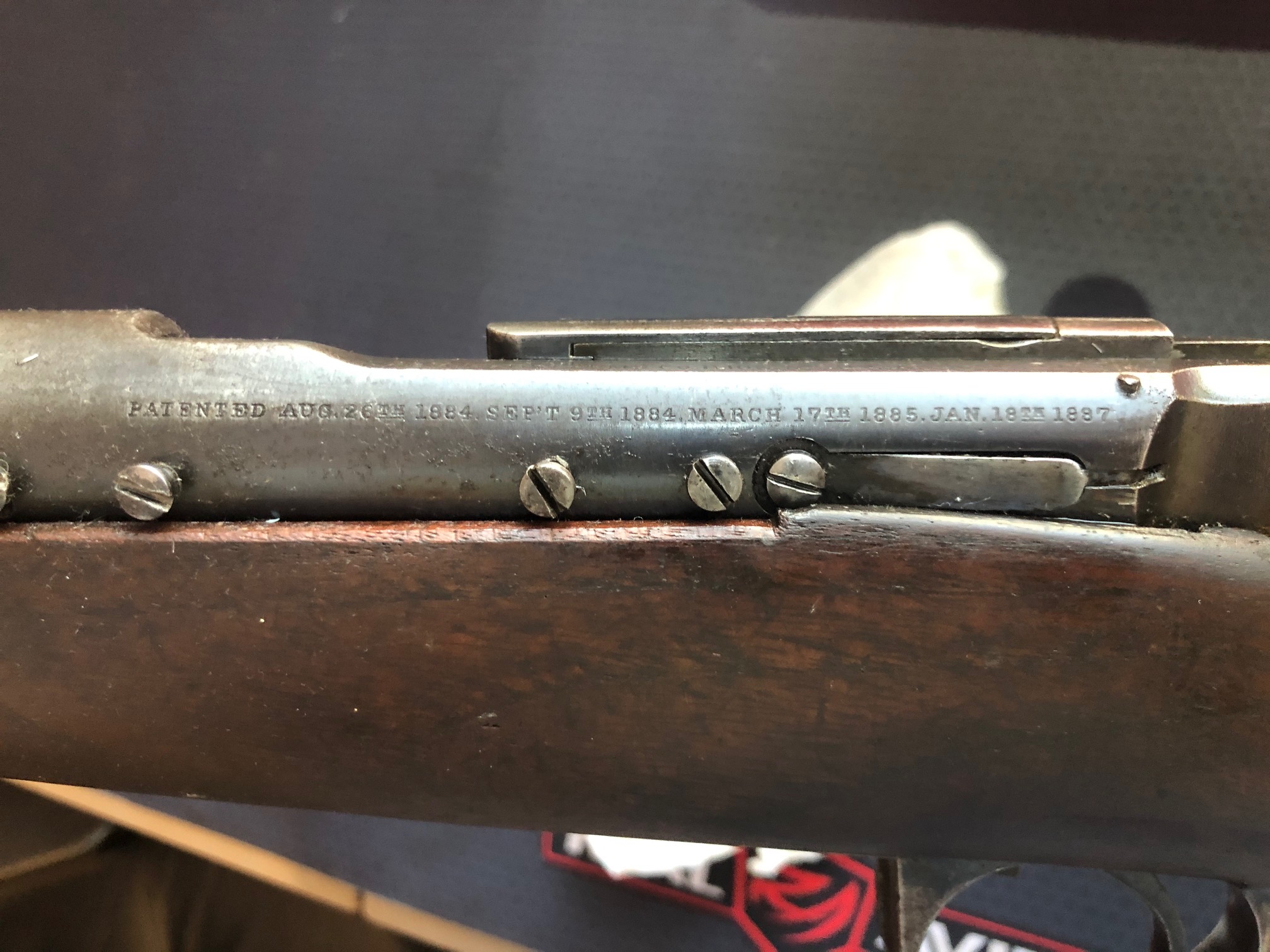

Further below, still left side, but along the side of the receiver:
PATENTED AUG.26th 1884. SEP'T 9TH 1884. MARCH 17TH 1885. JAN.18TH 1887

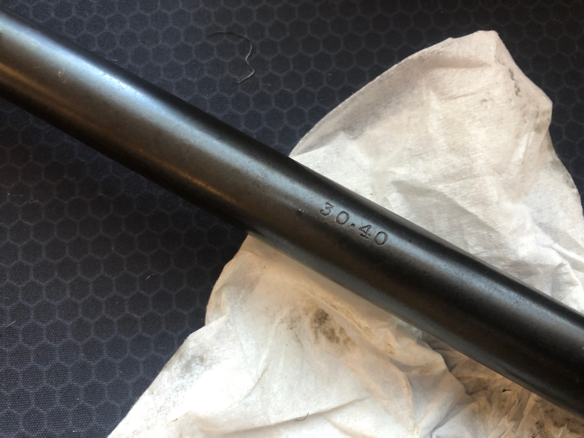

Underside of the barrel, near the forearm says:
30.40

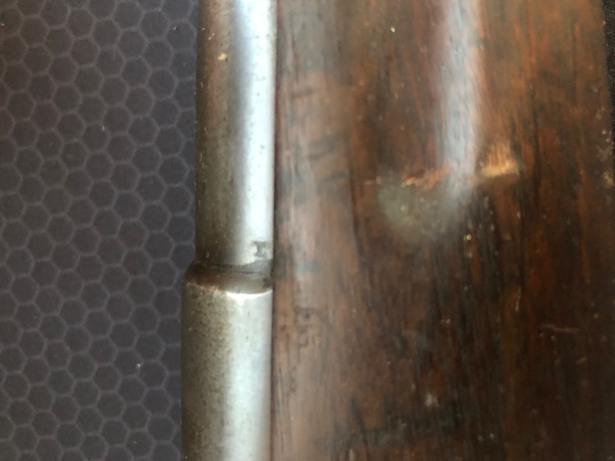

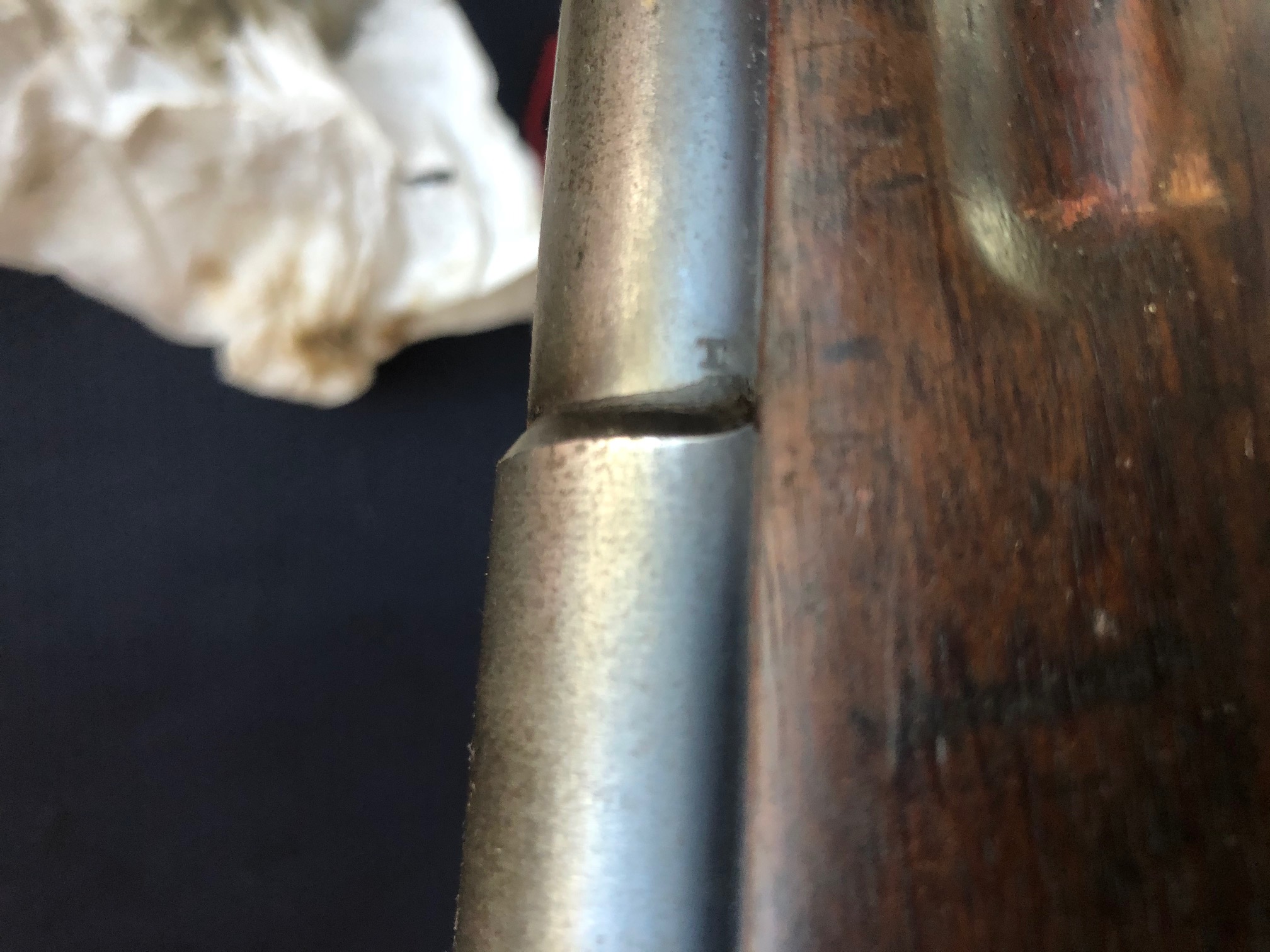

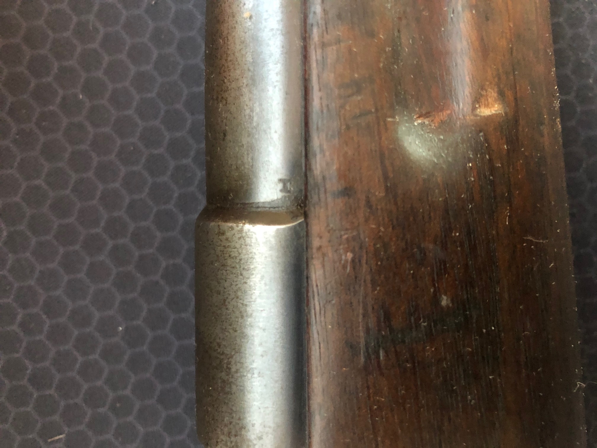

Right side of the barrel in the corner where it meets the receiver has one marking, either an H or an M.

Hi There,
I'm not an expert on this model but I can tell you the
extra screws on the left side of the receiver are for a
scope mount (probably an old Weaver side mound).
As you probably know, the magazine is missing (or at least
not pictured).
Good Luck!

Thanks Webb!
Yeah, the magazine is missing
From what I've read, only 1500 were made so pretty slim chance of finding one ..

The other odd thing about your rifle is the caliber marking.
30-40 should stand for the 30-40 Krag. That was the standard
30 caliber round for the U.S. Army from 1892 until 1903.
Rifles made in that time frame were usually marked "30 US" or
"30 Gov." The need to differentiate the 30-40 from other
U.S. military calibers didn't become necessary until after
the adoption of the 30-03 (and later the 30-06). This
implies that your rifle was made in or after 1903 (though, I
am not an expert on this model).

Your rifle is a Model 1899 Remington Lee Sporting Rifle, standard grade. The checkering for that grade is two points facing the action. I have record of at least one other Rem Lee drilled and tapped for a side mount scope. There were 1,446 Sporters shipped from the factory from 1899 to 1909. 1906 saw 77 shipped, 1907 - 9, 1908 - 2 and 1909 - 3. This info came from Sam Alvis Curator Remington Museum Feb 2, 1973. Serial numbers started at 75001 and best estimate is they went to 76446. Several sporters did leave the factory without a serial number as I had one. The highest serial number I observed in my research was 76348 so yours is a new high for me. Shipping date could be 1905 to 1909. About 3/4 of the serial numbers above 75650 have a "F" in front. The meaning of the "F" is not known. My rifle was stamped 30-40.
There were around 2,001 military pattern M1899 Remington Lees shipped to the Michigan National Guard. It is not known how many magazines were shipped with the Michigan Lee. The US Navy black powder M1885 Rem lees were shipped with 4 magazines and the issue web belt had pockets for 4 magazines. In any event the M1899 magazine is a rare bird but sometimes shows up in a dealers box of magazines. Some may have filler blocks in either front or rear to take up space for the shorter cartridges like the 30-30, 32 special or 38-55.

extra side screws, definitely for a side mount.
