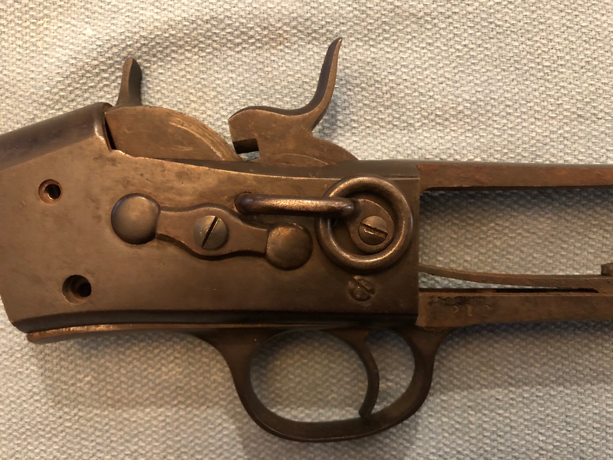

I recently purchased a receiver in hopes of building a rifle. The only serial number I see is on the left side of the frame and would be under the stock - 212. Perhaps the most unusual feature is a carbine style saddle ring bar and loop, which are similar to parts on a Sharps or Smith carbine. The top tang is marked:
Remington Arms Company Ilion, N.Y.
Pat May 30 1864 May 7th June11th Nov 12th Dec 24th 1871
Dec 31 1872 Sept 9 1873 Jan 12th March 18th 1874
Any assistance on how it would be originally configured would be appreciated.

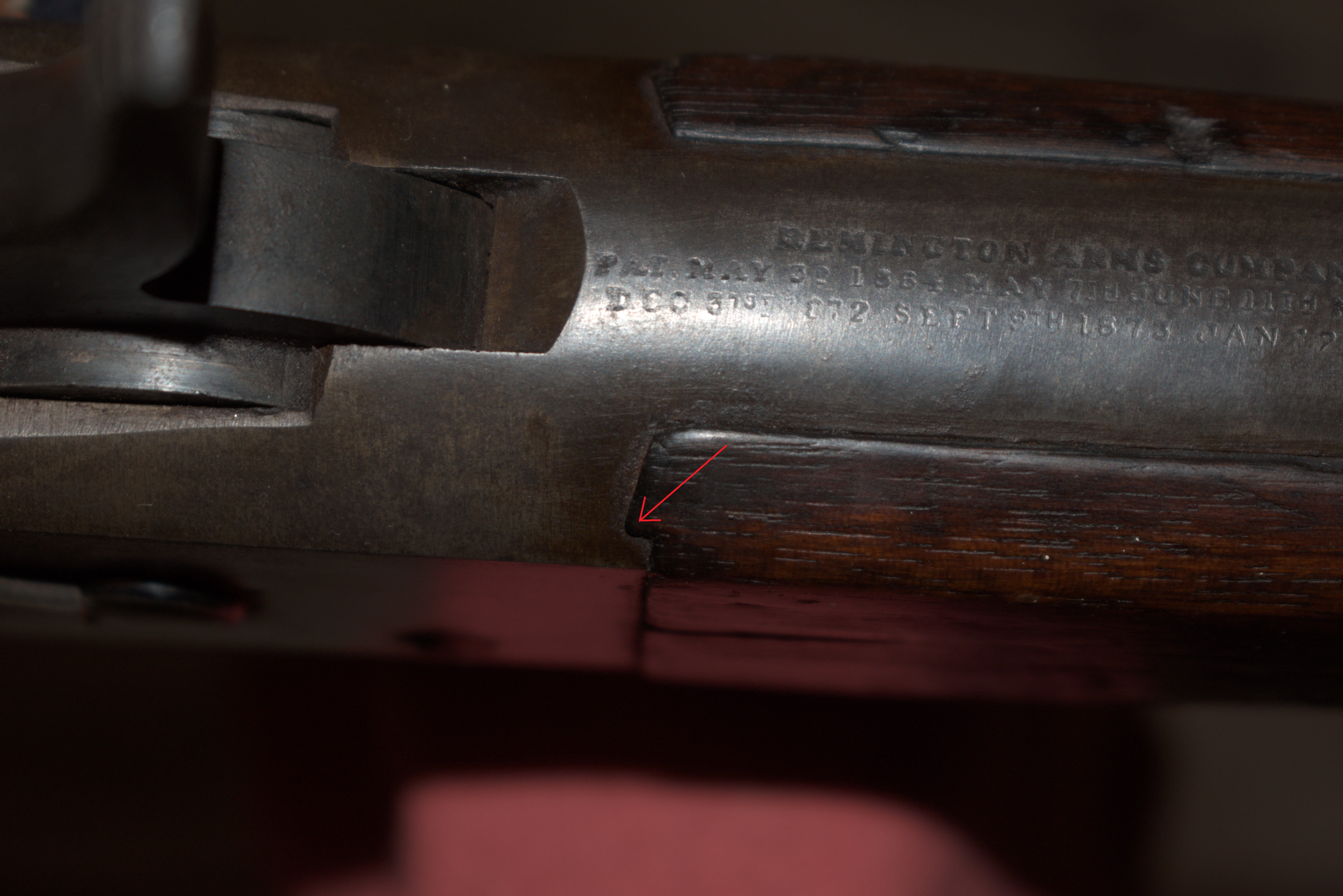

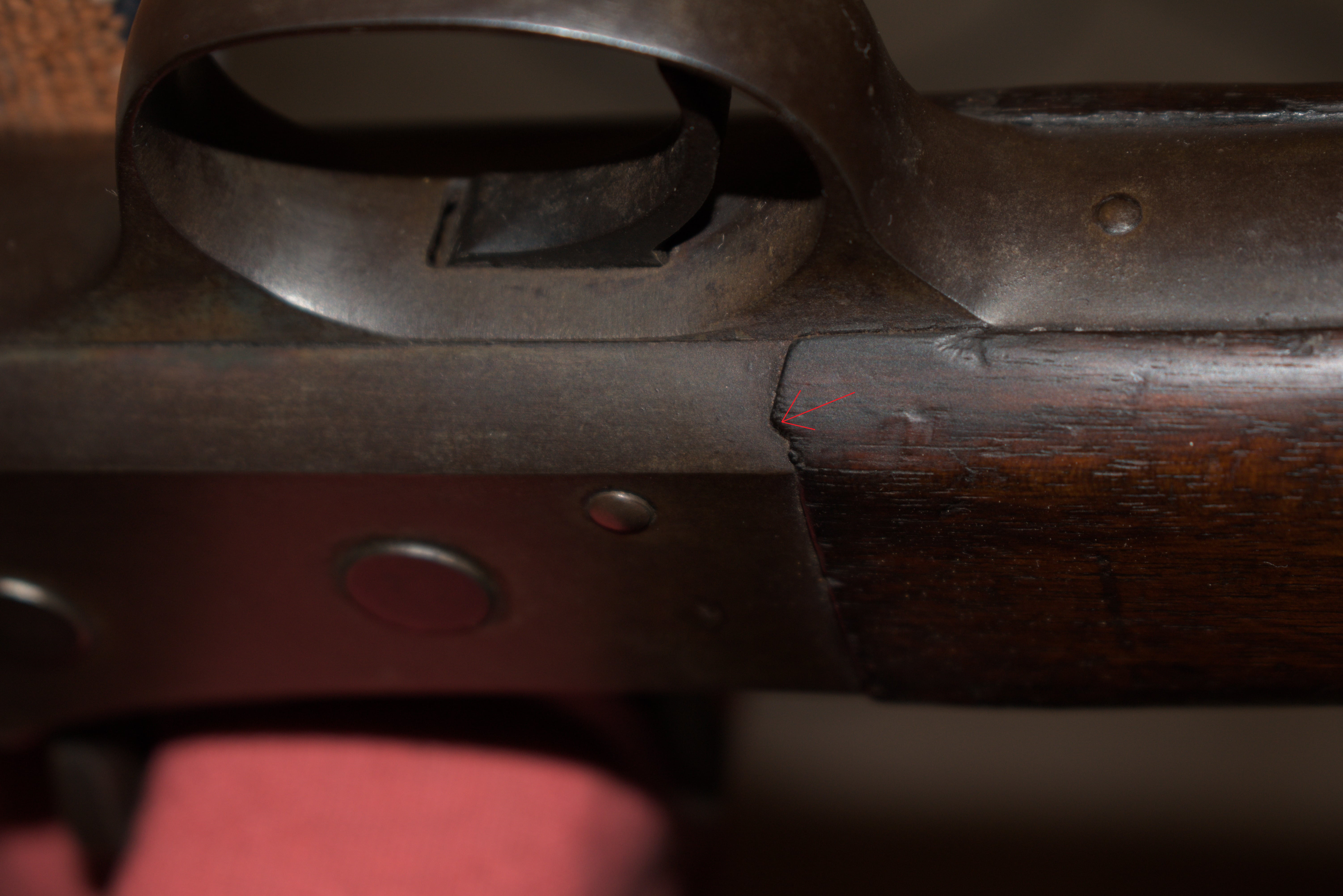

What is unusual is that your frame seems to missing the upper
matching lot number (or it is obscured by rust). Also, late
model frames had mortise cuts in the ends that butted against
the stock and I don't see them on yours.
Because your frame has the bar type extractor (the screw on the
left-hand side by the barrel), this indicates an earlier No. 5 frame.
No. 5's were made in both rifle and carbine types (carbines were
relatively rare). The bar type extractor indicates a No. 5 that is
either a 1896 or 1897 model.
Good Luck!
Webb
P.S. I updated the pics to better quality ones that show the mortises
better.

Thank you for the information. I'm just starting out with this Rolling Block. A quick cleaning of the upper tang does indeed show the same number. My plans are to have it built into a rifle, just not sure what direction I should go in obtaining a barrel or what caliber it should be. Thanks again

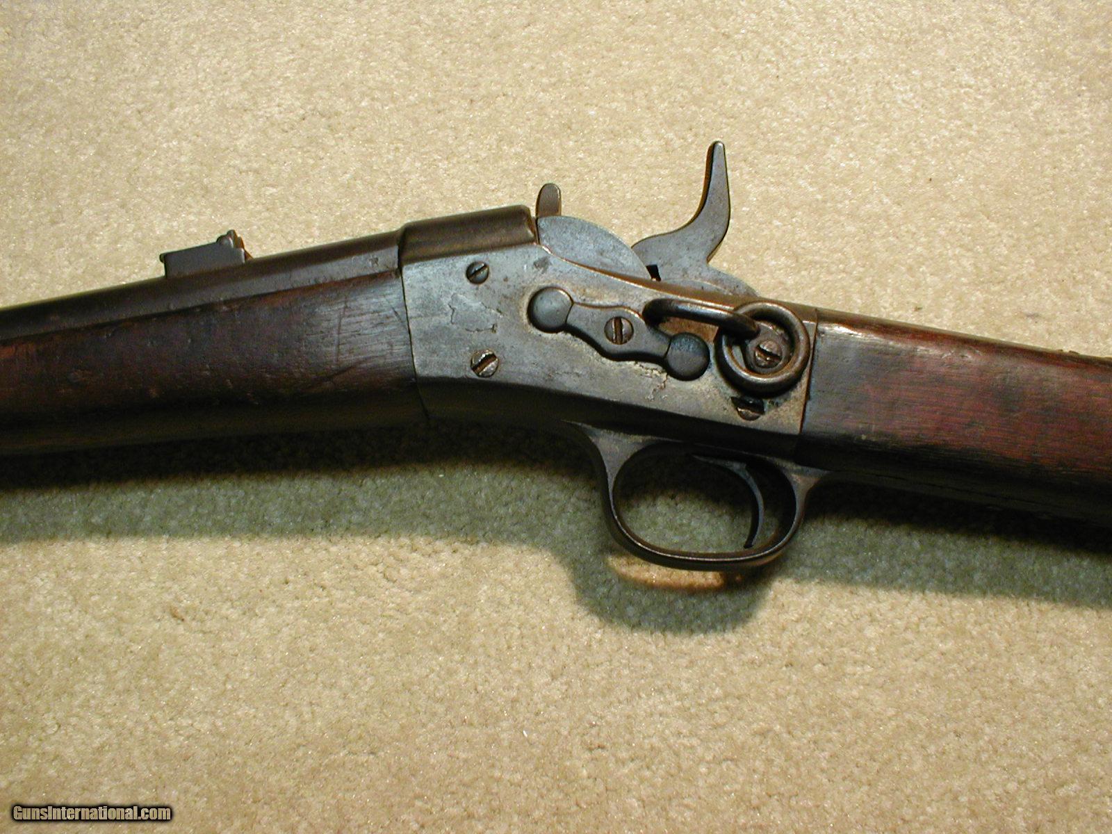

I believe this is your receiver. It would be a Remington rolling block saddle ring carbine, and I'd sacrifice body parts to get one.
Some version of these was carried by Custer and his men at Little Big Horn.

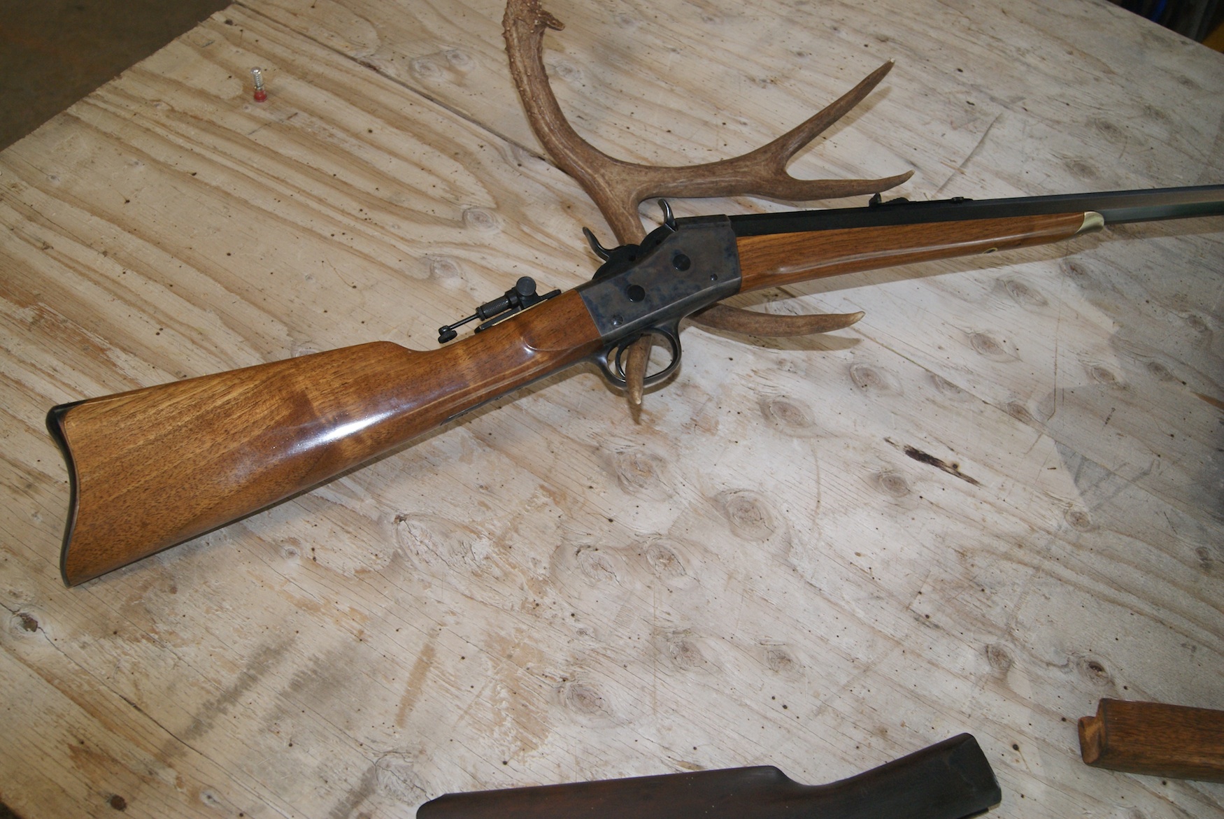

That's certainly a very nicely done build! It's always more fun shooting old guns that are pretty vs. ugly old guns.
I've rebuilt a fair number of Rollers from original sporters or military reworked to sporters.
The older sporters I own that are all original aren't really minty, but I leave them the way they are just to preserve the history. I kinda like both restored and originals.
I built this one from just an original Sporter action I found. It's in .40-65 Win.
Built this one in .40-50SS from an old military action, but using Remington parts leftover from the run they did in 1997. Sights, stocks, and lower tang are Remington 1997. Receiver is a Remington military, and barrel is a Green Mountain.

Re: Unknown Receiver
???????? Not sure what you mean Floop? That's not my receiver.
