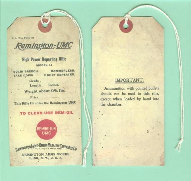

Hopefully attached you will find a picture of an original hang tag from
the Model 14 stating specifically "use round nose ammunition only".

Model 14 / 141 After Market Ammo / BULLETIN #14
- $_3.JPG (44.18 KiB) Viewed 3166 times
