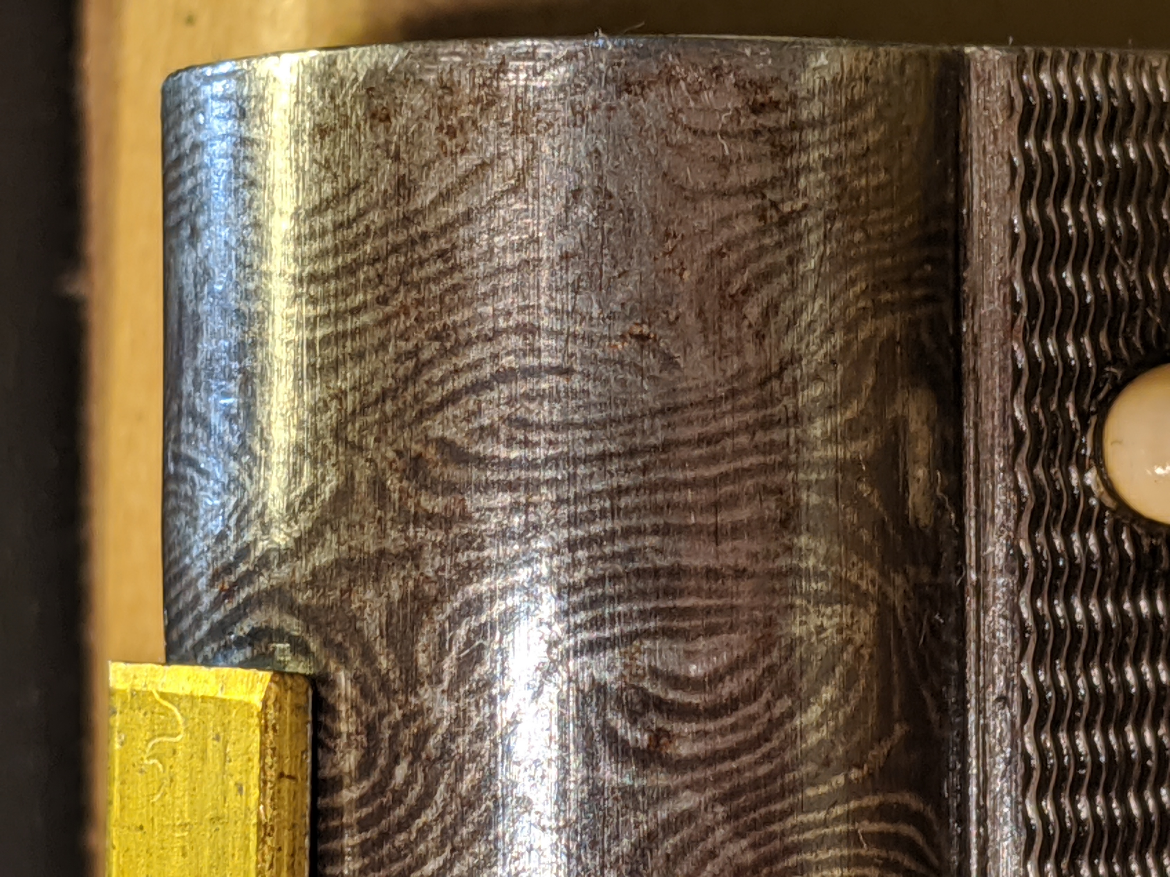

My 1894 AE left barrel has a slight bulge, stretching ID to (+0.720), 10mm from muzzle. ID at muzzle is +0.698. Bulge extends about 1/3 on barrel circumference. Ribs are tight, barrels ring sound. I intend to shoot this with BP quail loads, 2 1/2 drams. Any advice on the possibility of repair? Leave it alone?

Thanks for the reply and photo. Does the photo show a burst on initial round or after repeated rounds? My concern is that the steel is now work hardened and may give way even at low pressure?
I only just acquired this 1894. I have a number of Parker's and J.P. Sauer's with Damascus. This is my first Remington SxS. Picked it up for $200 due to the bulge and a missing top snap spring. Gun overall an NRA 95% IF no bulge. I replaced the TS spring. I have had dents raised but this is my first experience with a bulge in Damascus. I reload and shoot only black powder in all my black powder era firearms, both shotgun and rifle. I have added a couple of photos. Serial #111xxx. Sent from my Pixel 3 using Tapatalk

The shooter had used the Parker 6 Iron "Turkish" AH regularly, until noticing the fracture at the muzzle along weld lines.

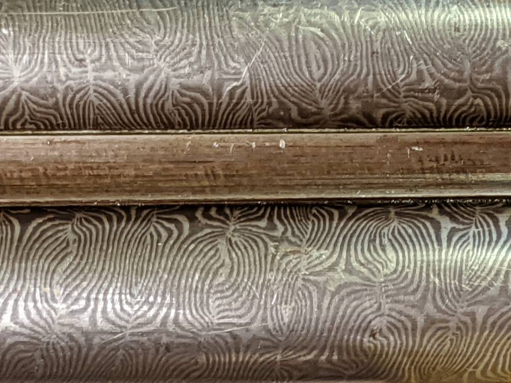

Your A grade barrels are “Two stripe Damascus” which Remington called "Oxford 2 S.J." We don't know who "S.J." was but likely the tube maker and possibly Simonis-Janssen

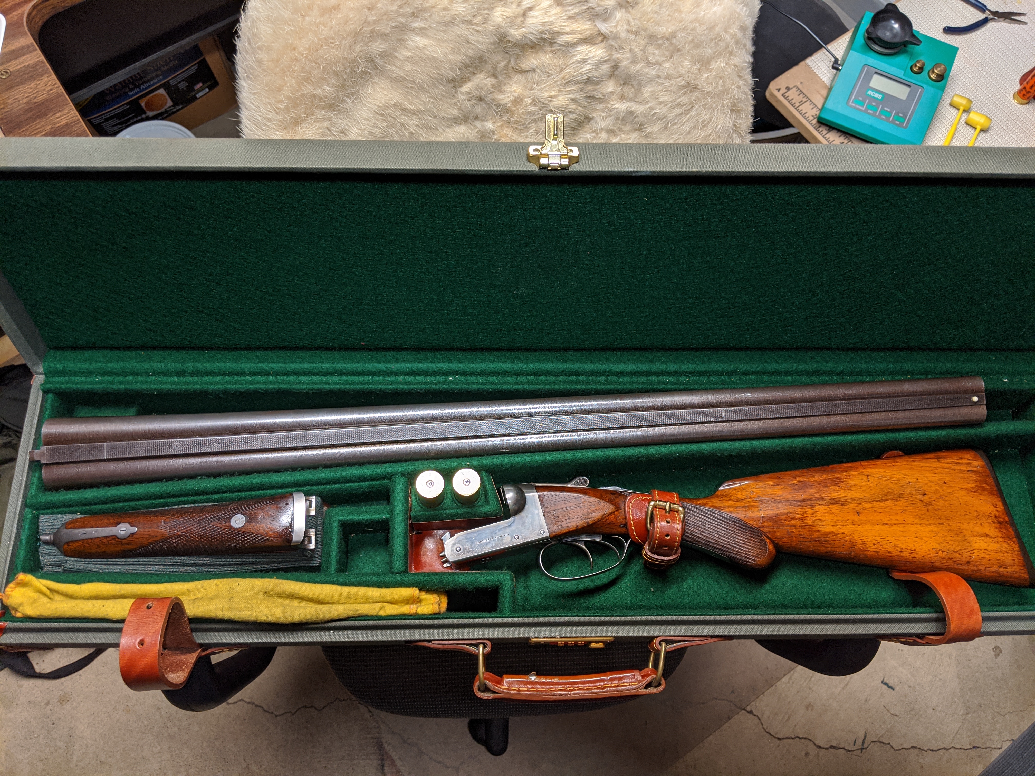

Thanks. To all who provided helpful responses. Went to my skeet club today and patterned the gun. Good tight patterns for both barrels. Stamps on barrel lug are 342/350. Slight bulge in left barrel showed no disernable impact. I have attached a photo of gun in its case. Now ready for quail.
For those interested, this AE has these non-standard features. This is an ejector gun, yet there is no E on the barrel stamps. The rib is flat with two ivory beads. All parts, large and small have correct matching numbers. The serial number of 111422 puts the date of manufacture as 1899. Thirty inch Barrels weigh 3#-11, frame with stock 3#-5. Overall with forend 7#-11. By comparison my Parker GH 30" barrels weight 2#-9.
