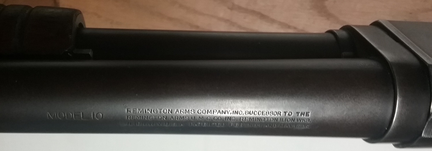

On the Model 10, by 1921 they were being marked like this --
207380 01 Model-10 Successor To.jpg (155.76 KiB) Viewed 5235 times
Unfortunately the first page of Model 17 production from the old between the wars factory ledger isn't included on this web site. Page 2 begins with January 19, 1926, at serial number 35639.

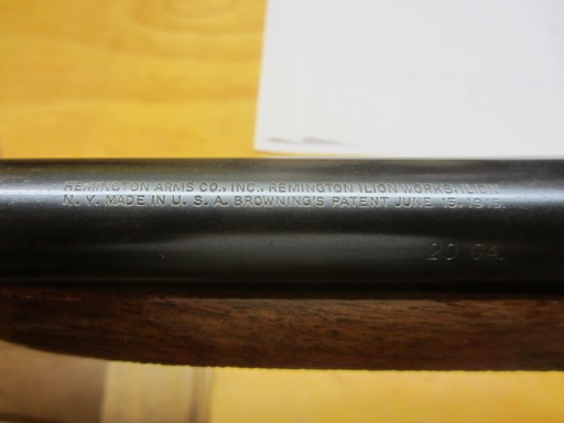

Post by AZMike »
Remington Model 17 #63395
Re: The Remington Arms Union Metallic Cartridge Co. Inc.
Thanks. That is one more data point! More?
Post by Jack71 »
The barrel markings on my Model 17 #54443 are identical to those on AZMike's gun.
