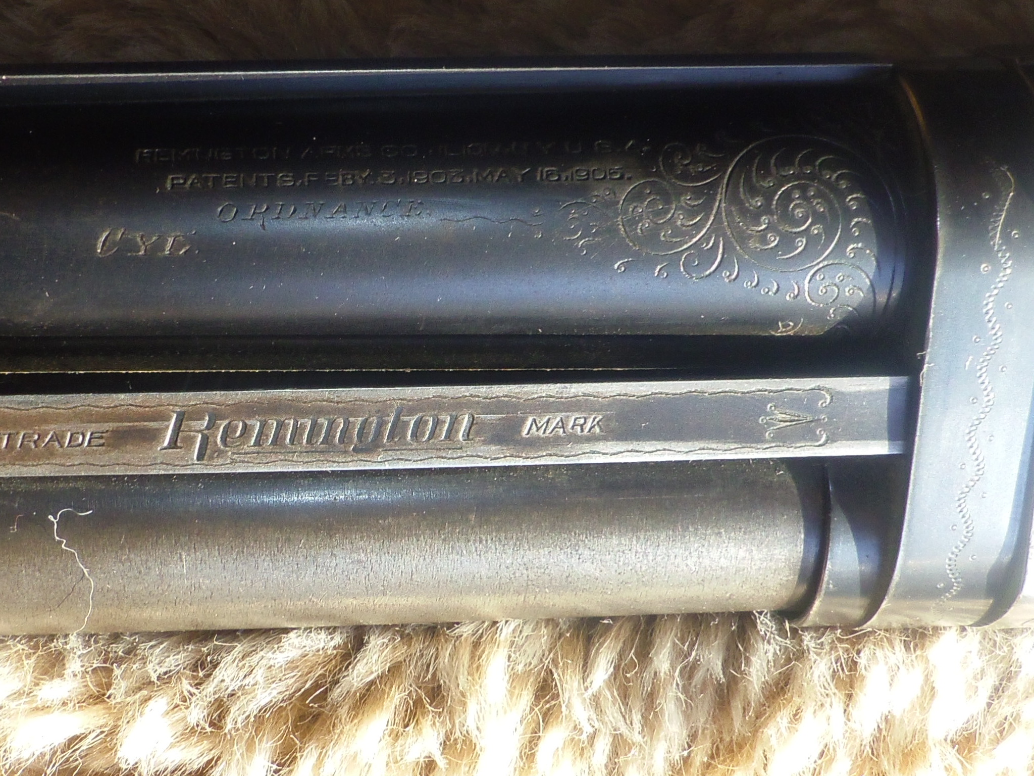

Ordnance Barrels on Model 10's are as scarce as Damascus on a '97.

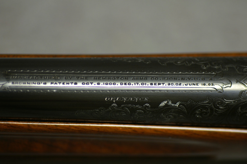

Even less common on a Remington Autoloader.
