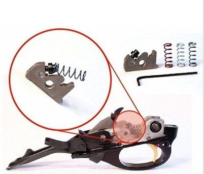

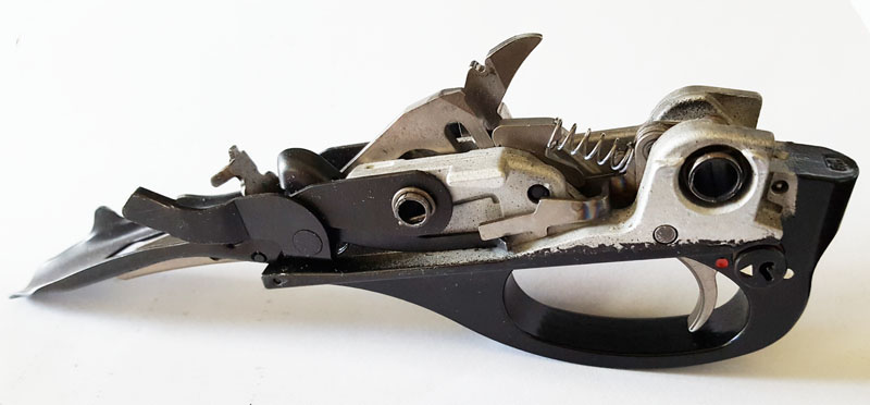

Here's a couple photos that may help show what I am looking for...
Comes with Red (4lb), White (3lb) and Blue (2lb) sear spring in order to obtain the perfect pull weight for your particular application. Trigger Spring Kit is constructed of the highest quality spring steel available, ASTM A228 music wire and is made right here in the USA. (also works on the Remington 1100, 7400, 7600, 742 Semi-Auto, 762, 74 series, 750, and 878 long guns" White spring shown...
Original spring has 9 coils and is longer. Will try cutting to .605" and test results. Will report !
- This is the Timney Kit with 3 springs. 4,3 & 2 lb pull
- spring.jpg (89.2 KiB) Viewed 8203 times
- Screenshot at 2018-04-16 23-54-08.png (153.8 KiB) Viewed 8203 times

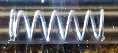

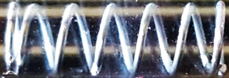

If you're reading this... you have probably done the same thing I did... and been unhappy with the results. I have tried every spring offered by major suppliers Midw- MG- Brown- and on and on. Every one says they have a light pull spring. Most are only a pound or two lighter than the HEAVY 7lb factory spring. When they have 9 coils and the wire size is about the same... what can you expect.
A major trigger manufacturer sells a kit to replace sear & spring. But very costly if you have many to do. I had 11 shotguns to fix up. I wanted them to be the same.

- trigger group.jpg (60.31 KiB) Viewed 8165 times
- image002.jpg (150.59 KiB) Viewed 8165 times
