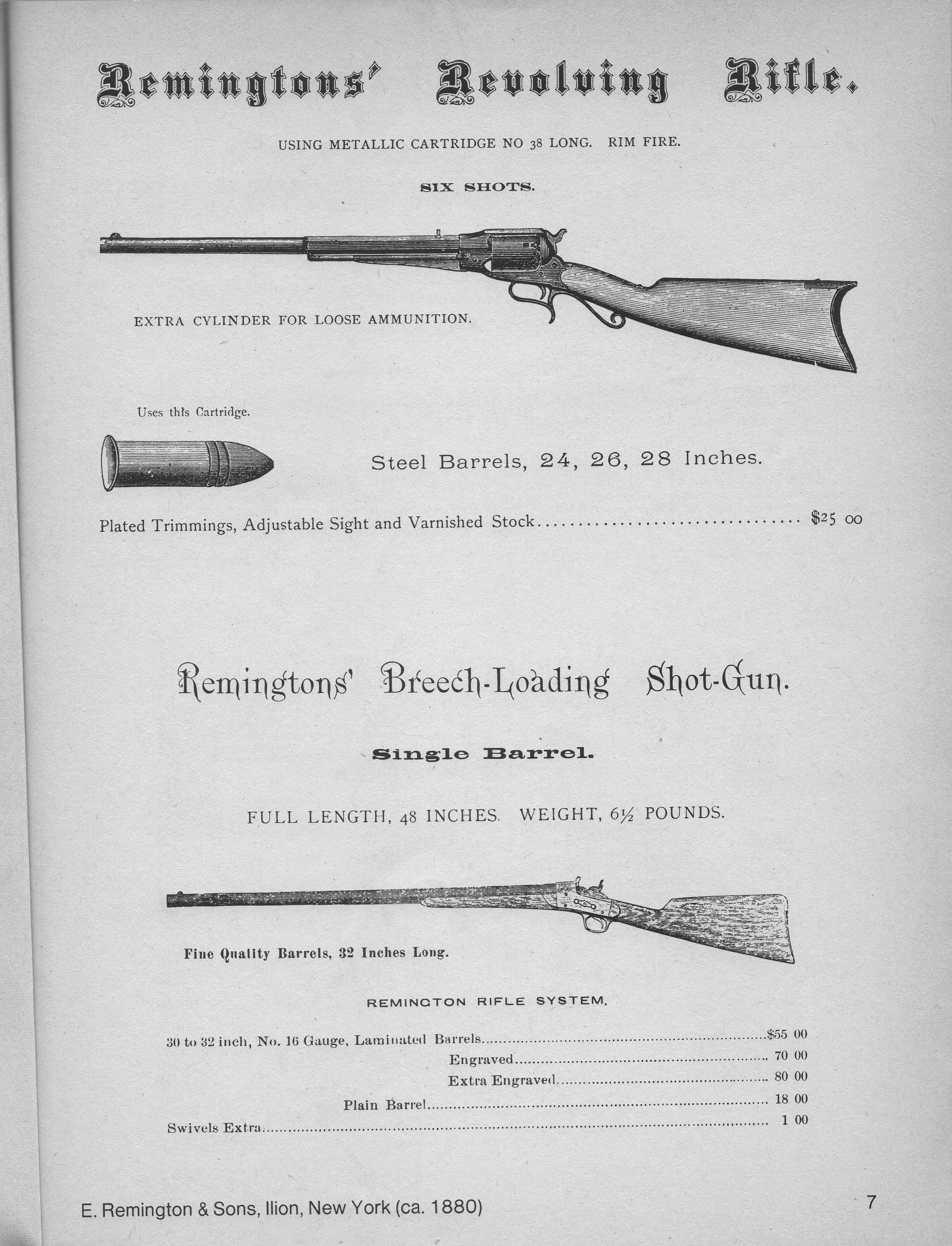

Hi There,
Just to reiterate, I have a 1877 Remington catalog
reprint and in that catalog, the rolling block shotgun
was available. Here is a scan of the page:
Here is a scan from an 1880 Remington catalog:
Good Luck!
-Blue Chips-
Webb
Good Luck!
-Blue Chips-
Webb
Re: Rolling Block Shotgun?
Hi All,
I have the early sporting model shotgun. It is marked E. Remington & Son's with patent dates on the upper tang. The receiver measures 1.23" the same as my #1 rolling block sporting rifles. It has the longer lower tang trigger guard that has the sporting model contour, sighting groove on top of the receiver, sporting breech block and hammer, half moon panels on the butt stock and forearm and steel shotgun butt plate.
The barrel is 34".
I believe the shotguns made with military actions, barrels and stocks were made after 1886 when
E. Remington & Son's were out of business.
Thanks wlw-19958 for posting the catalog pages.
