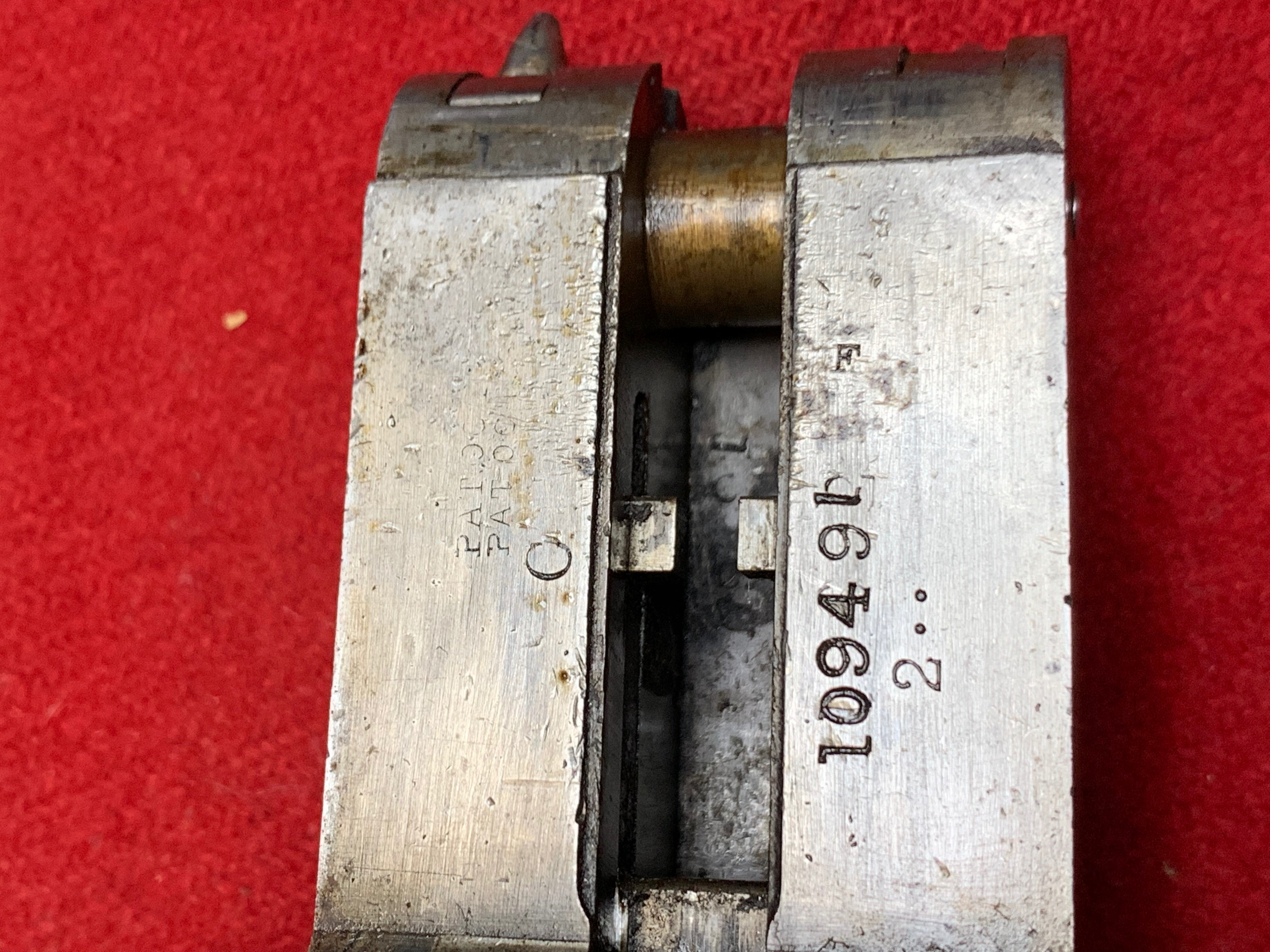

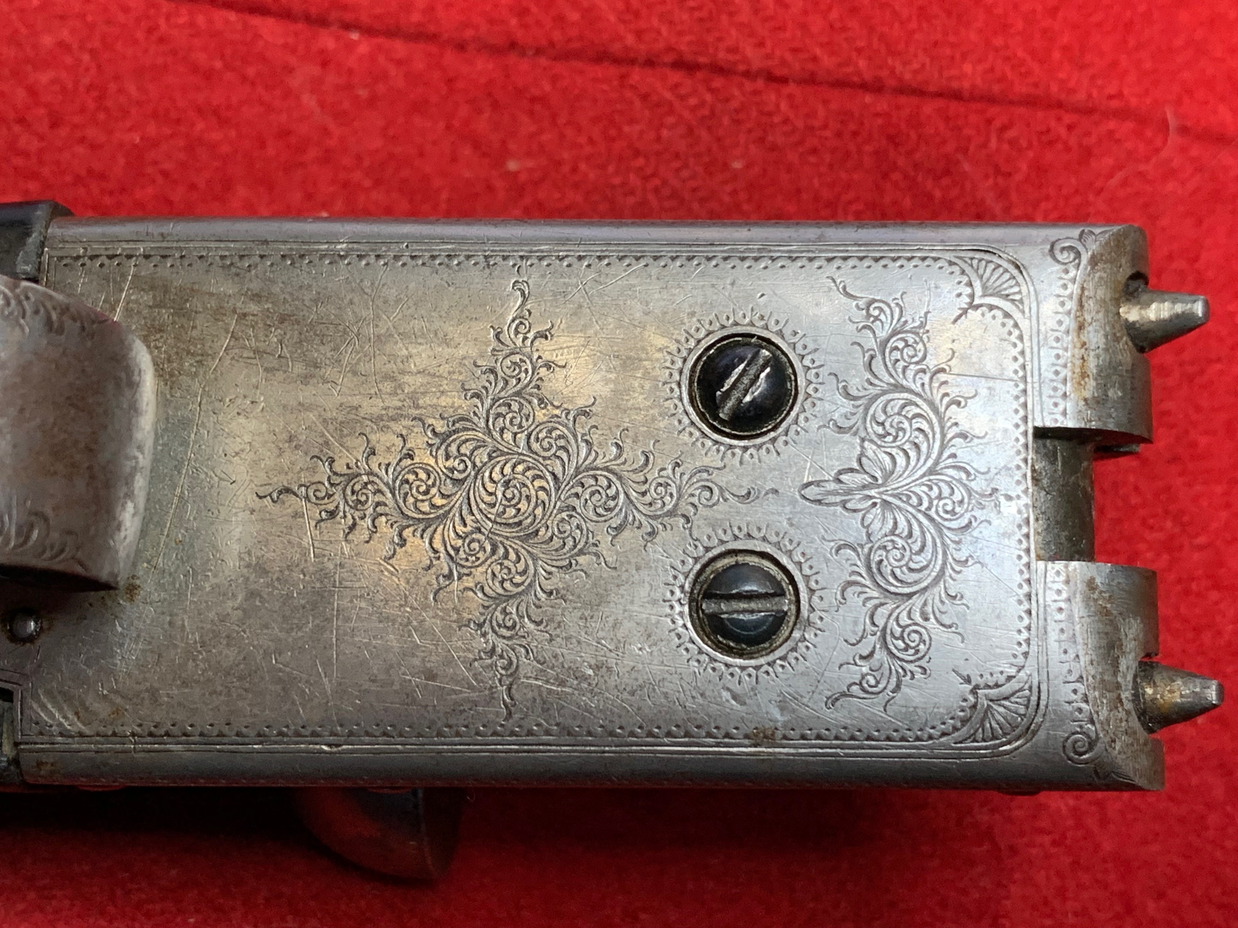

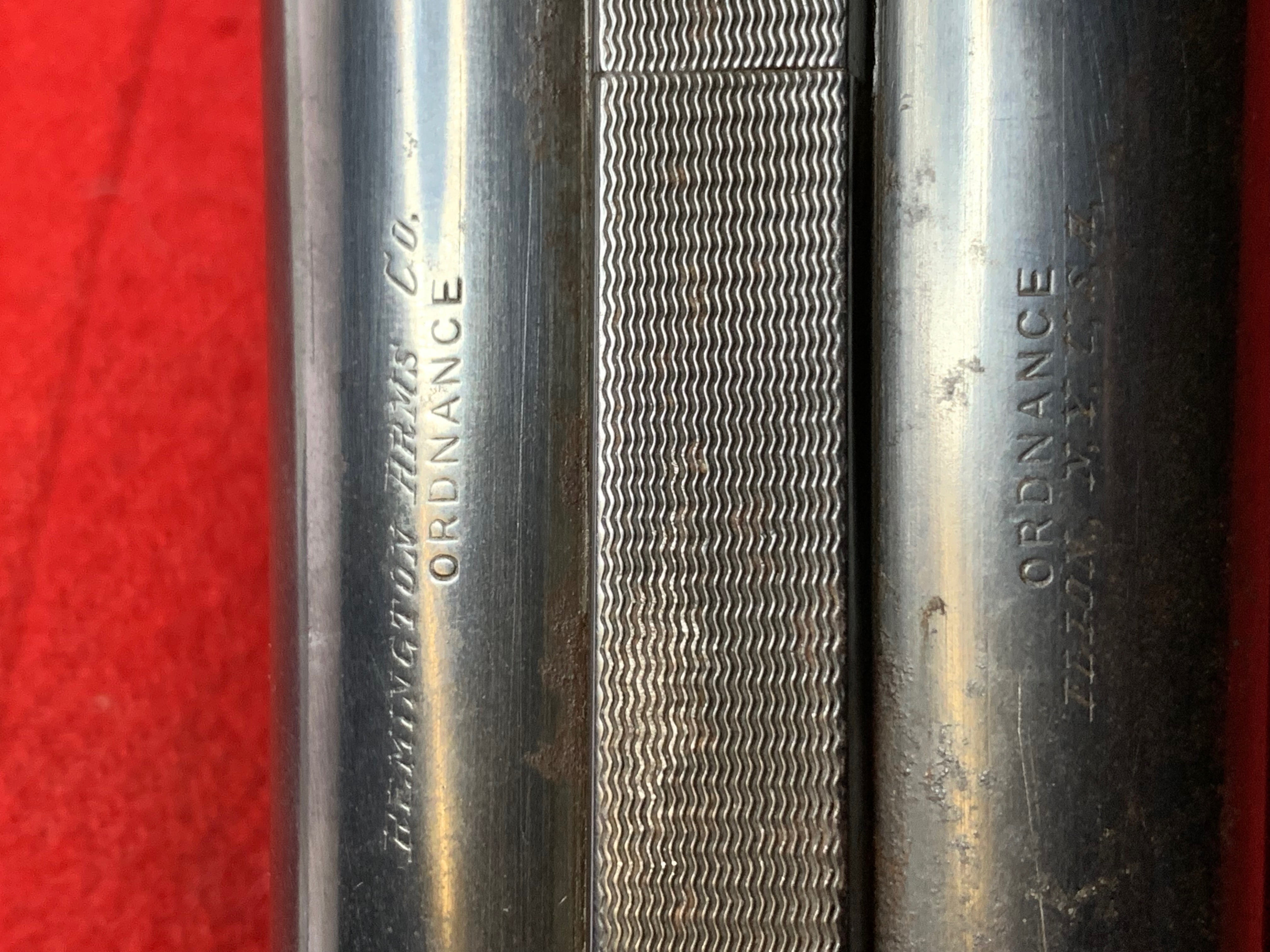

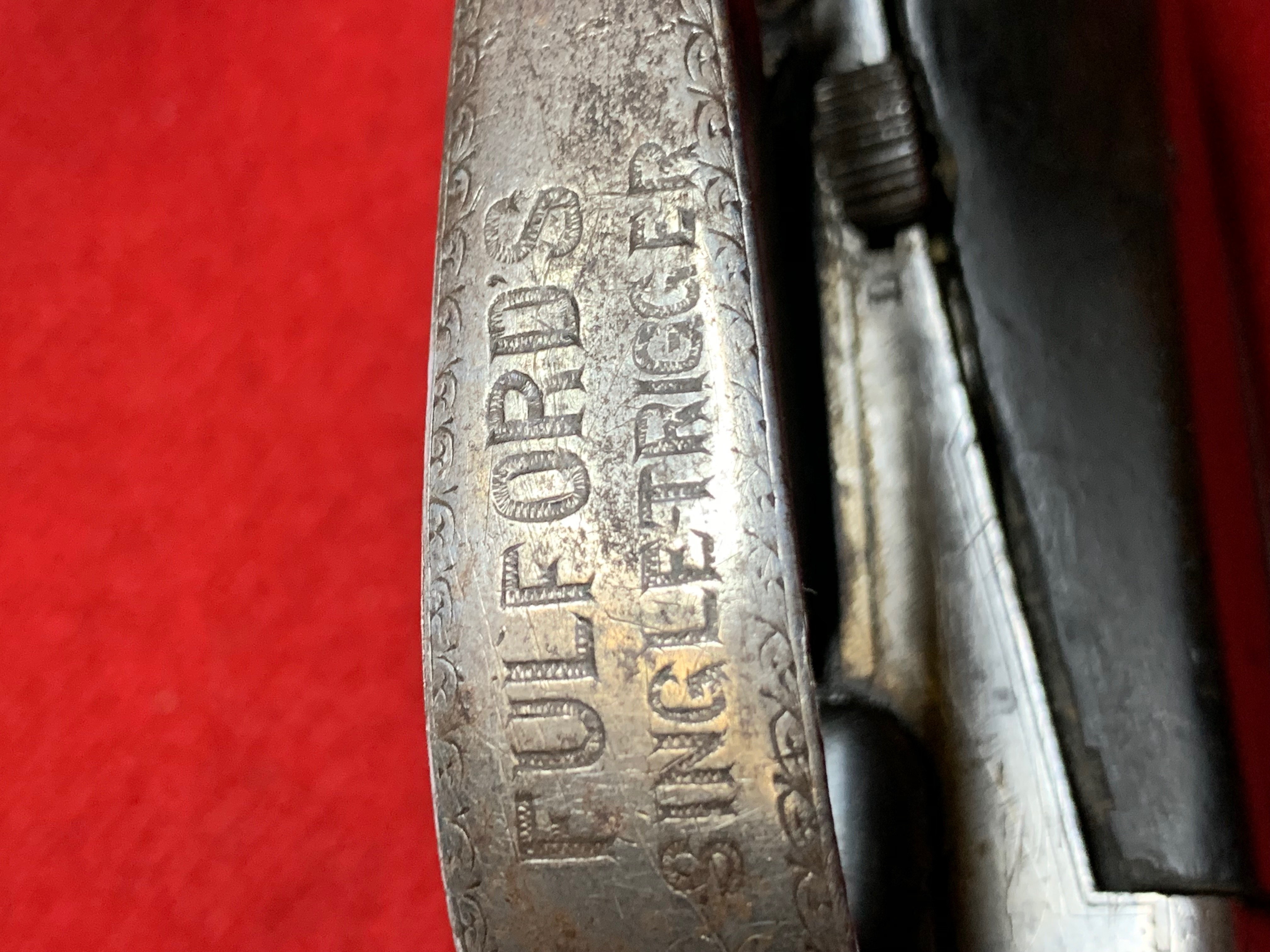

Happened across this so just had to have it,
But what is it ?
Trap guns didn't have safety's or so I'm told
The single trigger is an oddity as well ,
Ordnance barrels ?
FE grade C
Can any one help me figure out what this thing is ..
30" barrels
English stock
7lbs 14oz
added a few photos
Thanks for your help
But what is it ?
Ordnance barrels ?
FE grade C
30" barrels
English stock
7lbs 14oz
added a few photos
- IMG_1995.JPG (2.19 MiB) Viewed 14228 times
- IMG_1989.JPG (1.81 MiB) Viewed 14228 times
- IMG_1997.JPG (2.12 MiB) Viewed 14228 times
- IMG_1994.JPG (2.1 MiB) Viewed 14228 times
- IMG_1992.JPG (1.83 MiB) Viewed 14228 times

The gun is marked as a C quality gun, and has Ordnance Steel barrels, so probably a CEO-Grade. E.D. Fulford was a shooter and inventor, and won the 1898 Grand American Handicap at live birds shooting a Remington Hammerless Double. The serial number on the gun in question dates it to 1898, according to the serial number chronology in the late Charles Semmer's book Remington Double Shotguns. It appears from your pictures that part number 27, the Joint Check, is missing off the knuckle of the gun --

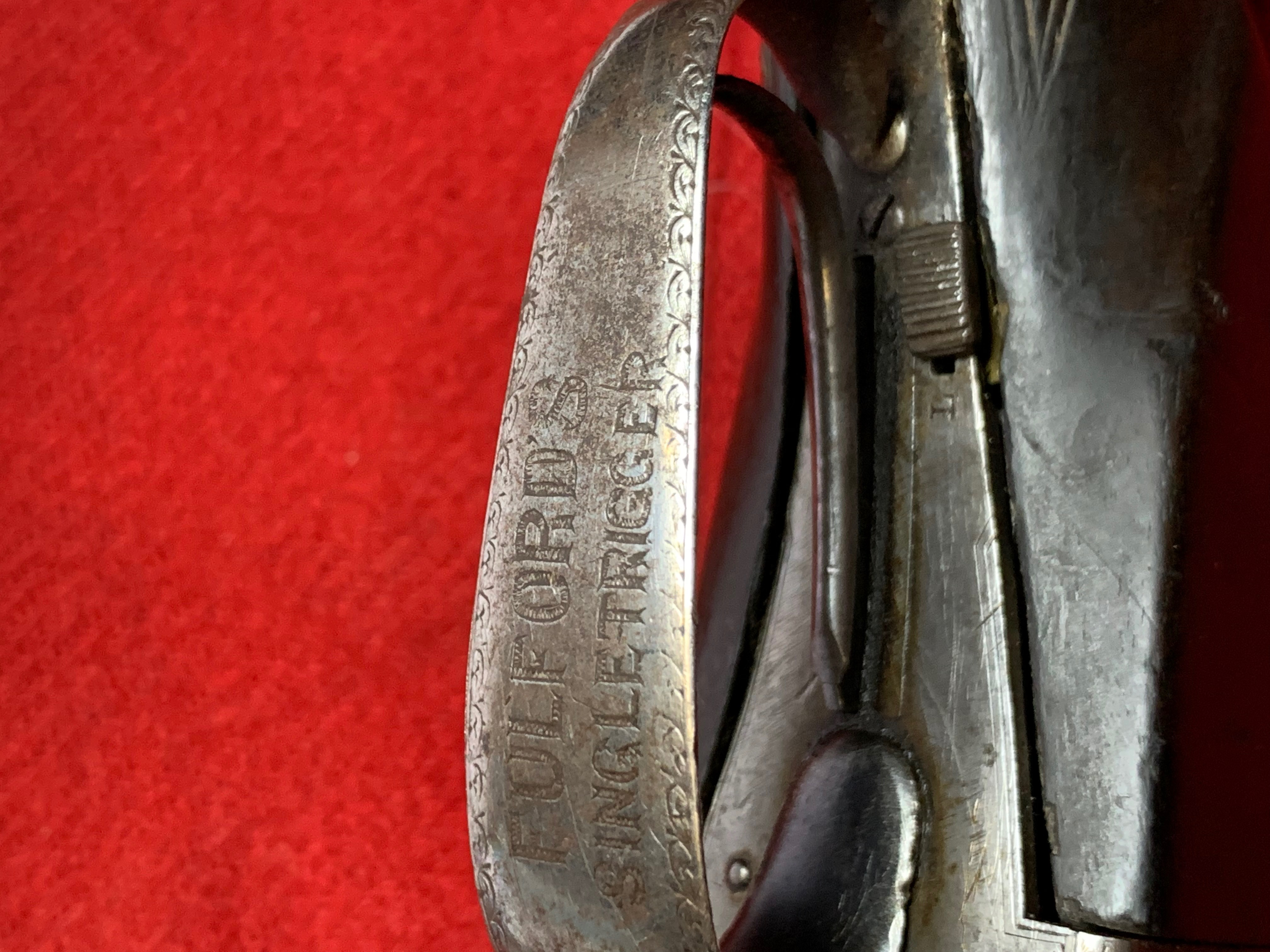

Elijah D. Fulford had four single trigger patents -- Patent No. 704,024 granted July 8, 1902; Patent No. 704,025 granted July 8, 1902; Patent No. 749,687 granted Jan. 12, 1904 and Patent No. 751,979 granted Feb. 9, 1904 -- all with drawings showing the trigger on a Remington Hammerless Double. This magazine ad from January 2, 1904, shows his trigger on a Parker Bros. --
While I'm sure Remington Arms Co. made no-safety "Pigeon Guns" to customer's order throughout the production run of the Remington Hammerless Double, they only advertised a "Pigeon Gun" in the 1902 catalogs --
and in those the gun pictured shows a safety slide?!? The last GAH at live birds was held at Kansas City in 1902.
From the 1903-04 Remington Arms Co. catalog onward they offered the "Trap Gun" --
In 1906 they added the lower priced FE-Grade "Trap Gun" to their offerings.

Wow Nice so it’s neither it’s just a CEO grade with a single trigger ,
And an English stock ,
Nice catch on the knuckle , it appeared to be missing something couldn’t put my finger on it.
So with that missing would be issue I see with ejectors being weak ?
Thanks for the information ,
Ken
Ken

Re: Pigeon Gun ? or Trap Gun ?

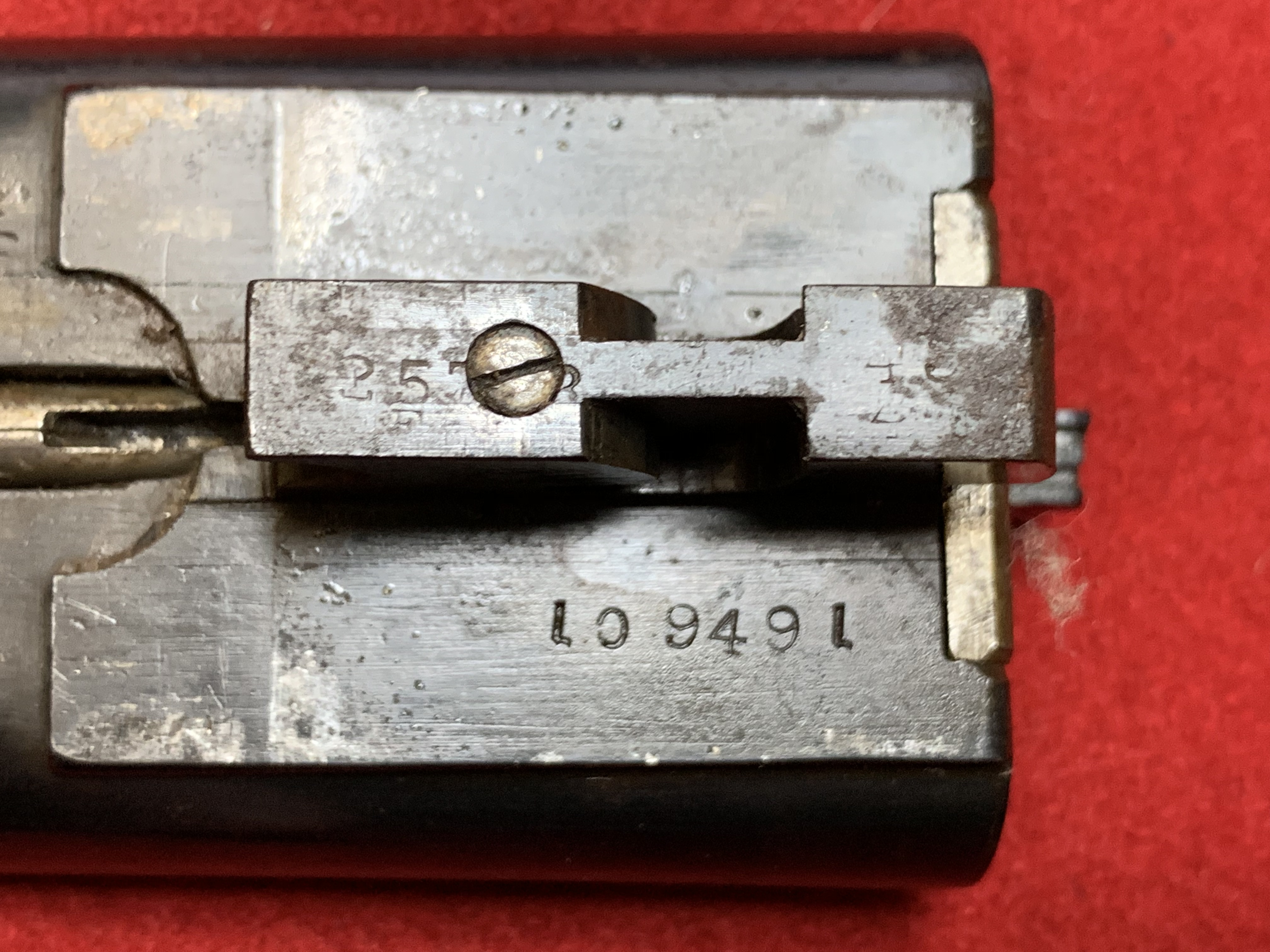

English style stocks were offered with both Trap and Pigeon grades. All others grades had standard pistol grip style(s) stocks unless special ordered from the factory.
If there is no safety you have a Pigeon grade with single trigger added. If there is a safety, it's a CEO.

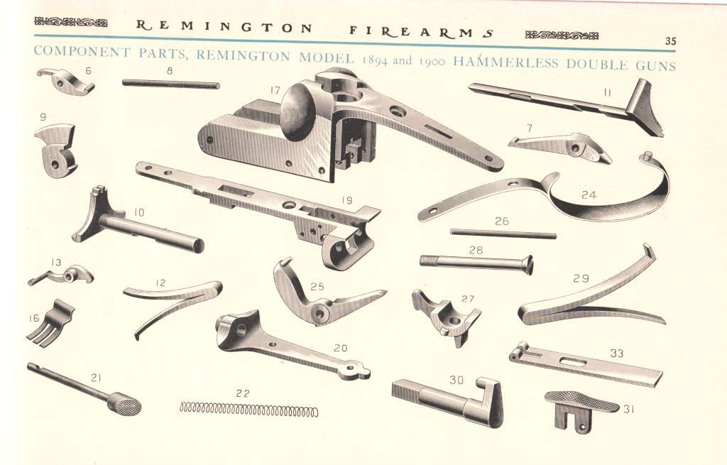

In addition to the missing joint check, it appears that the trigger plate screws are not proper as they appear to be round head rather than engraved flat head.
I don't think the missing check joint would affect ejector operation. Most likely weak or broken ejector springs in the forearm. Another possibility is weak or broken main spring since the end of the main spring trips the ejector sear when the gun is fired. No contact - poor ejection
There are members that can help you with needed parts.
Also I see a 2 stamped under the S/N on the watertable. Any idea what that might mean?
More pics would help as this appears to be an interesting example.

The missing joint check means the ejectors are doing all the work of extracting and ejecting the fired case. The joint check will push on the ejector stems to do the initial extraction, loosening the case, allowing the ejector to then kick it much farther.

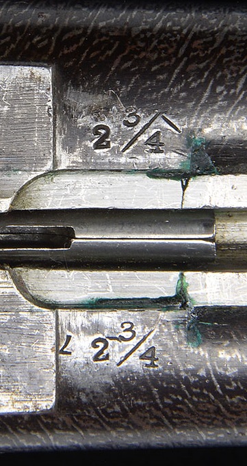

M1tankgod

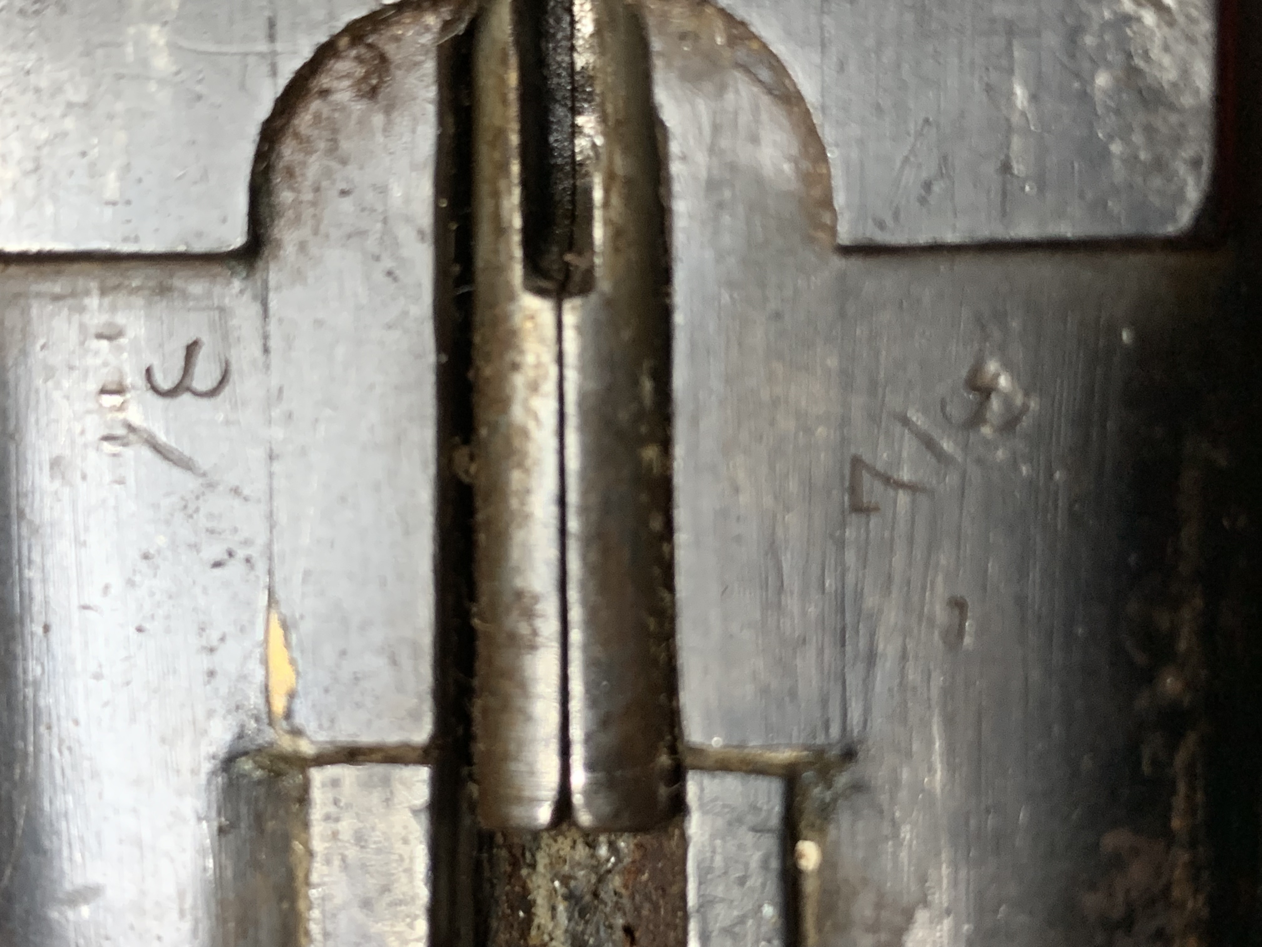

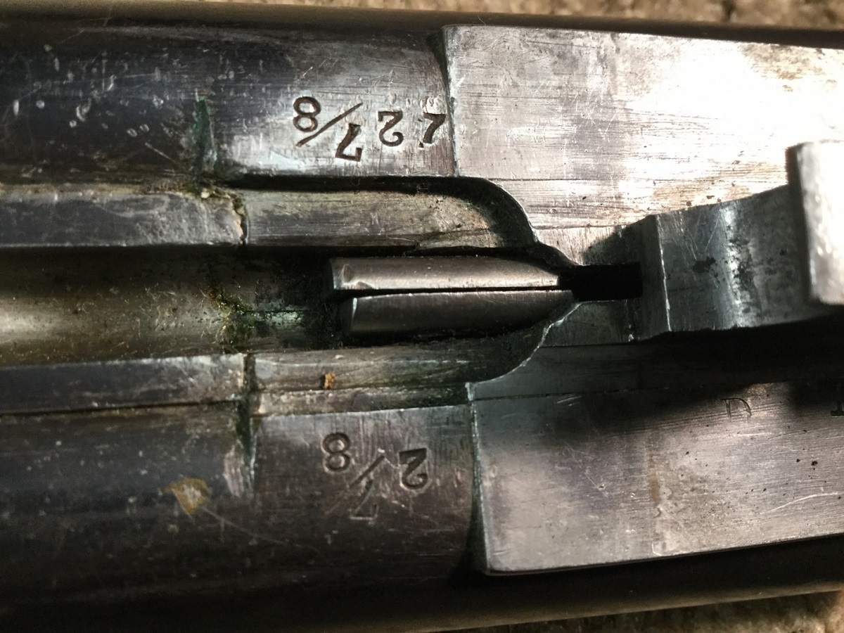

Here is a picture of the barrels I will take another when I get home this evening, marked. 2-7/8 inch
I know that the markings on the barrels are not like any of my other Remingtons showing shot count , on the rearward locking lug it has the word full stamped in it
What would be the odds that this is the gun Fulford used ? would be incredible if it was and could be documented
Thanks for the great information
I might learn more when I start to get it back into working order and uncover the working parts
Ken
Ken

- Posts: 1181
Looks like the barrels were originally stamped 2 7/8 but the stampings have been somewhat polished away in prep for the one, or more, rebluings those barrels have had. Can you measure the chambers and see how deep they are? While I have saved pictures of barrels with the 2 3/4 and 2 7/8 stampings, I've never had a chance to measure the chambers in such a gun. Of course there is the good possibility the chambers of any of these Remington Doubles have been messed with in the 110 years or more since they left Ilion.
There is also the question of what these stampings mean. Do they mean the gun is intended for shells of that length? Does it mean the chambers are that length? Some of our manufacturers (Parker Bros. and A.H. Fox Gun Co. for sure) held their chambers 1/8 inch shorter than the intended shells, believing that having the case mouth extend a bit into the forcing cone when the shell is fired cushions the transition, gives a better gas seal for the wads, and improves patterns.
P.S. There is a lot of variation in the diameters of the chambers in these old guns at the mouth and the machinist ruler method is often more accurate than using a gauge made to modern day "industry standards."
Drew Hause
- Posts: 113
- Joined: Sat May 25, 2019 12:08 pm
- Location: Arizona; heart in Kansas
- Contact:
That is a good point.
Wm. Cashmore Pigeon gun marked "3 1/4" CASES". Unfortunately, I don't know the chamber length
1923 L.C. Smith "CHAMBERS 2 7/8 INCHES"
