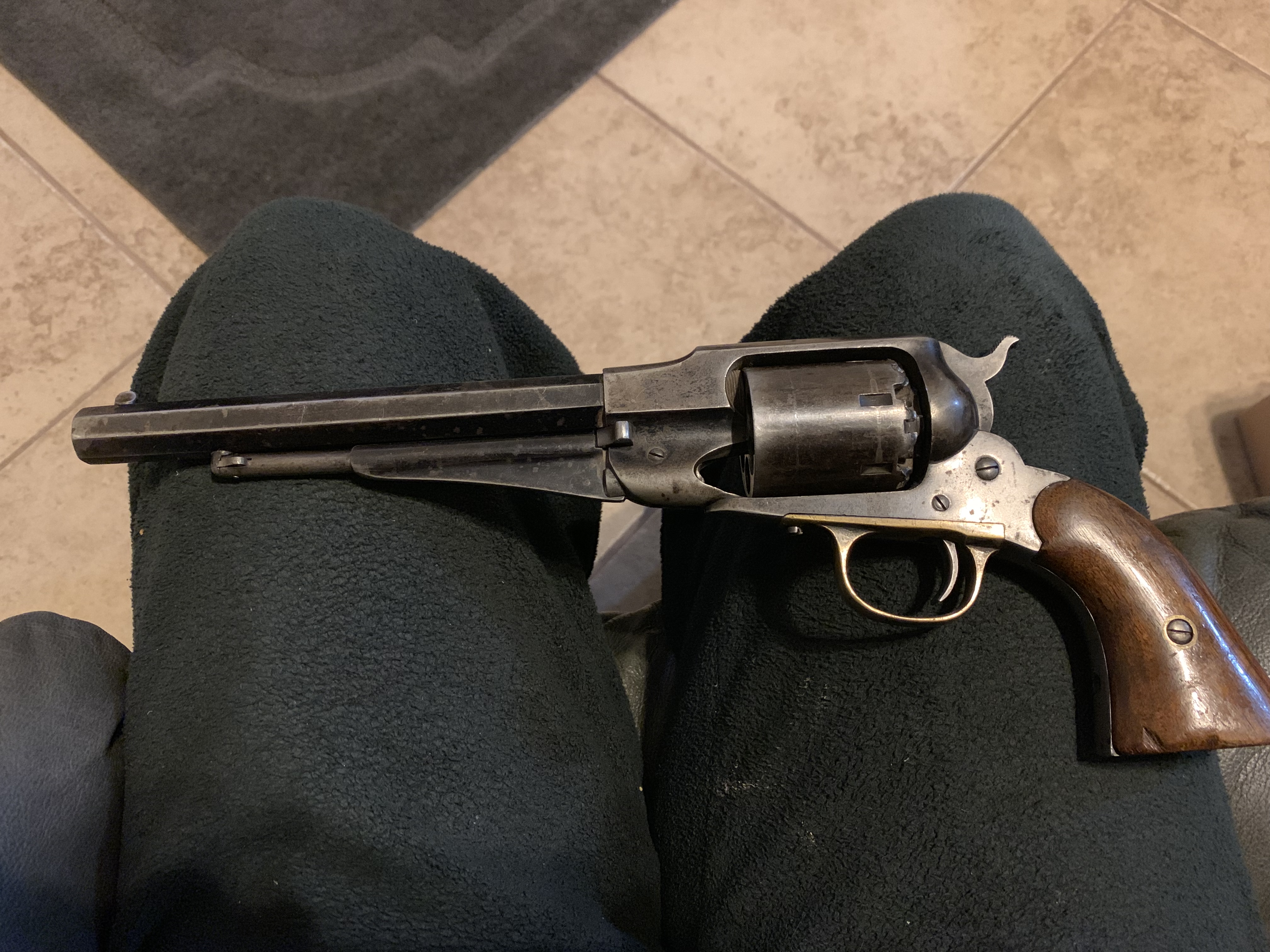

I have a gun that has been passed down in the family for years. It is a Remmington .44 cal, patented Sep14,1958. The serial number on the barrel is 144624. I'm wondering if anyone would have any information about this weapon. Any help would be appreciated.

Welcome to the forum. Pictures are always better, but may not be needed this time. The serial indicates that it was made in March 1865. If it was accepted by the US, there will be a single letter, inspector's mark on the bbl, frame, and loading lever. It will also have an oval cartouche with initials, in the left grip panel. If these marks are absent, the gun was for civilian sale.

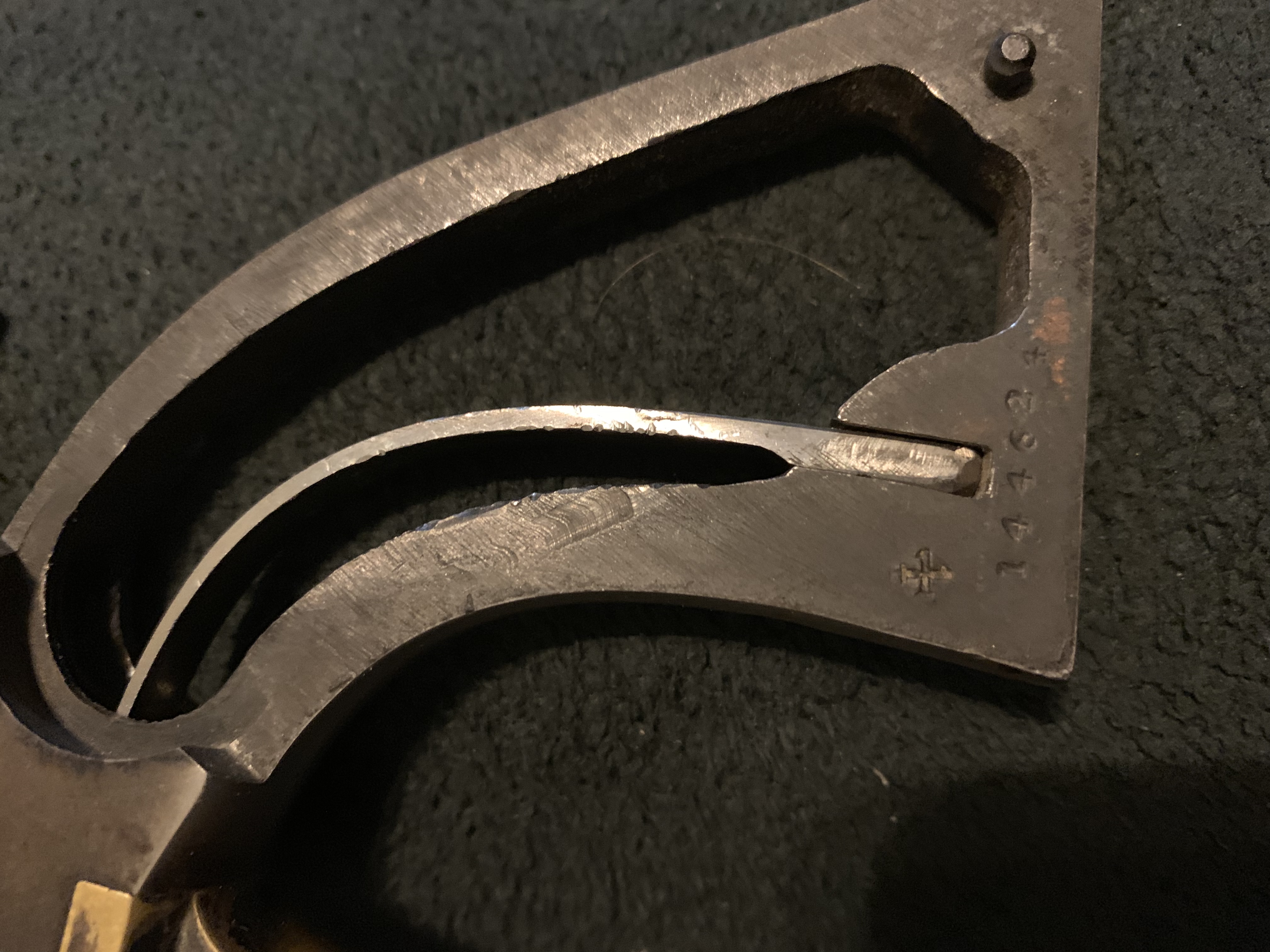

Here are pics of the gun and inside the left grip panel.
There is pencil writing on the inside of the grips if that could be any help. "45" on one and "697" on the other.

Thanks for the photos. That's in nice condition. Forgot to tell you that the gun is a New Model Army. I can't see any inspector's marks, nor a cartouche on the left grip panel. The pencil number on the inside of the grip panels should be the last 3 or 4 digits of the serial number. Often the grips were fitted to the gun, so they were numbered to make sure they got back on the right gun.
Does the barrel number match the frame number? The number will also be on the tab of the trigger guard. Are the nipples missing?
The trigger guard screw is either unscrewed and about to fall out, or it is the wrong screw. Replacement screws are available, try Dixie Gun Works.
Dan

At a closer (much closer) look the grip panel numbers are indeed 3 digits of the serial number.
Yes, the barrel number and the frame number do match.
Yes, the nipples are missing. Also, the cylinder rotates freely so I guess there is no cylinder stop is missing. Are those sold also?

The internal parts are available. Is the cylinder stop missing, or is the spring missing? Visual inspection should tell you.

There is a double sectioned flat style spring under the trigger guard. One side works the trigger and the other does the pawl that controls the cylinder. Typically the side that works the cylinder breaks off. This allows it to rotate freely and not lock up properly when cocking.
