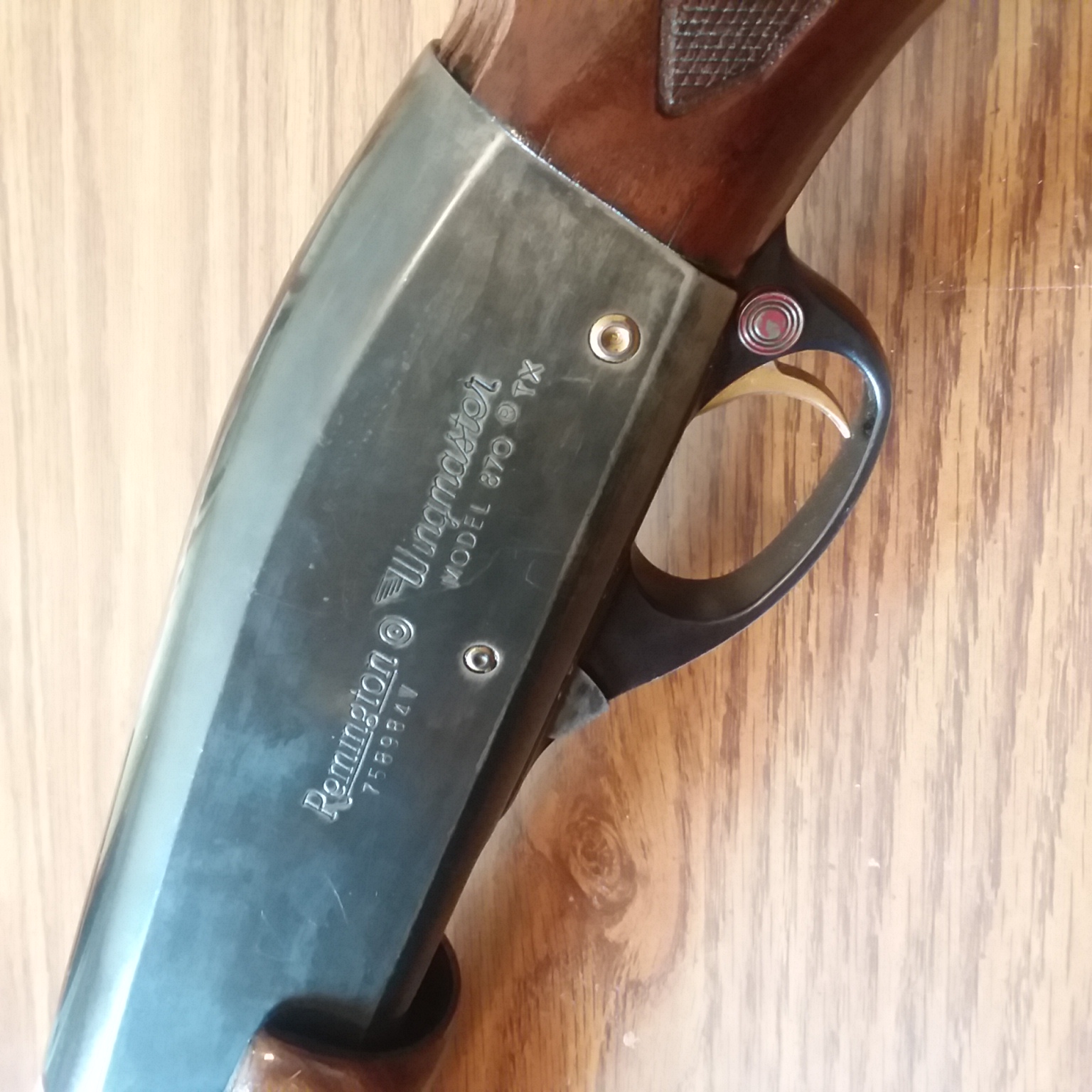

I suppose it's worth the $180 I paid for it today at the gun show.
870 TX

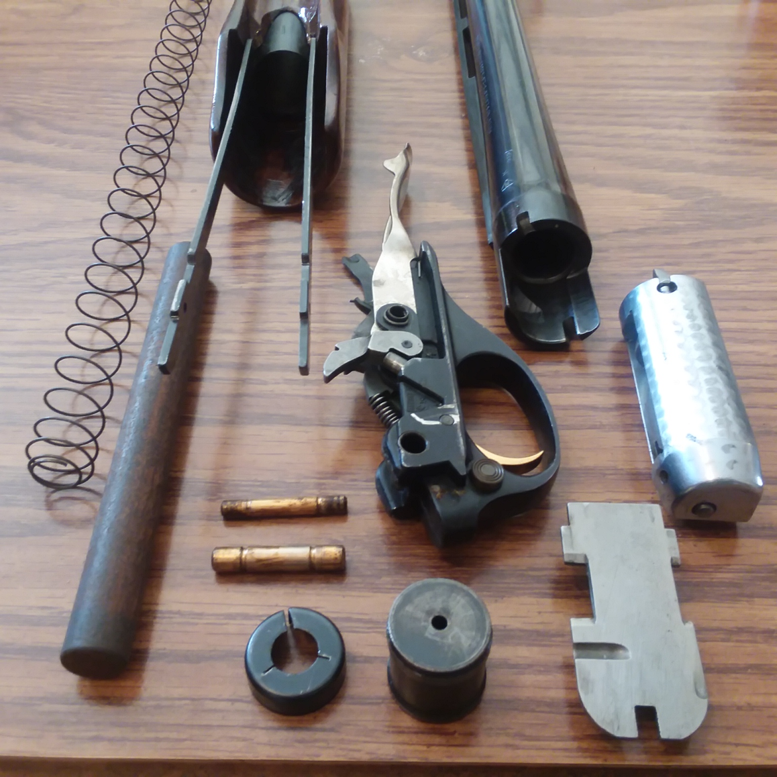

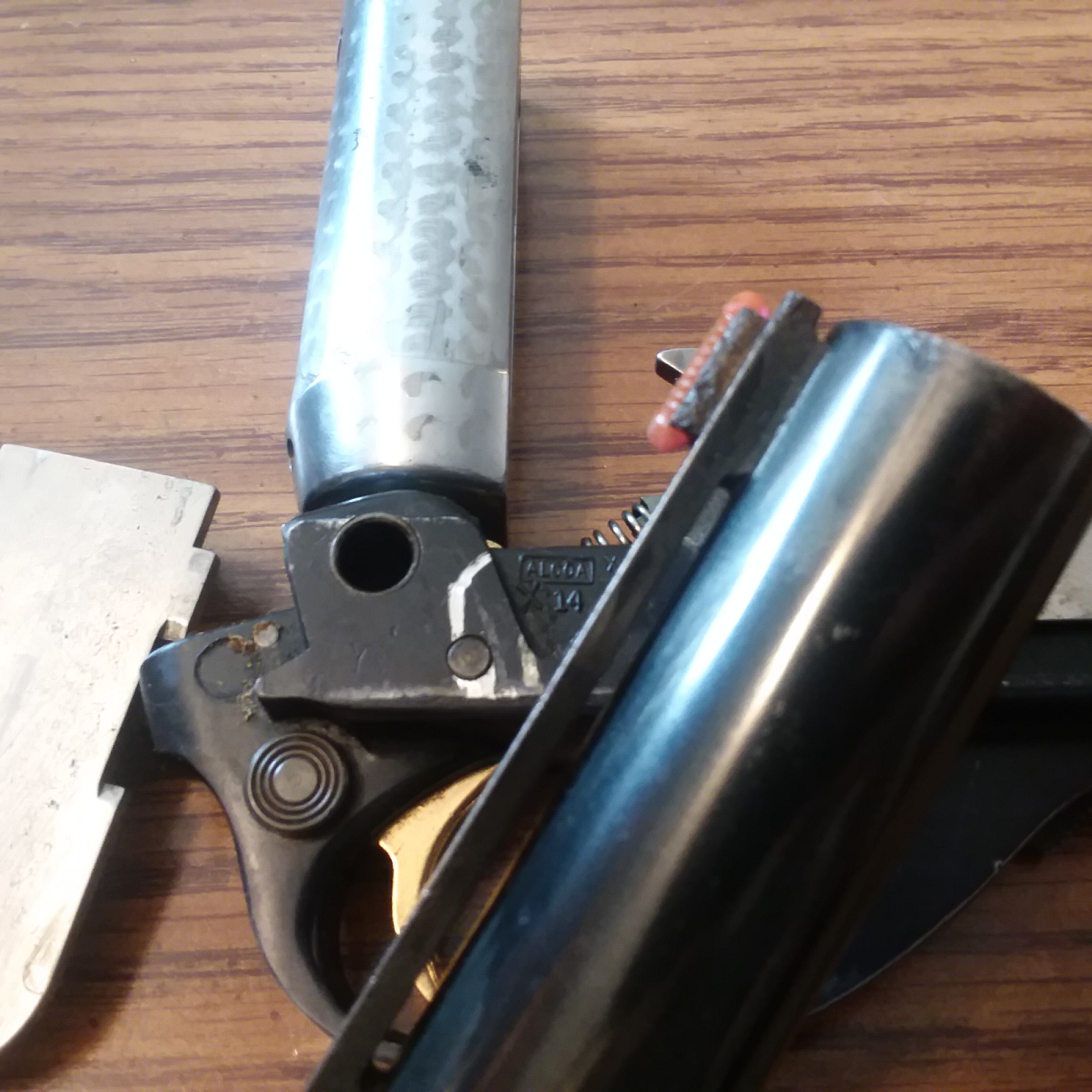

Gold pins and trigger. Jeweled bolt, not sure if that's original because it was buffed through the chrome. Straight wooden plug, steel follower. Action bars striking an immodest pose. Forearm is solid through the top, not split like later ones, since they all crack there anyhow (yes, its cracked and glued, hopefully not to the steel tube).

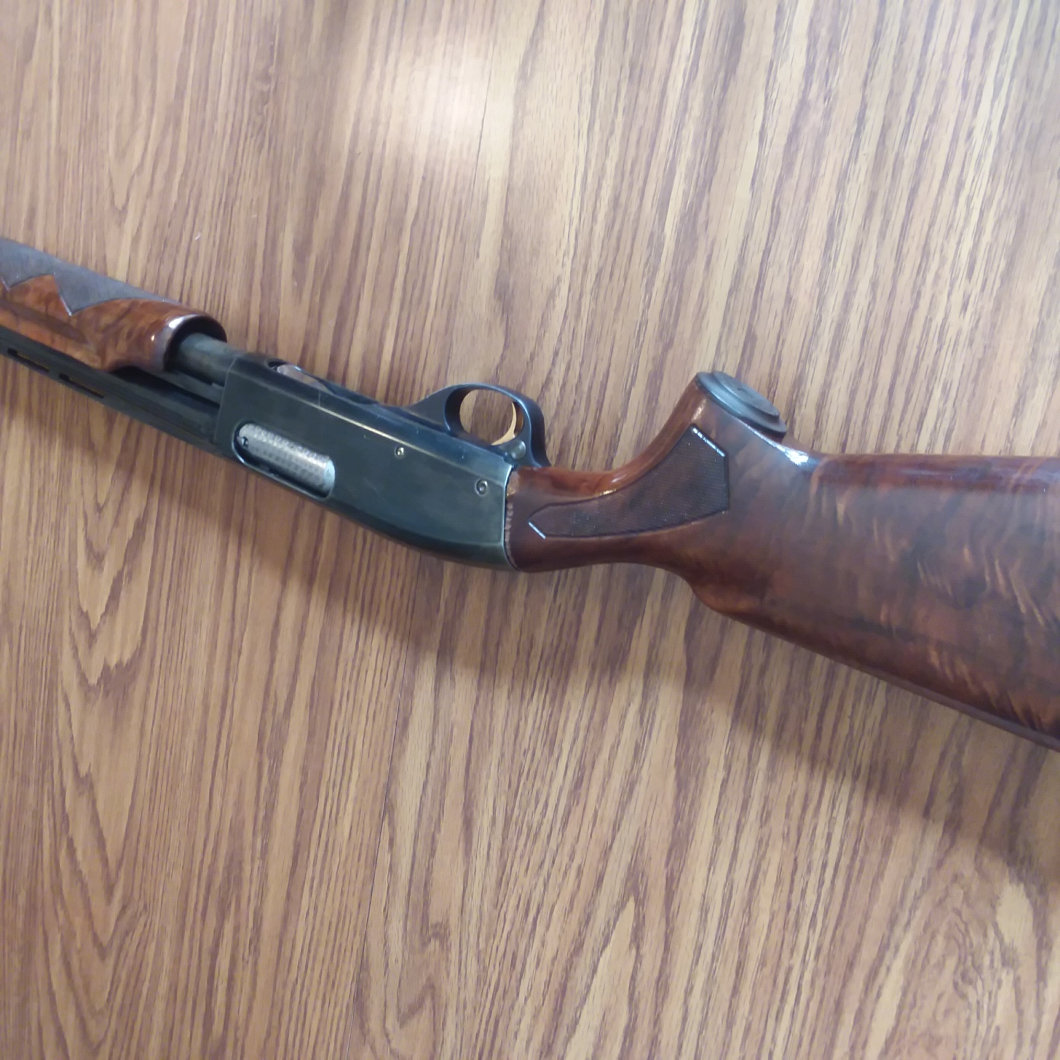

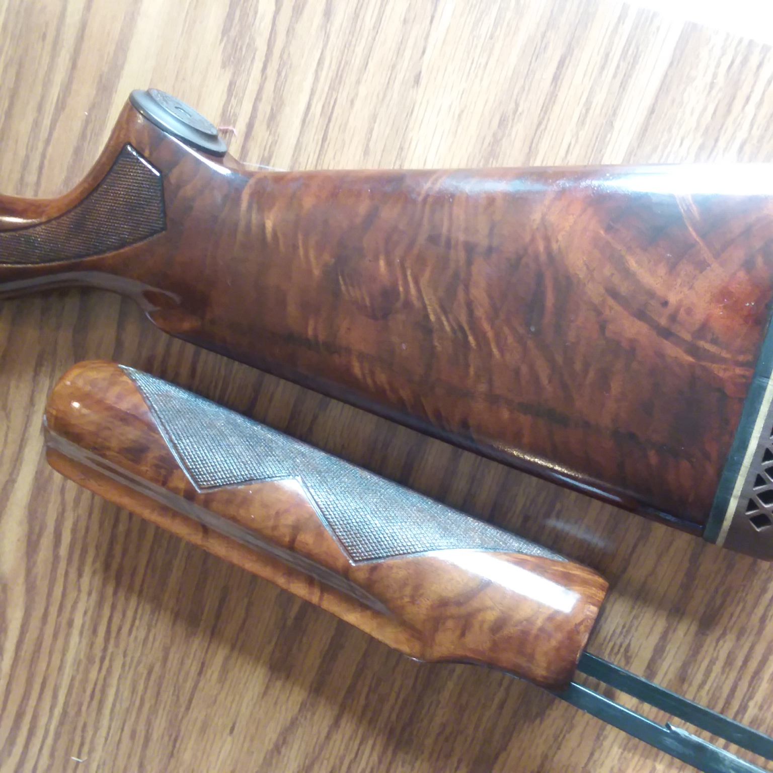

It would probably be worth more with its original "Sun Grain" wood. Looks like someone stuck some TB wood on it which doesn't seem to fit up to the receiver very well. Probably been over sanded.

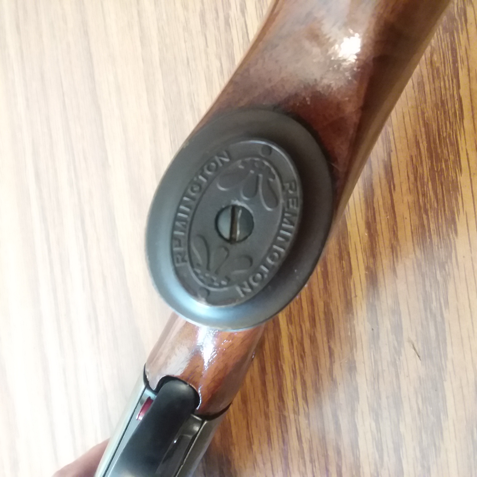

The stock has a Pachmair pad on it, too. Not well fitted to the stock. And stock bolt not very snug. Perhaps looseness led to damage. With trap high comb it is of little use to me. Probably sell off the lumber. Can be made 100% serviceable and solid with some epoxy. Tinted brown it wouldnt even be very ugly.

And that is what happens when you install a wood stock on a Remington repeater WITHOUT installing the stock bearing plate.

That was my suspicion whennI saw the damage. But the plate was in there (maybe not always in there though). Also, the wood that contacts the plate usually has "870" stamped on it. This one does not. So another possibility us that someone adapted a pre-bearing plate stock to use the plate but took off too much wood to make room for the plate.

Compared the end where it meet receiver with another stock. Sure enough someone shaved the end of the wood such that the bearing plate gave no support. Unfortunate mistake.

Do all trap barrels have a higher rib, or were some the same height as a field barrel? This gun has higher comb but when I mount the gun I'm seeing the top plane of the rib. Could be a replacement field barrel, I have no idea.
Also, I'm measuring 3/8" less drop at the heel than 870TX literature specifies, as measured from table to heel with shotgun resting on the rib. A taller, steeper rib would increase measured drop at the heel.
Also understand this stock is jacked up where it meets the receiver so stock could be completely out of original alignment.
As I'm preparing to bed the wrist to the receiver, I need to get it right. The up-side is I am also now able to bed it with a little cast (as much as the stock bolt and offset-drilled washer permits). I've always been an off-the-shelf guy so fitting a stock is all new to me.
