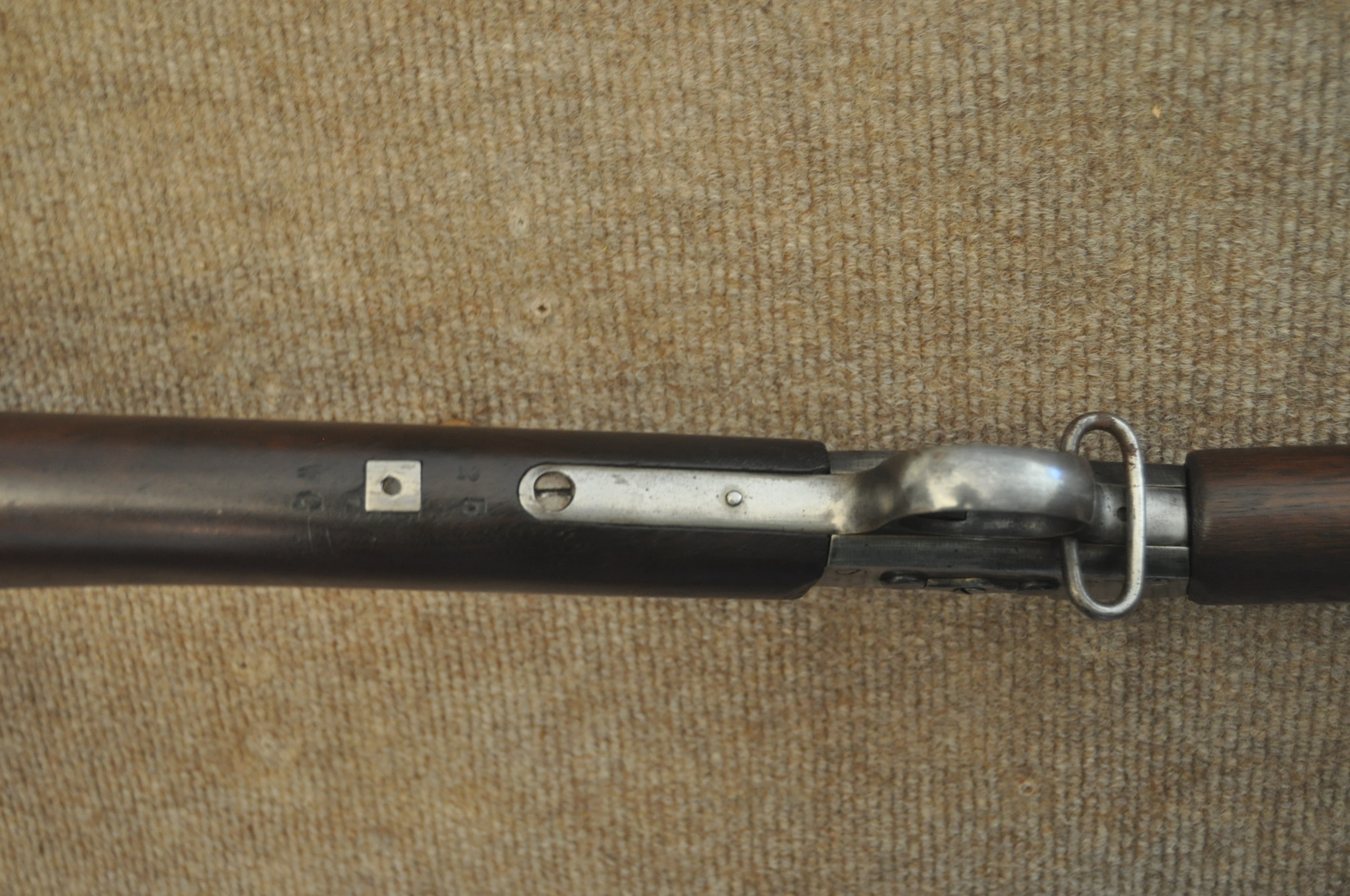

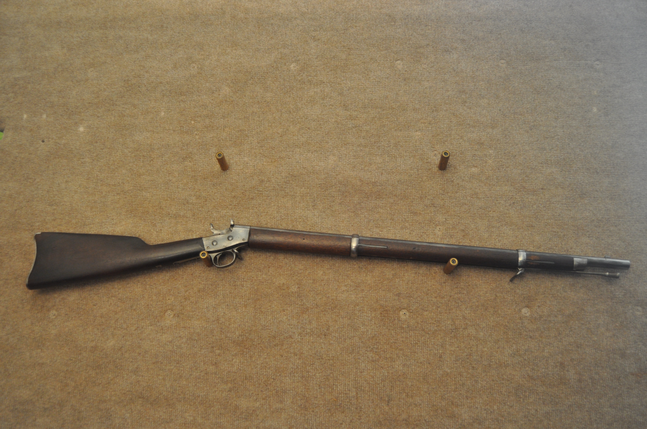

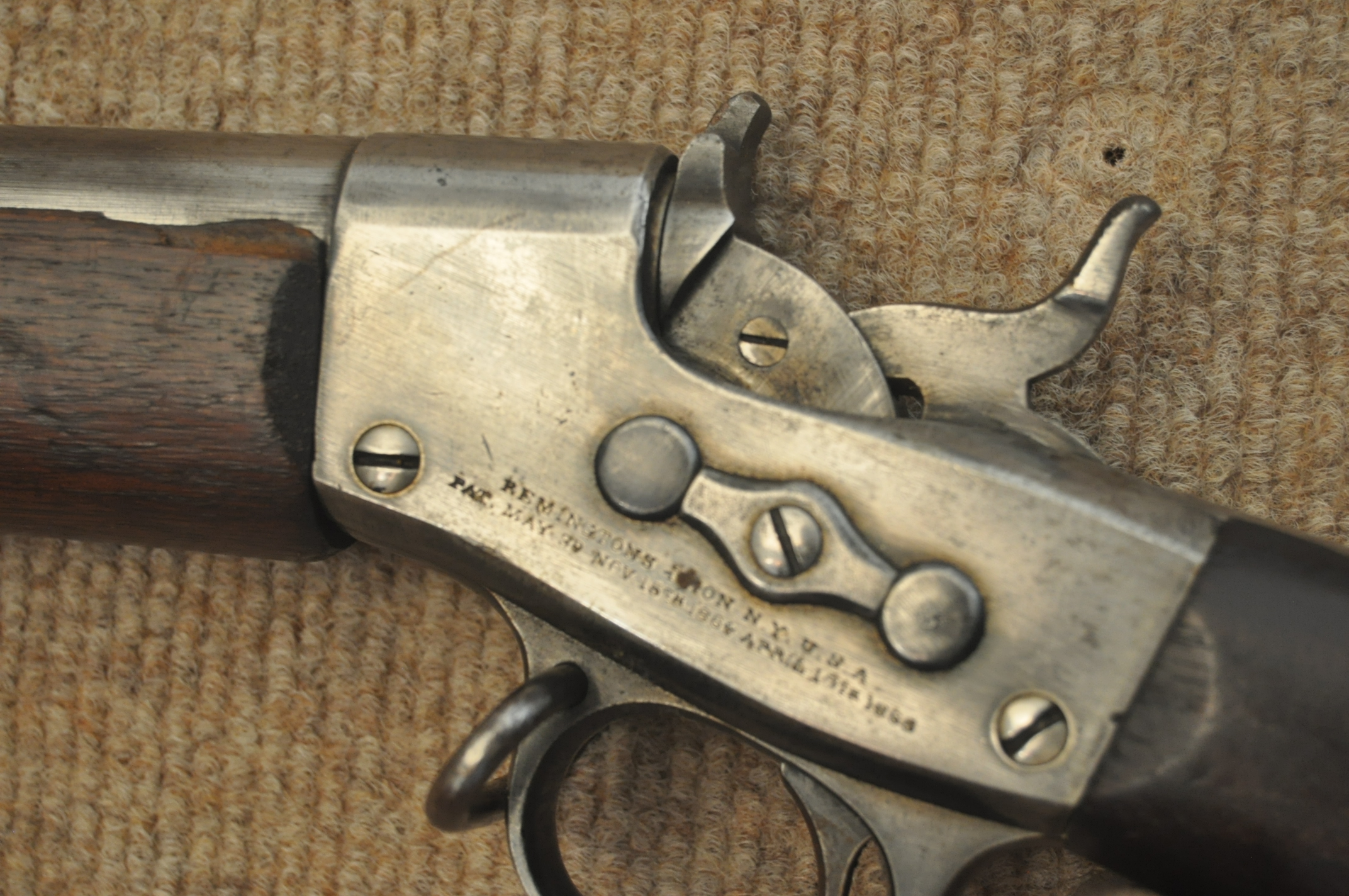

Hello I have spent hours trying to find another similar gun in order to identify what we have here.
I have not been able to find another example with the patent info on the receiver like this one.
The receiver looks exactly like the U.S. Remington Model 1867 Navy Rolling Block pistol.
I hope someone on this board has seen one.
Can anyone out there help me identify this gun?
Thanks.

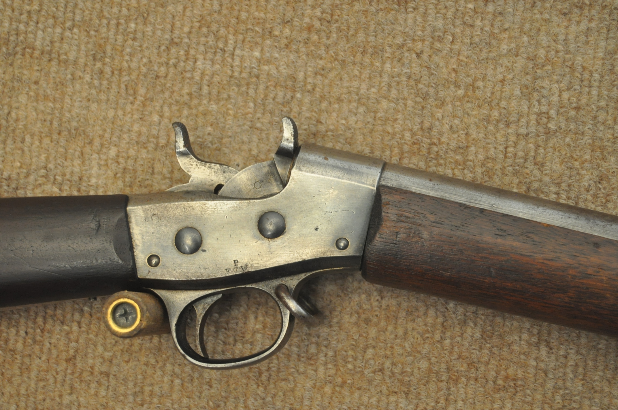

They made some of the cadet rifles with rear sights and some with out rear sight. Here is a photo of my cadet rifle with the rear sight that I had on display at a gun show in 2012.
cadet rifle made from 1870 pistol - copy.jpg (401.41 KiB) Viewed 3284 times
