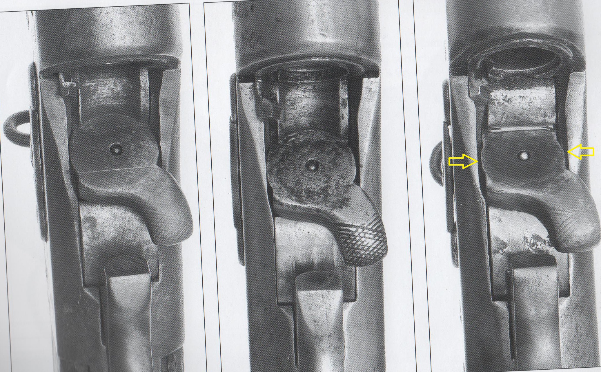

Thanks for the pic but I guess I didn't explain well enough.
I wanted to see the face of the breech block and not the
breech of the barrel. I have included a pic from the George
Layman book on military rolling blocks showing the three
type 1 rolling block actions. I inserted "arrows" to point out
the "ears."
Type 1 Actions.jpg (1.22 MiB) Viewed 8958 times
Good Luck!

Hi There,
Thanks for the pic. As you can see, yours doesn't have the
"ears" (like the ones I posted). I also notice your hammer
has the shield type hammer knurling. This was the type of
knurling used on the New York State Militia contract.
Good Luck!
