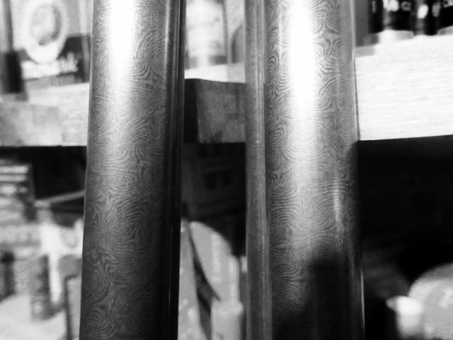

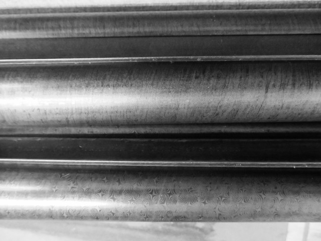

I believe that I have my damascus refinishing program in order. I found a couple of good+ 1900 (12 & 16) to "practice" on. I got several complements from my very experienced gunsmith as he reassembled the guns!
I think that my electrolysis cleaning really helps prepare the metal for rusting, it sure cleans all the action parts. There is a lot of information on the web, sorting through is the key.
In the end I have bright contrast that looks very natural.

I am not too good on photos, twist steel hammer lifter project, real early LC Smith/Baker (1872)
other photo 16 gauge, 12 gauge 1900's

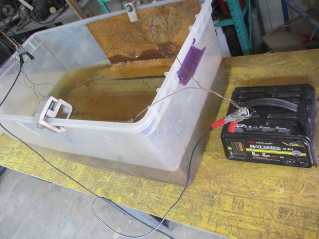

Electrolysis Cleaning:
The first thing I like to do is a super cleaning of all metal. I have restored twist and damascus to a nice/natural patina by just cleaning off the century of greasy grime. The process releases rust and any foreign matter. I started electrolysis cleaning on collectable cast iron cookware. This is a twist 1878 that was very black before the process.
Your need a plastic tote big enough for your project, they must be covered by the water. You need 1-2 table spoons of Arm and Hammer washing soda per gallon of water. Connect a MANUAL 12 volt battery charger--positive to your anode (scrap iron) and the negative to your barrel or metal can with parts.
I like to start with fairly warm water as it get working quicker, after a few hours I add a pot of hot water to the tote.
Over night is usually enough time. I take the barrel out of the tote and lightly card off with warm soapy water and medium steel wool or green scratchy pad. Instant results, you can see patterns that had been lost under the grime. I wire brush the heck out of the bores at this time--you will be surprised at how the rust disappears. You will see bubbles as the charging works, keep your paws out of the water! The rust will be floating after a bit.
This is the cleaning I do before starting the rust process for damascus restoration.
