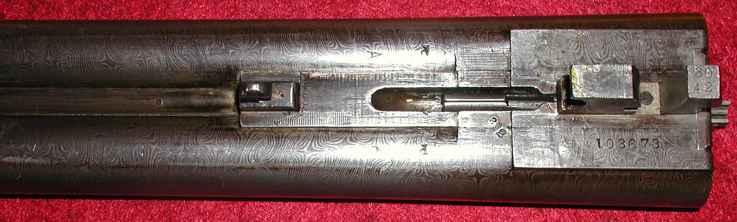

The anchor has been used as an inspector's mark by employees at Ilion for eons. We find it on old Remington Arms Co. doubles, and on pumps and autoloaders made by Remington Arms - Union Metallic Cartridge Co. and Remington Arms Co., Inc. My Father's Remington AE-Grade of about 1895 or 6 vintage has the A and P on the bottom of the barrels.
103673 01 12-gauge, 30-inch, AE-Grade.JPG (317.85 KiB) Viewed 5121 times
While very likely, no one left alive really knows what all the various marks on these old Remington Doubles mean, my working theory is that the A represents the grade of the gun and the P refers to either the type or the source of the rough tubes from which the barrels were made.

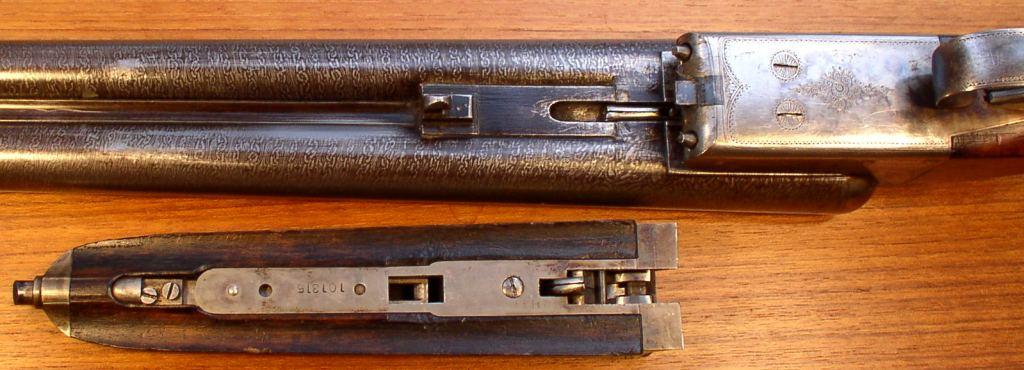

My BE-Grade of 1895 vintage has B, E and J on the barrels which are of the pattern that the Remington salesman's Damascus sample calls "Chain J" --
101315 BE-Grade inside Forearm.jpg (84.81 KiB) Viewed 4931 times

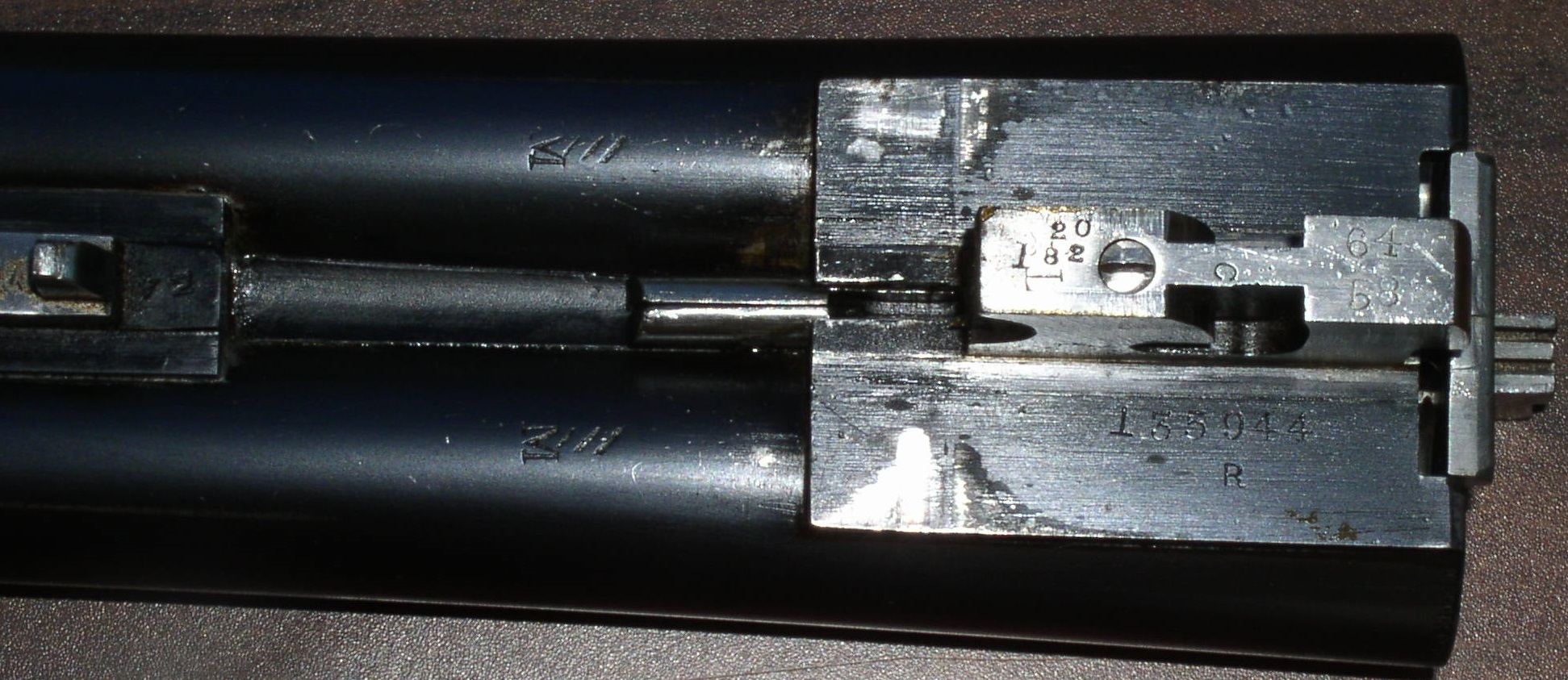

so that is where I get the idea that one of the letters may refer to the barrel material. One of my Ordnance Steel barrel guns has only /// M on the bottom of the barrels --
P135944 03.JPG (500.33 KiB) Viewed 4931 times

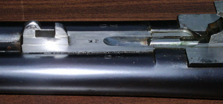

and a 16-gauge just has XO --
P132280 17 Forearm Loop Mid-Period 02.jpg (67.74 KiB) Viewed 4931 times
